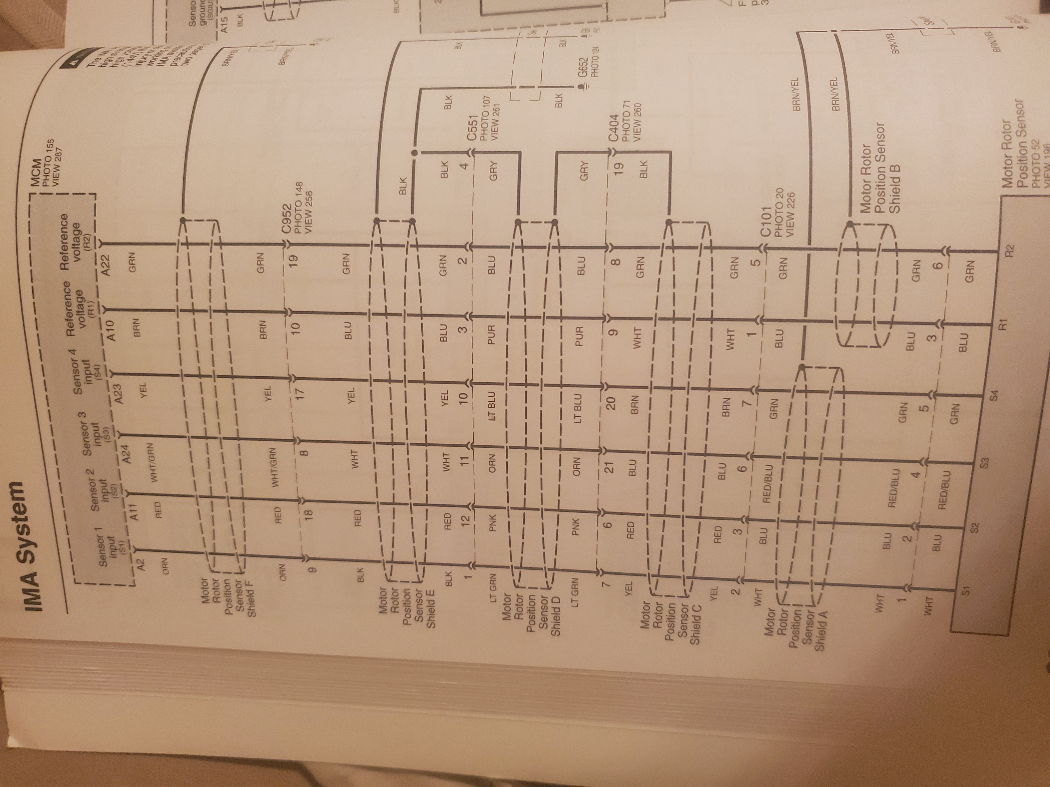

Is there a straight forward way to figure out the sin cos windings of a resolver? I have the factory electronic diagnostic manual for the honda accord hybrid ima. I know the resolver excite wires and know what wires are a pair for the sensors Just dont know how to find out which pair is sin and which other pair is cos. The manual doesnt list them as sin or cosin.

Just connect it either way. Then, if the motor doesn't spin either swap it or set the according pinswap bit to swap it in software.

You have 4 combinations for two pairs of sin/cos windings and determining the correct connection.
for example: 1-2 _3-4; 1-2 _4-3; 2-1 _3-4; 2-1 _4-3.
The connection of the signal windings of the generator has no polarity, the winding has the lowest resistance of ohms.
