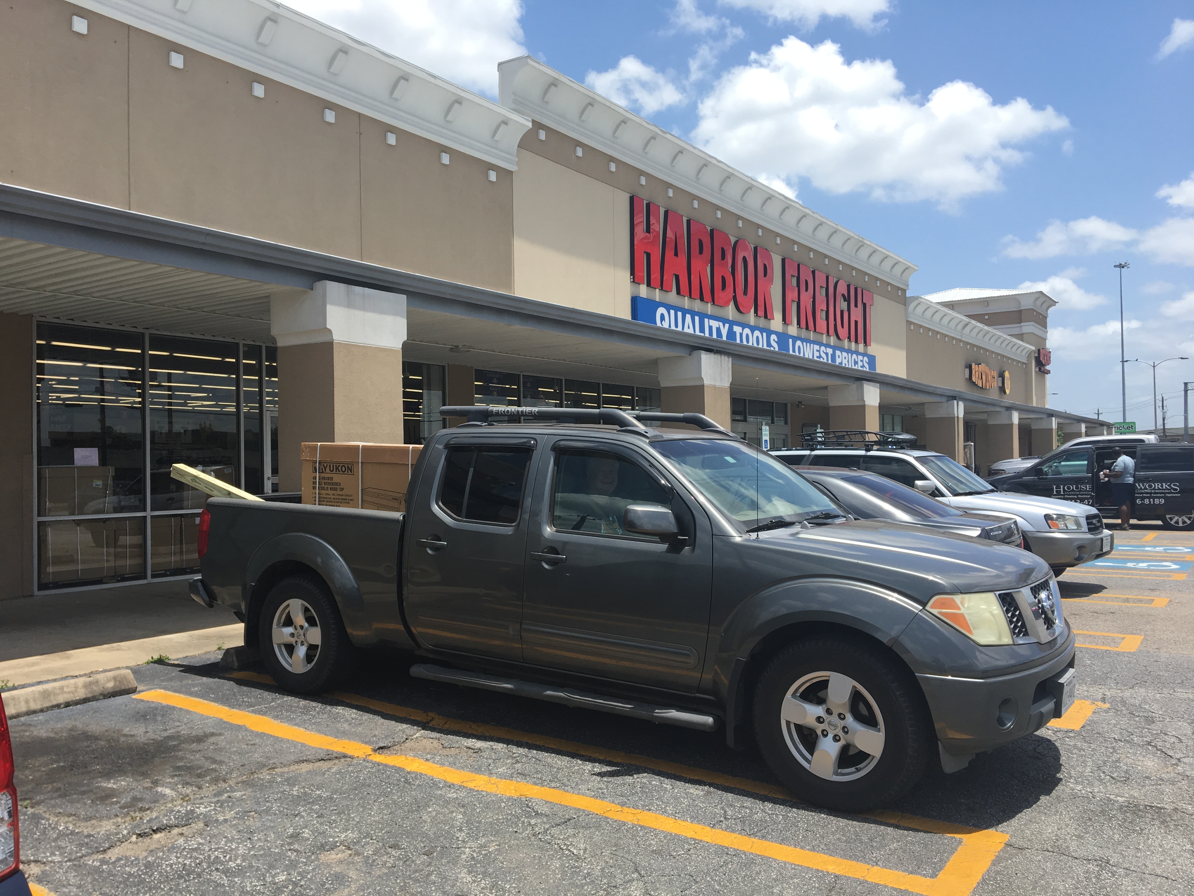

To boldly go where no one has gone before! Hey Guys, I have finally decided to get off my butt and start this project. I bought this 2007 Nissan Frontier 4 door 6ft bed truck for a good deal a few years ago with the intention of converting it. The engine didn't run very well, but I wound up figuring out the problem and driving it as my weekend toy hauler and Home improvement material getter.
With all the new electric trucks and SUVs coming on the market, I want to be different and have fun blowing minds with this project. After watching SuperFastMatt's Jaguar build on youtube, it gave me a lot of confidence and excitement to pursue my dream of converting a larger vehicle with modern components. The goal is an easy 100 miles per charge / drop dead range around 150. Quick and fun, but reliable. I don't plan on performing any serious towing.

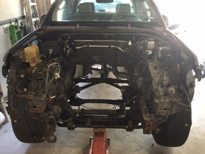

I decided to focus on the front motor first to ensure I actually make this AWD.
Original 2WD front hub. Installed new Frontier 4WD front hubs. The Frontier front axle vs the Nissan Leaf axle. They use the same spline! If only I could fit the Leaf motor in the front. Let's try it. Maybe if I angle it up to clear the crossmember and power steering rack. This is not going to work. It would have to be vertical with the motor on top of the axles to clear everything. If I did that, I don't think the gearbox oil cooling would work. I really need a drive unit with the axle line ahead of the motor. Of course it should be compact, powerful, and aesthetically pleasing too. Hum, what would work here.
Re: The Final Frontier - AWD Nissan Truck
I actually tried the Leaf motor, gearbox, and axle hanging vertical before I came to my senses.
