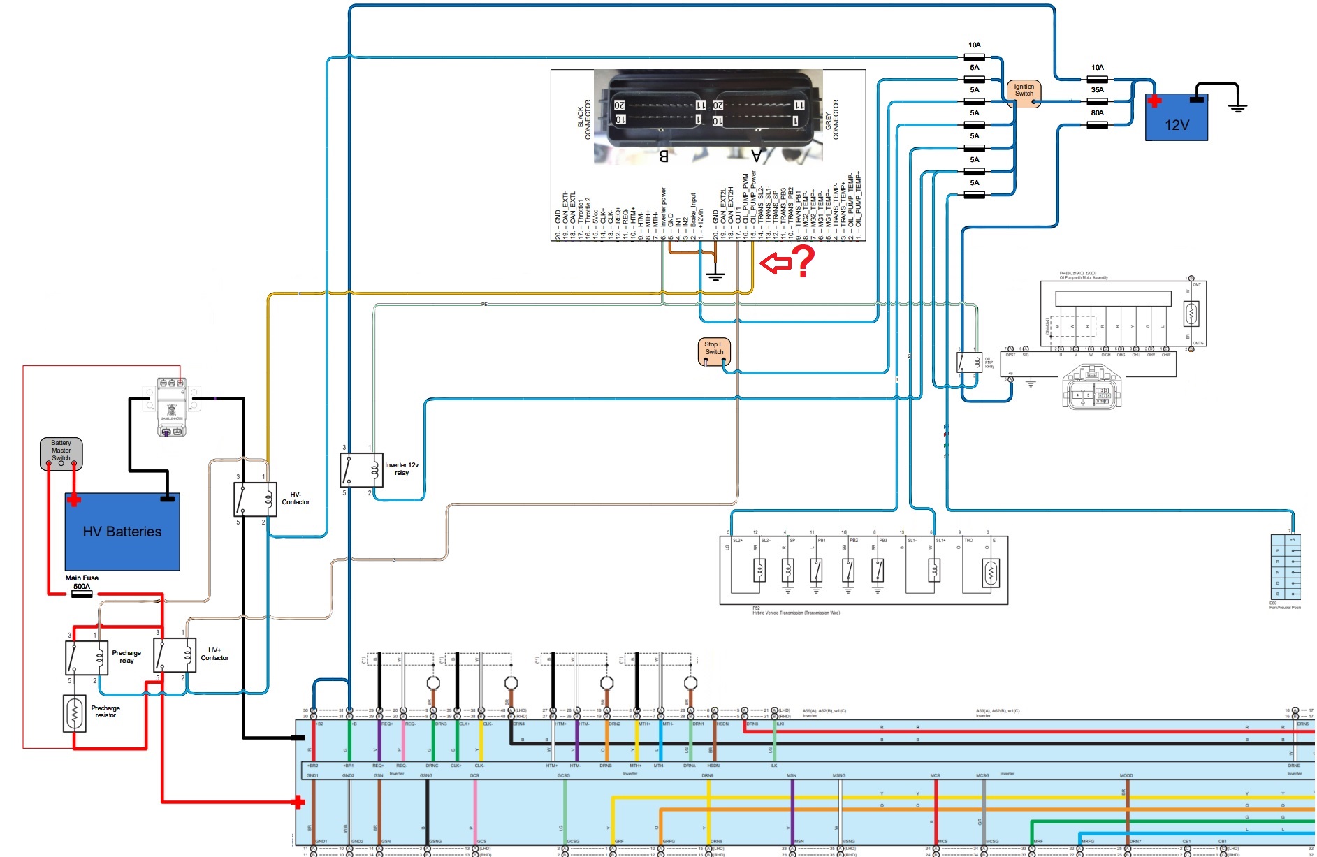

Robbertjanzen wrote: Fri Jun 05, 2020 2:09 pm
Kevin Sharpe wrote: Wed Jun 03, 2020 7:57 pm
Robbertjanzen wrote: Wed May 13, 2020 6:37 pm I have updated the drawing after some remarks and updates found in the software.
Can you add this wiring diagram to the GS450H wiki? I don't think Damien has seen it listening to comments in his latest video.
Yes ofcourse!
Please find the latest version 2.4
Also the Download link to Visio file:
https://www.dropbox.com/s/e42971nsftjav ... .vsdx?dl=0
Robert et al thank you so much for doing this, I know I am only 2 years late but is this the final version of this diagram. I realize the VCU has gone through a number or reiterations
I have Ver 2 and a question or two regarding pin #15 on the A Gray connector (forgive me if it has been addressed already or if I'm just being a fool) labeled as OIL PUMP Power would it make more sense if it was labeled something like "Pre-Charge"? as I don't see it going to the oil pump relay at all, Pin #6 from the B Connector does though? So I am confused
also I took the liberty of sanitizing your diagram to isolate just the "ignition" and pre-charge circuits, mea culpa
Controller_V2_Pinout.pdf
(275.73 KiB) Downloaded 1064 times

Gregski wrote: Sun Jan 30, 2022 7:22 pm
Yes ofcourse!
Oil Pump Power is what it was in the earlier versions of the software, so people have just left it named the same. In reality, it's a general purpose 12v output, so you can call it and use it for whatever you want.
