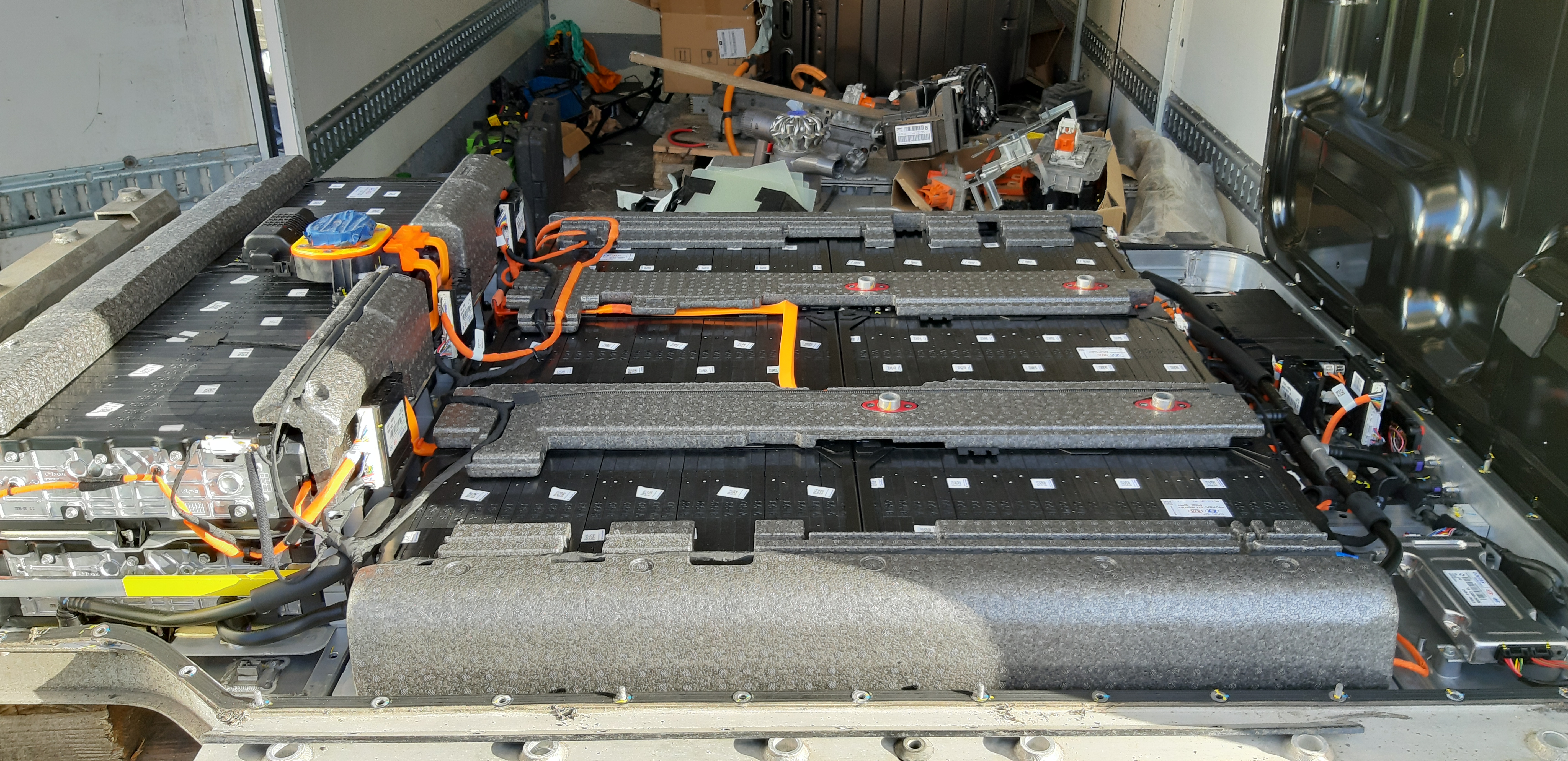

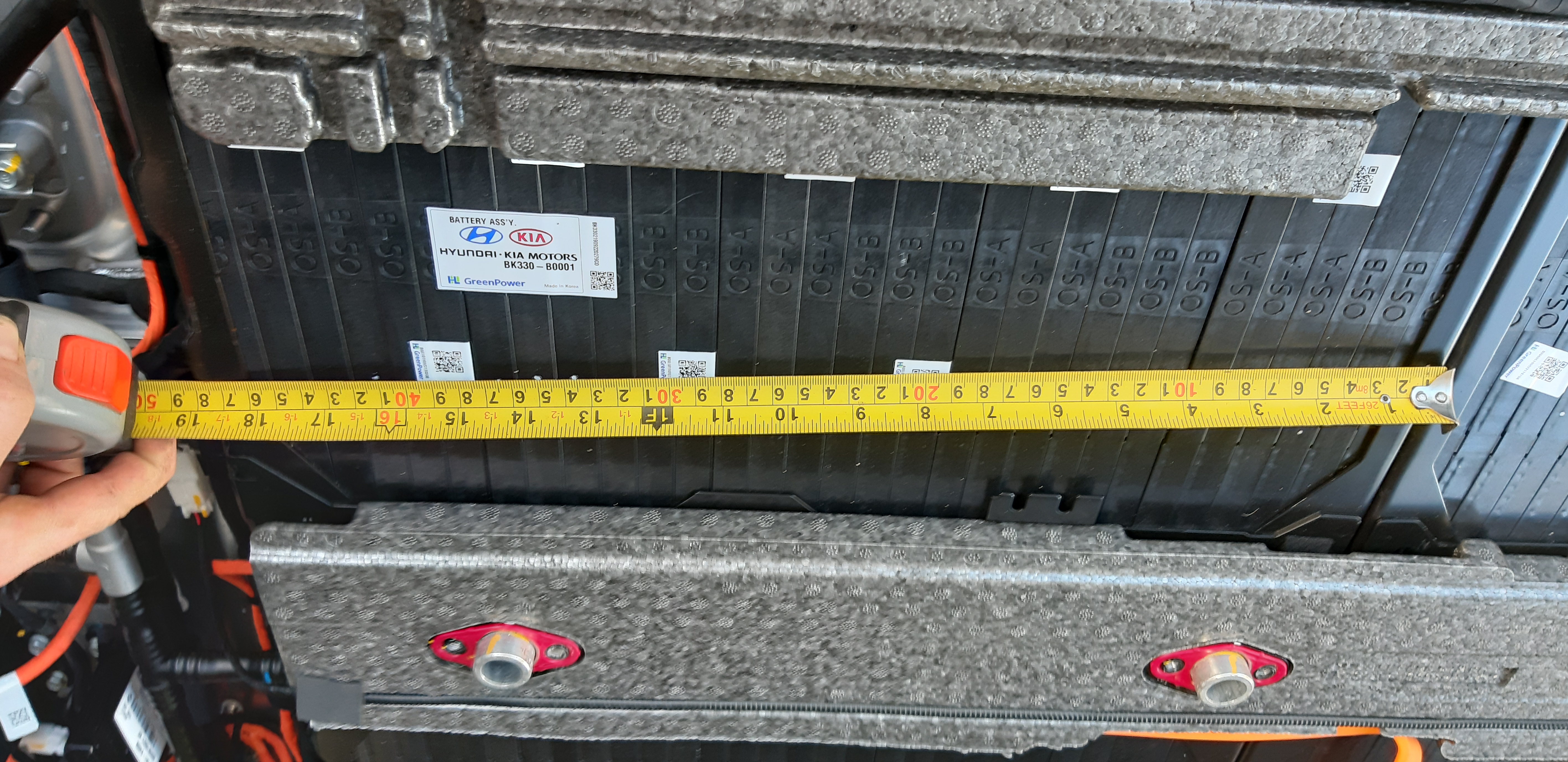

Your in luck I'm hoping to use one and just opened the pack

Awesome, so the measurements you gave me here are the ones of an array of cells? How many cells are in there? Whats the voltage of that array? Send like there is a block metal frame around it?

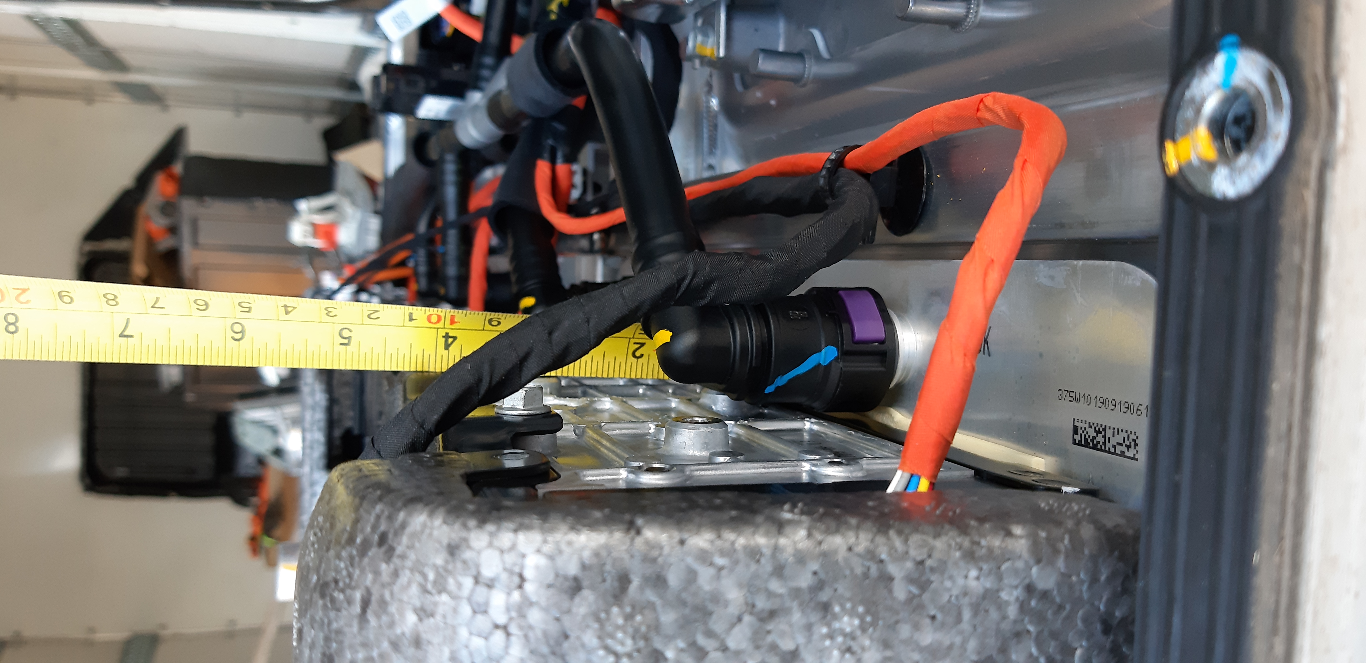

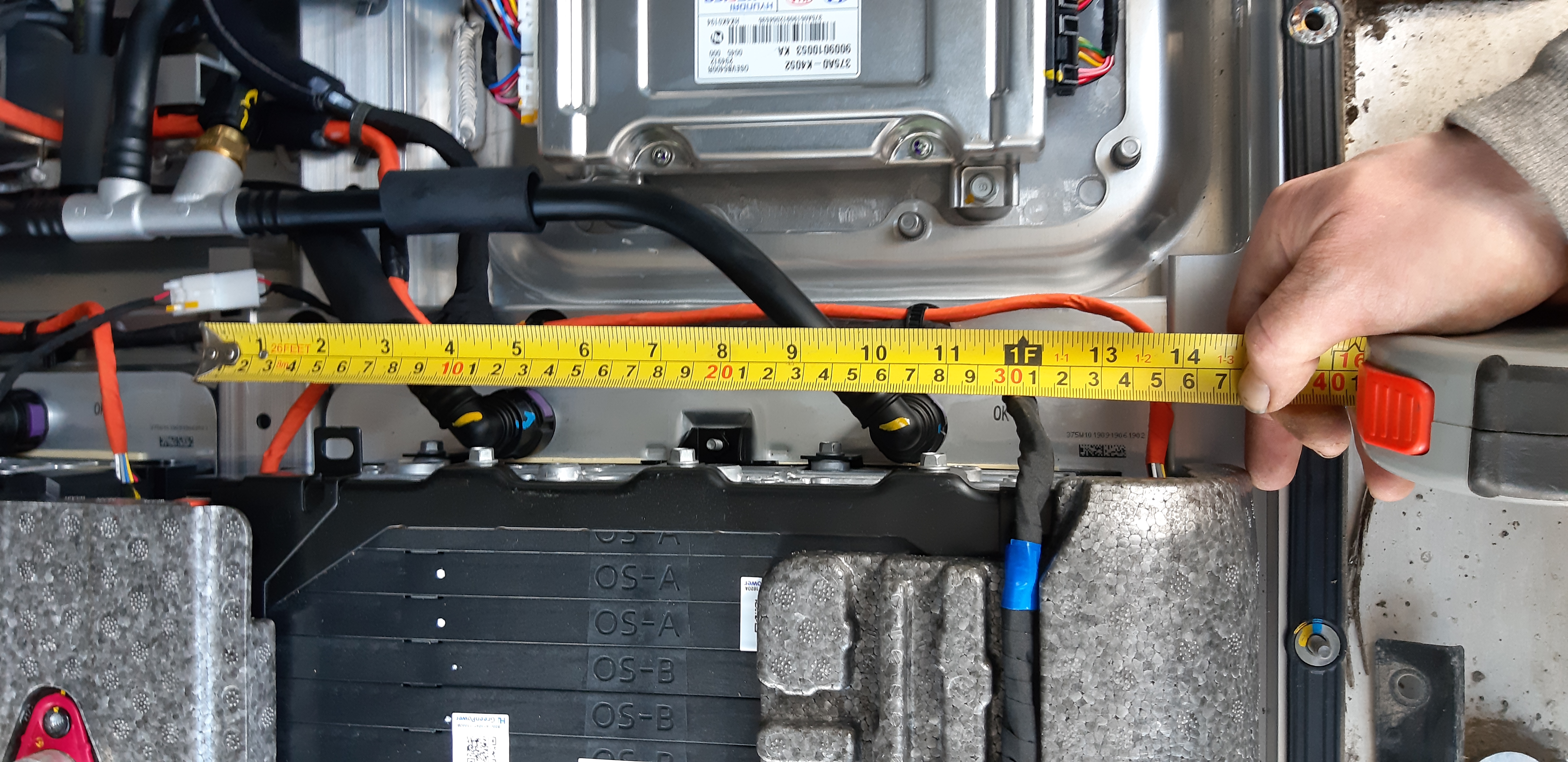

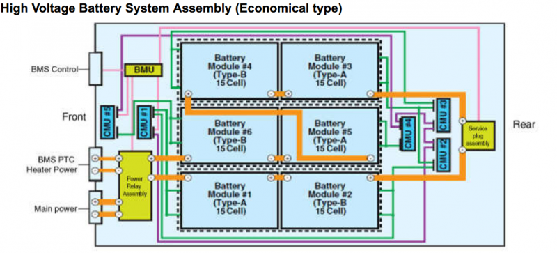

The length of the 10S3P and 15S2P modules is 480 mm (+15 mm mounting lugs), while the length of the 9S3P modules is 430 mm (+15 mm here as well). The modules are 105 mm high (+10 mm extra) and 360 mm wide.
There is a 39 kWh "Economy" version from Hyundai Kona Electric, which contains 180 cells in a 90S2P configuration, ie there are two of the above cells in parallel - its nominal voltage is 330V, its operating range is 225 ÷ 387V, while the "Standard" version is already Contains 294 cells in a 98S3P configuration, i.e., the cells are connected in parallel with a triple; its nominal voltage is 360V, its operating range is 245 ÷ 421.4V.

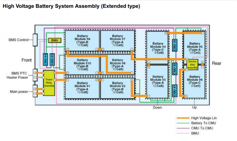

So there are the different modules in the pack?
10S3P
15S2P
9S3P
How is that possible, i thought they all would be the same? How do they make sure energy draw is the same for every cell if the arrays are different?
Many thanks for your knowledge

Based on the photos, you'll understand.

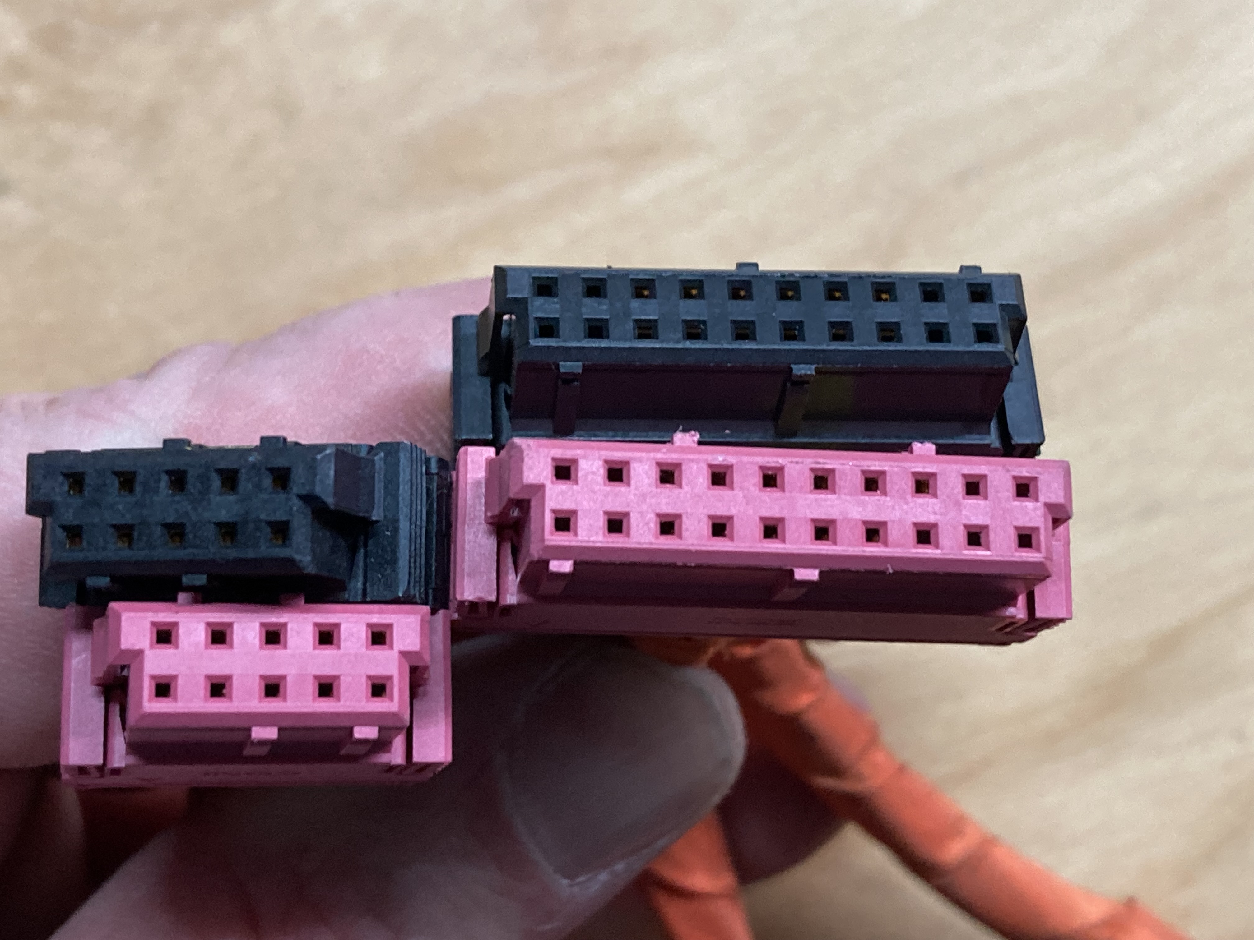

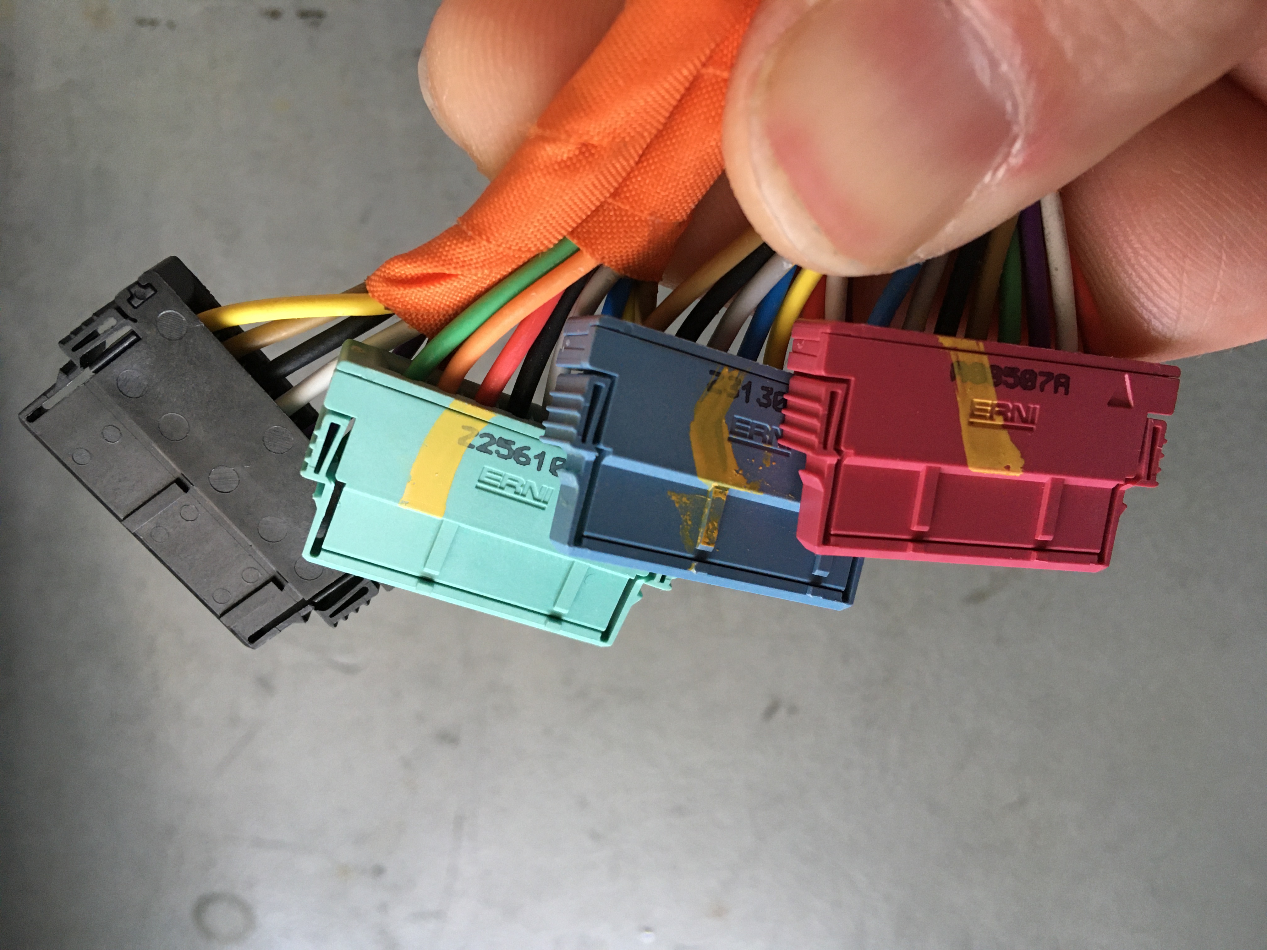

Do you also have a picture of the cell connectors?
Is cell monitoring a master/slave design or do all 98 positive connectors go to three BMS directly?

The three types of battery modules have a total of eight (!) different connectors. Their illogical connection is a nightmare. The MAX17845 chip built into CMUs is top secret, with no datasheet, not a programming manual. And it uses an isoSPI bus anyway, not a CAN bus.

Kutato72 wrote: Wed Mar 16, 2022 8:46 pm There is a 39 kWh "Economy" version from Hyundai Kona Electric, which contains 180 cells in a 90S2P configuration, ie there are two of the above cells in parallel - its nominal voltage is 330V, its operating range is 225 ÷ 387V, while the "Standard" version is already Contains 294 cells in a 98S3P configuration, i.e., the cells are connected in parallel with a triple; its nominal voltage is 360V, its operating range is 245 ÷ 421.4V.
Hi, are you saying 39 kwh Kona battery is using same cells as the 64 kwh battery but 90s instead of 96s and in 2P configuration instead of 3P? I wonder if 6s2P block can be added to make it 96s? Are they normal Li-ion as it says Li-ion Polymer on the pack? 🙂
