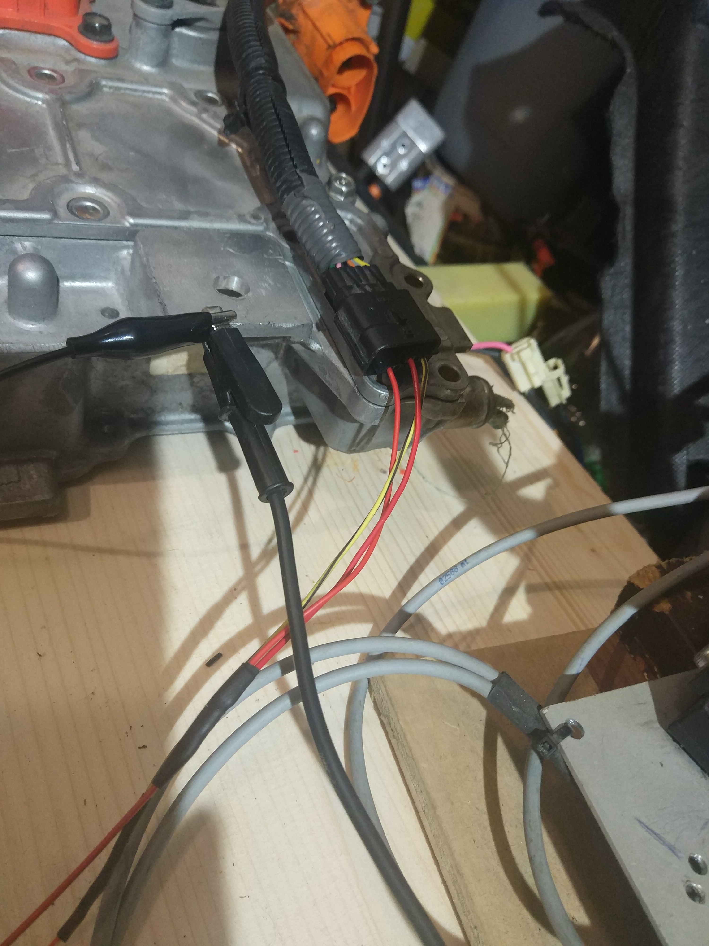

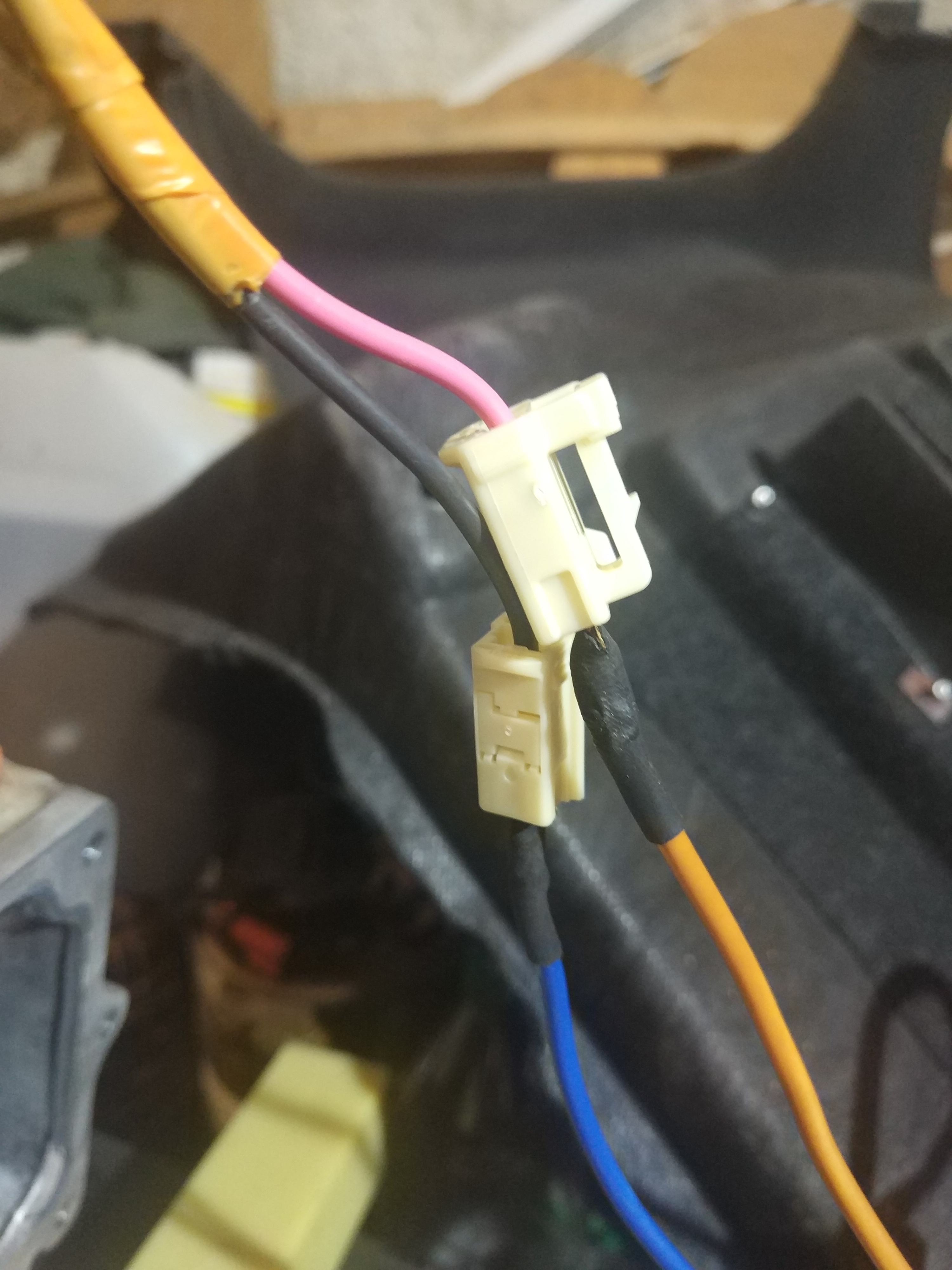

I am not sure if this was already documented here somewhere. If so please consider this only a documented "how to" from me...
A friend lent me a HV contact box out of Nissan Leaf Gen1. He said i should try confirming if it works by simple DIY means. When i googled around in true engineering spirit i noticed this particular DCDC is documented on various sites and videos, however not with schematics or wiring diagrams...
I used some photos and wiring from here: http://myimiev.com/forum/viewtopic.php?t=4533
Starting with connection of the 12v positive terminal to battery
And then GND the case back to battery negative terminal
I connected HV directly to DCDC input wires. Then referring to plugs F11 & F12
Terminal 3 and 11 would need +12v for Battery power supply
Pin 1 needs a PWM signal 9Hz 50% duty to it Well it was all good and well with the wiring obtained online, however i noticed that DCDC starts as soon as i provide 12V to pins 3 and 11 of connector and provides 14V power to charge 12V battery.
When i added 9Hz PWM to pin 1 of connector F11 i got following result:
PWM voltage
80% 13,10V
70% 13,40V
60% 13,70V
50% 14,00V
40% 14,30V
30% 14,70V
20% 15,00V
If i remove PWM from pin 1 i again get 14V on DCDC output. Also i tested the output with 14V 85A load (9x H4 light bulbs and 60Ah Pb battery) and DCDC provided true and steady 14V power.
