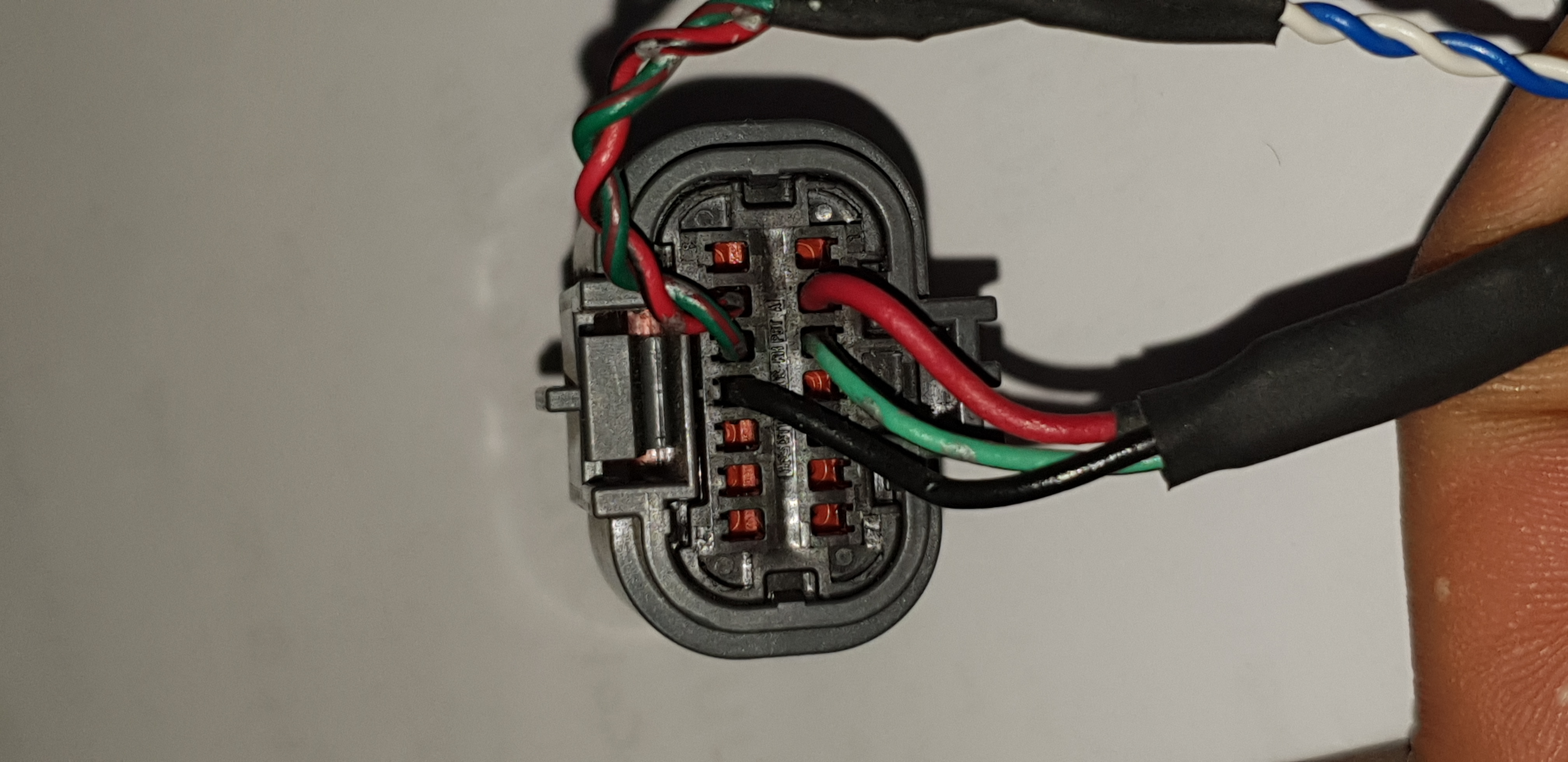

Hi all, just tearing down the inverter to get at the vehicle wiring (fortunately I have a loom for the resolver) and I am presented with a question!
This is the back of the grey connector (view from inside the inverter) and the pinouts from the manual.......As you can see they are different as pins 1-7 and 8-14 are upside down and back to front. The pin numbers dont worry me as all I am interested in doing is identifying the wire colours for CAN L, CAN H, IGCT, and RSDN. I can say with some certainty that white appears to be GND.
So, is CAN H Green or purple?
Is IGCT Orange or Blue?

I see this on the other side. This is OEM connector.
It seems the sketch was made from the front side of connector. Black is GND and IGCT is ignition (red), RSDN is shutoff (light green). CANL is green red and CANH is red black.
It seems like internal connector CAN wires are black and green yes. White is GND. Yellow is RSDN and blue is ignition.
