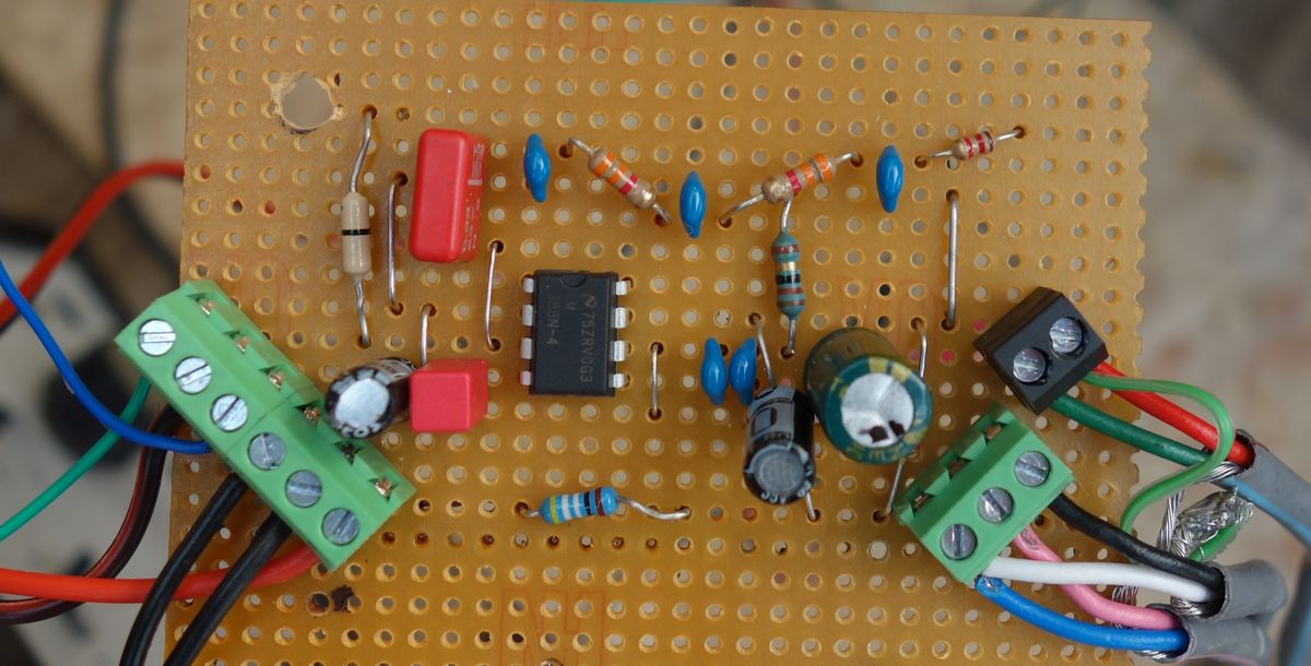

My small interface looks like on picture. On new design I see, that are 3 ARC input and 3 output connectors. Like You see I have 6, because I think it is easier to connect directly 6 wires from resolver from one side and put them (rest) thru board. What do You think?

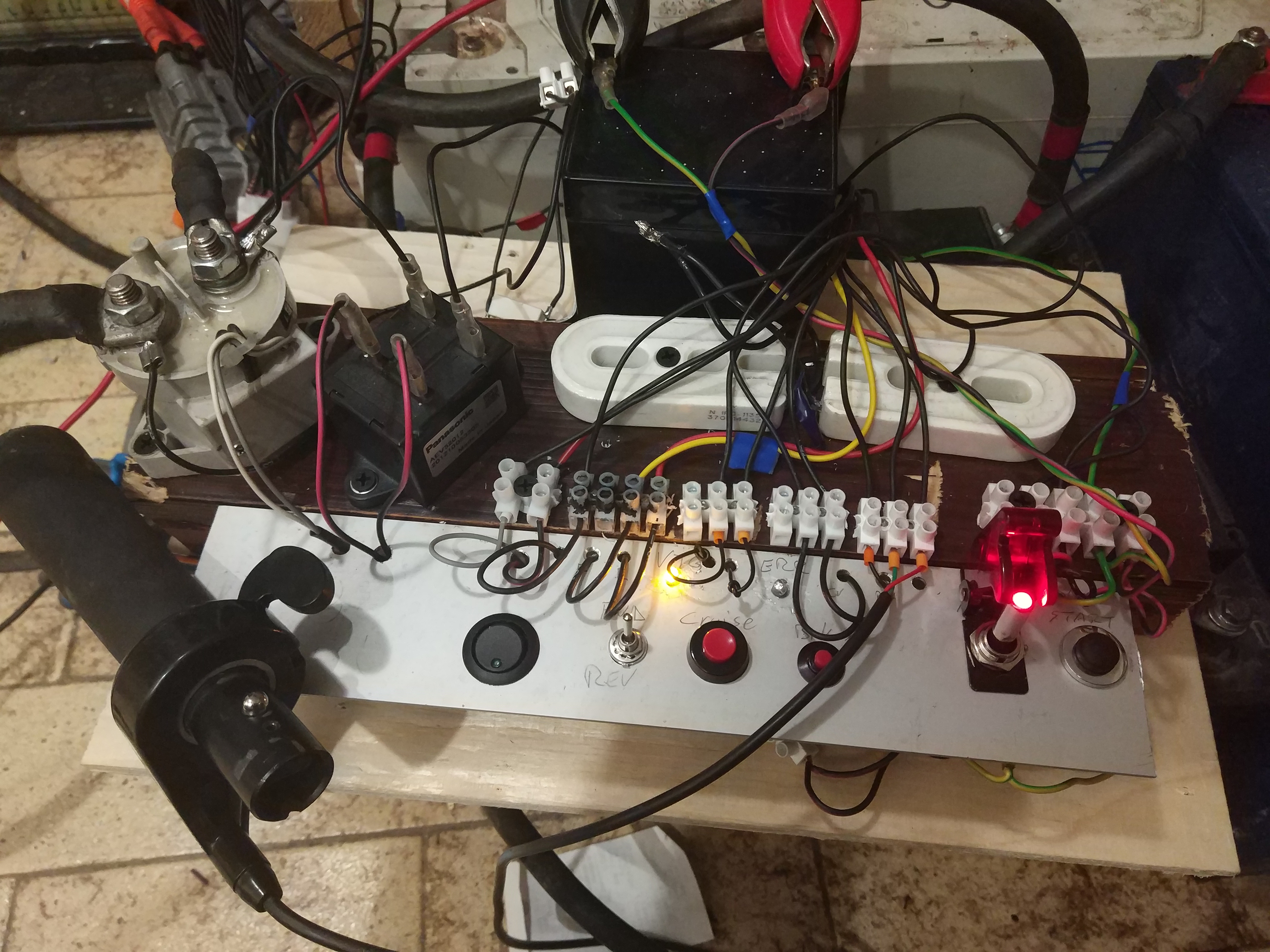

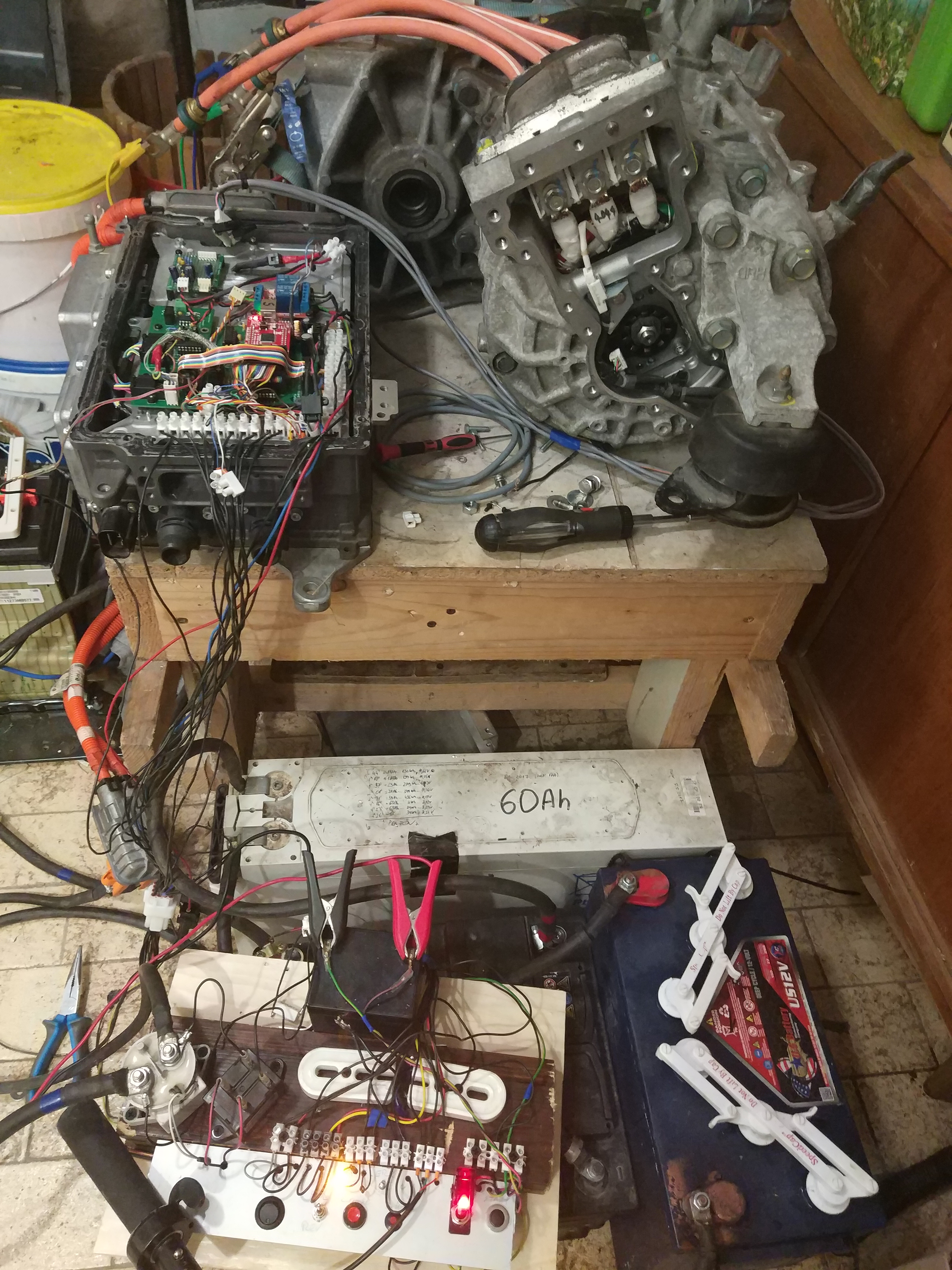

I have assembled a universal driving station, so i can connect any inverter i have built and test it outside a car. Providing i can connect it to my type of connector.
I have tried to run Leaf motor with it.
1. When i connected new Ampera inverter i had some trouble with connecting 5V to resolver. I replaced high resistor 220R with 510R so i get 1.55V. Is that enough to work? I can replace it with 470R if you think it absolutely needs 1.65V.
2. I setup parameters like you sent me, with exception of voltage and current sensors gain. I have it at 4pole pair motor and 4pole pair resolver.
Boost is at 7000 since i have 50Vdc. Is that correct?
3. When i ran it first i received a start for a eight of a turn and then it wouldnt turn anymore. I tried to move rotor with a tool and it jumped by 1/8th again.
It remained unmoved regardless of offset setting. I tried to set it by 1000pt.
Interestingly i observed wires when applying throttle. Two of the phase wires were moving and heating up but third not.... It didnt even show current flow.
Then i took a small 3ph motor and run it manually and it turned good at 1hz or 10hz...
What is happening here?
tnx

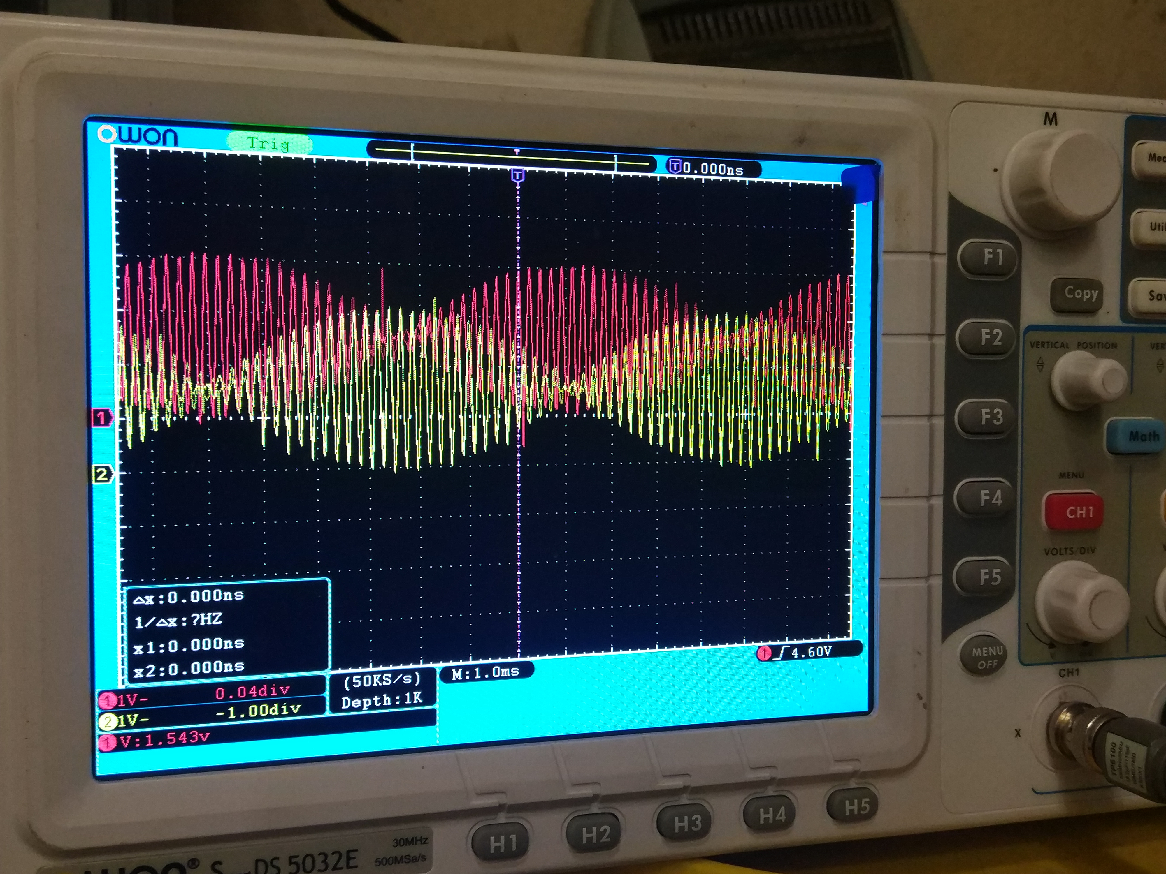

I will now rotate motor with one ebike sensorless controller and observe S3 and S4 on scope. Can you send me a photo of what I should see if resolver is working good?
DOH! I don't get any sine or cos from the board when rotor is turning. Both S1 and S2 give 1.3V on scope but R1/R2 do not show any excitation. Does that mean LM chip is bad?
UPDATE:
I had to rebuild resolver board. Now I get square pulses on enc Z. I get sine weave on R1 and I get sine cos response from S lines to enc A and B. However motor won't budge and two cables keep heating up.
I connected the scope and rotated motor by ebike inverter. All this from 48V. I can see sine cos response but it's quite covered by hash. When I reach 200rpm a bulge forms on the scope. Is that good?

Re: Resolver Excitation with V2 mainboard
Its alive!
I installed the latest firmware rev 4.12R and it meant worlds!
It turns out it is very important how the phases are connected. I went through couple variations. I even had to change wires on resolver cos to get rotation. But finally motor spun at 600rpm.
Well it spun also at 300rpm etc... it all depended on how i setup fweak. It seems fweak with udcnom will adapt max voltage and motor will spin up faster if i vary them. Tomorrow i will try with 360Vdc. But i have to make some 16mm2 cables because my test cables are in poor condition
Attached is parameters file for the latest and best option. My motor seems to have an offset at 26000. I got it down to 1000. Johannes can you let me know how to pinpoint the offset more precisely?
Also attached some photos of signal from resolver.
Did you connect shield on all cables together and then to GND? I still havent, i think i will have to do that for 360Vdc test.
Next tests to be done:
1. testing of Forward - Reverse function
2. Testing of Cruise mode
3. Test at 360Vdc with same settings save boost
4. Test of max RPM with 360Vdc
5. Put inverter back in a car and drive
A
- Posts: 3660
- Has thanked: 145 times
- Been thanked: 369 times
Well i ve done it! Leaf is turning at 360Vdc and behaving at that. I had some problems with boost. Your setting of 400 is not enough. I used 1600 and this gets the motor turning. BUT it is not absolutely smooth at high speed. I can hear some rattle in there. How do you think i could better determine offset? I can get motor running from 24000 to 32000.
Should i measure phase currents?
I have tested:
1. Testing of Cruise mode works.
2. Test at 360Vdc with same settings save boost, works very good. I will keep settings.
3. Test of max RPM with 360Vdc. I got to 5000 RPM indicated at 360V nominal with freq 600Hz and weakening at 800Hz. Reading moves a lot at high speeds.
There is rough running beyond 3000rpm. In some cases inverter throws - error? This means unknown? I am not sure if this are EMI or is offset not quite right. What do you think?
I still have to test reverse function....
I have tested:

3. Does the resolver feedback saturate, i.e. drop below 0V or above 3.3V? Can you plot it at various speeds?

3. I am not sure about resolver I will measure tomorrow. My scope should be able to record functions. At 5k motor is generating some scary noises though and skipping at that.
I don't have resolver cable shields connected to gnd. Maybe I should do it first.
