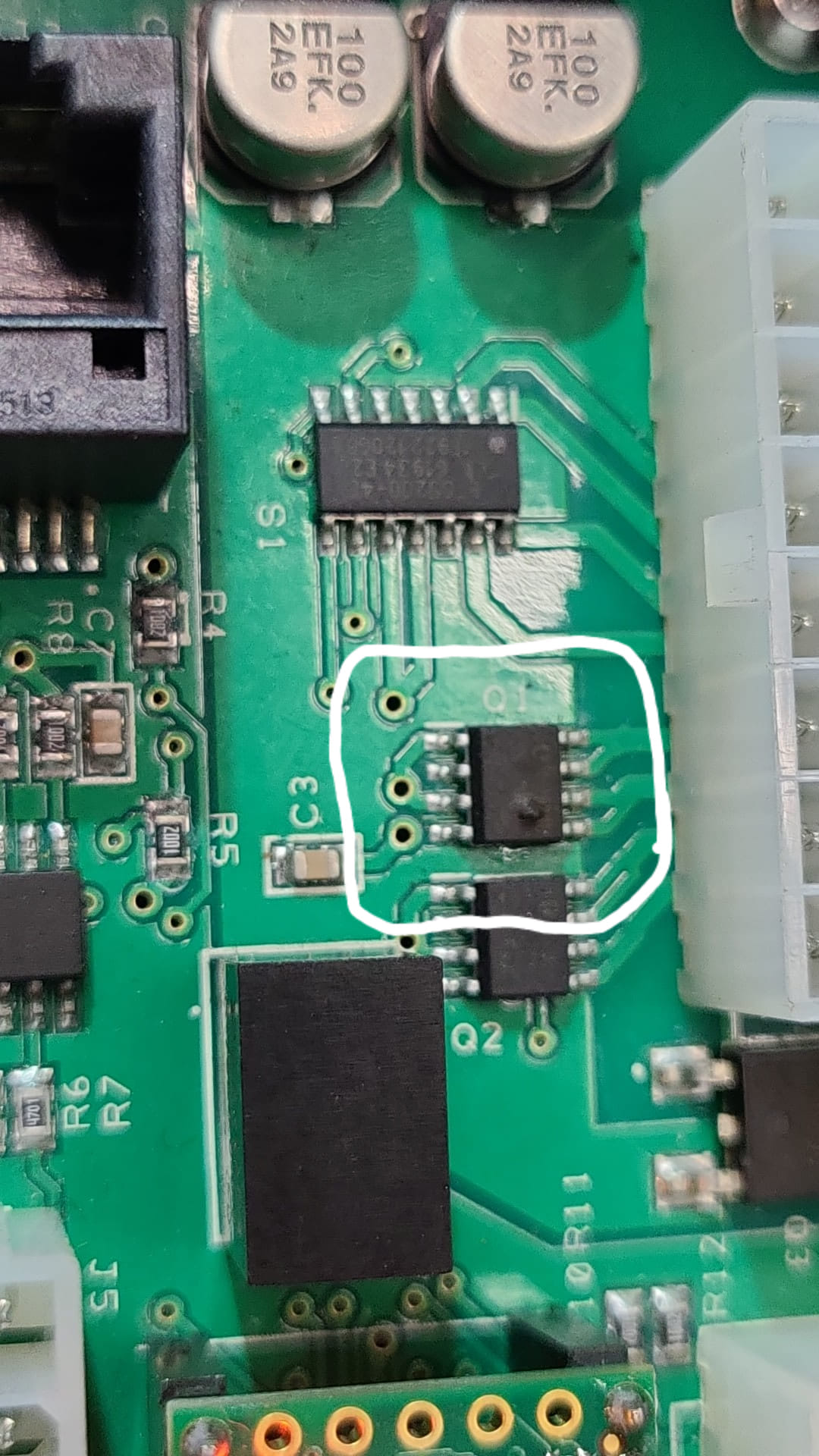

2. Thinking #1 was incorrect, and discovering they were actually not economized contactors, I connected them to the LOW pins on J4 for each contactor. I connected the teensy board to USB power, and immediately the negative contactor closed. About 3-5 seconds later, I heard what I can only assume was the positive contactor closing and immediately the IC in the photo below started smoking.
Photo from the manual of IC that smoked (now has a small bump on the surface)
I quickly disconnected USB first then the J4 connector. J4 had a VERY large spark with an audible pop when I separated the pins, but no obvious scorching on either connector or pins.

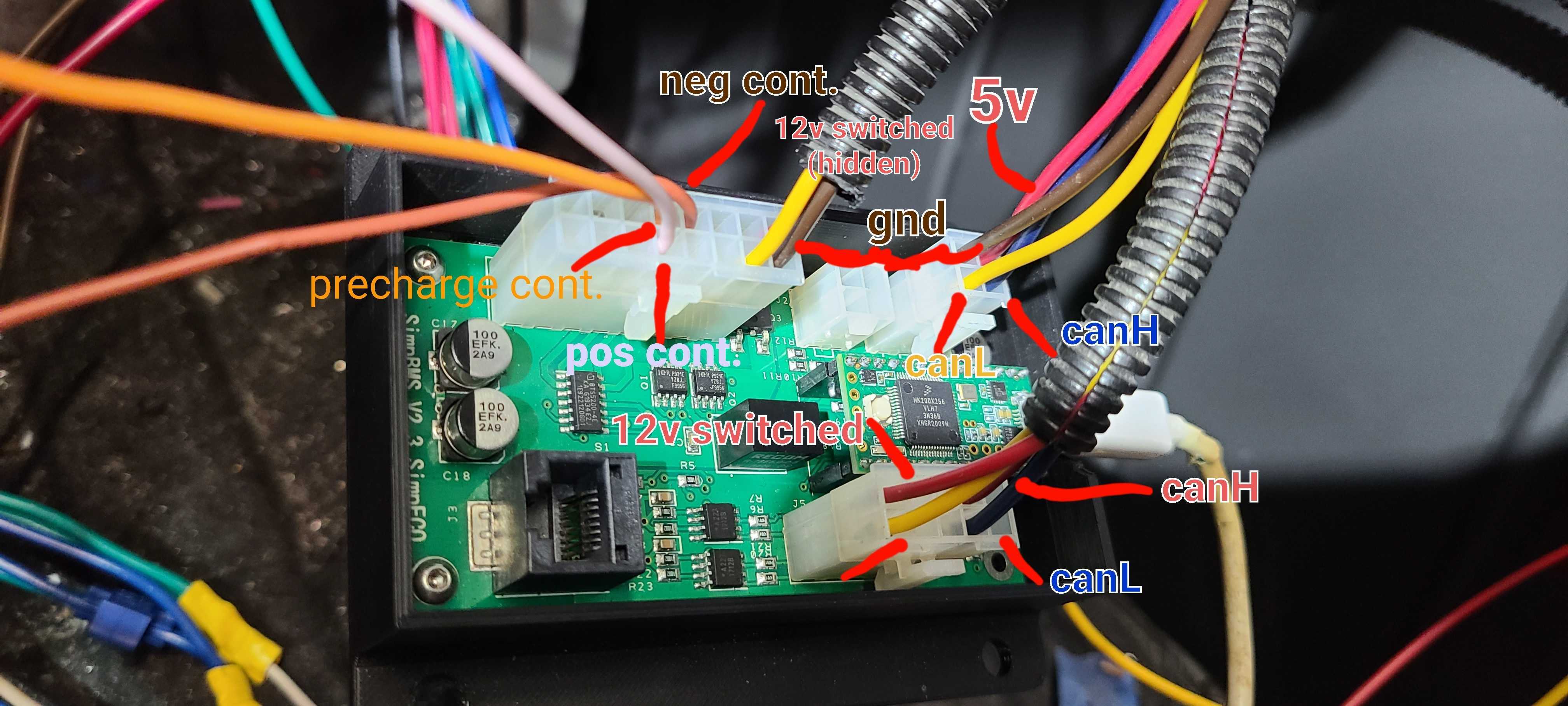

Here's a breakdown of my wiring when contactors were setup for HIGH control.

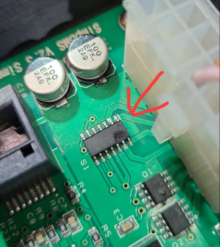

And here's the damage

Also, if anyone can help me ID the chip that cooked, I would appreciate it. I am googling all the numbers on it, but can't find it.
RandallATX
Posts: 9
Joined: Wed Aug 25, 2021 1:57 am
Re: Hitting some SimpBMS hurdles
Post by RandallATX »
So, I appear to have detonated this controller IC. I did it accidentally shorting a contactor coil wire to ground. :?
I believe it is a bts5200-4eka, but hoping someone can confirm that is indeed the chip.
Also, does anyone have one they can sell to me? It's... a little hard to find right now.

In the manual wiring for your contactor is explained. You should measure the "coil" resistance if its a fixed lowish <100 ohm value you clearly have un economised contactors. You then wired them to the low side drive without adding a diode so huge voltage spikes thus blowing the ics.
