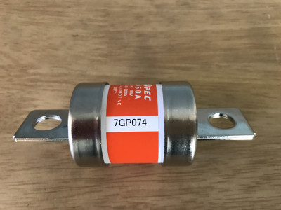

cloudy wrote: Sat Jan 22, 2022 8:52 pmThanks! Are you able to get the part numbers from the main fuse (orange cylinder) by any chance?
more nauseating detail can be found here: I bought a BMW 530e hybrid battery pack - Now What?

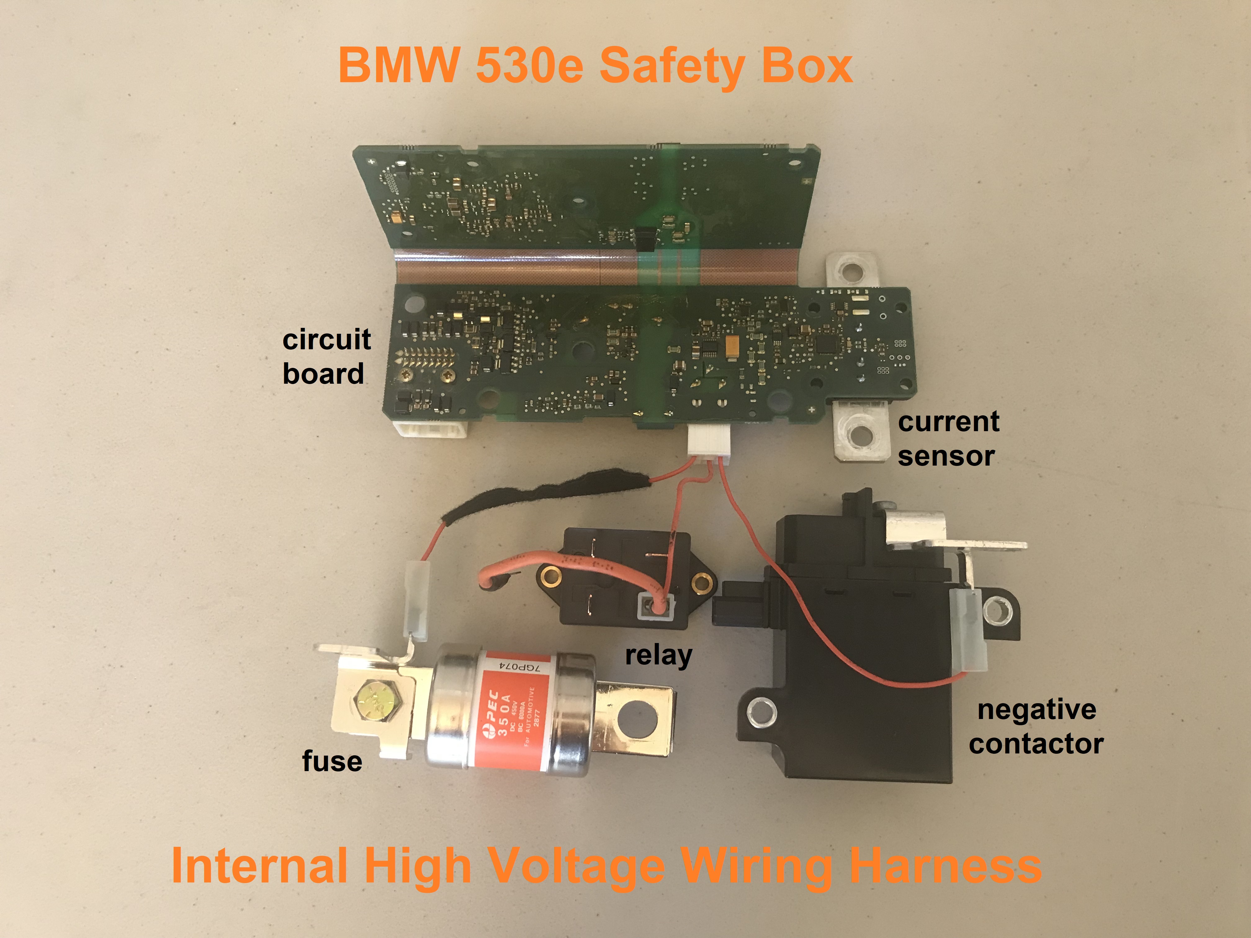

You're welcome lOl

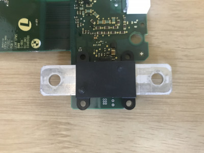

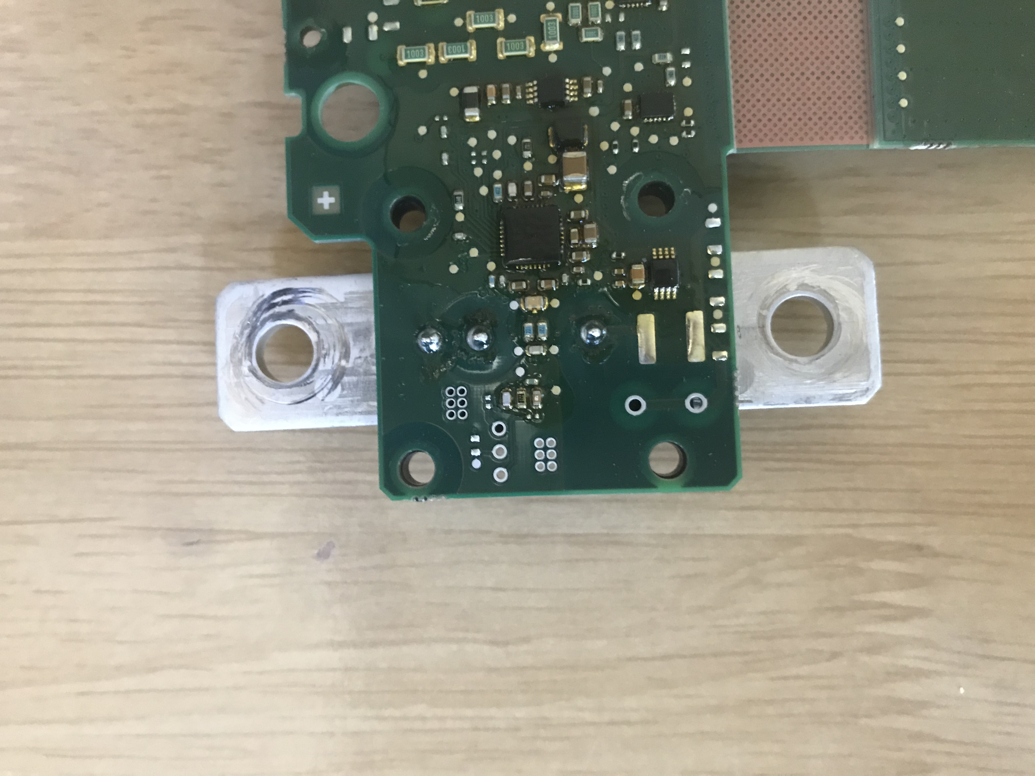

stock current shunt adhered to the OEM logic board (I could not separate these two, not sure you are supposed to)

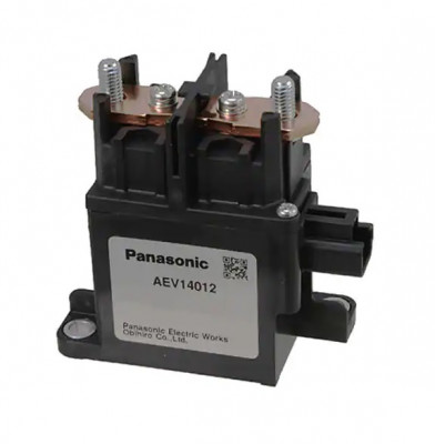

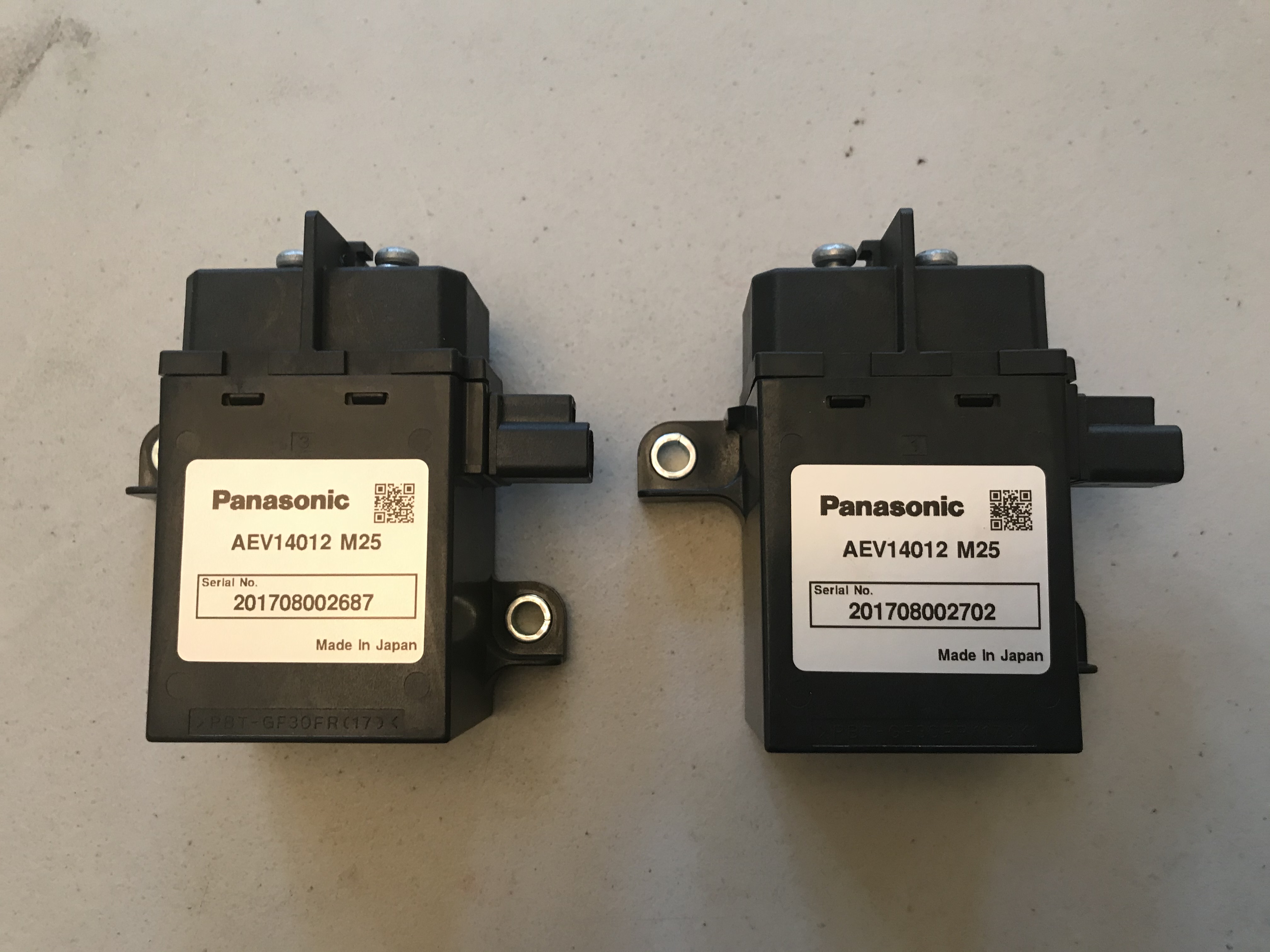

I know I am late to the party and this has been discovered already, I am just sharing, the contactors are identical Panasonic AEV14012 M25 specs claim them to be only 120A ?
note the additional busbar adapter thingies on this fuse below, this is how Digi-Key sells them for those of you considering moding your Safety Box

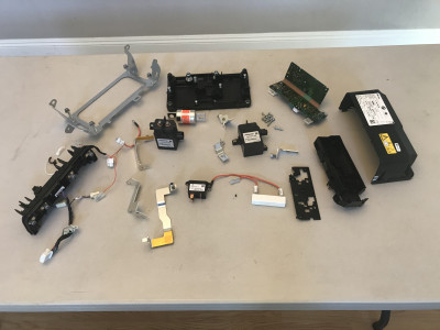

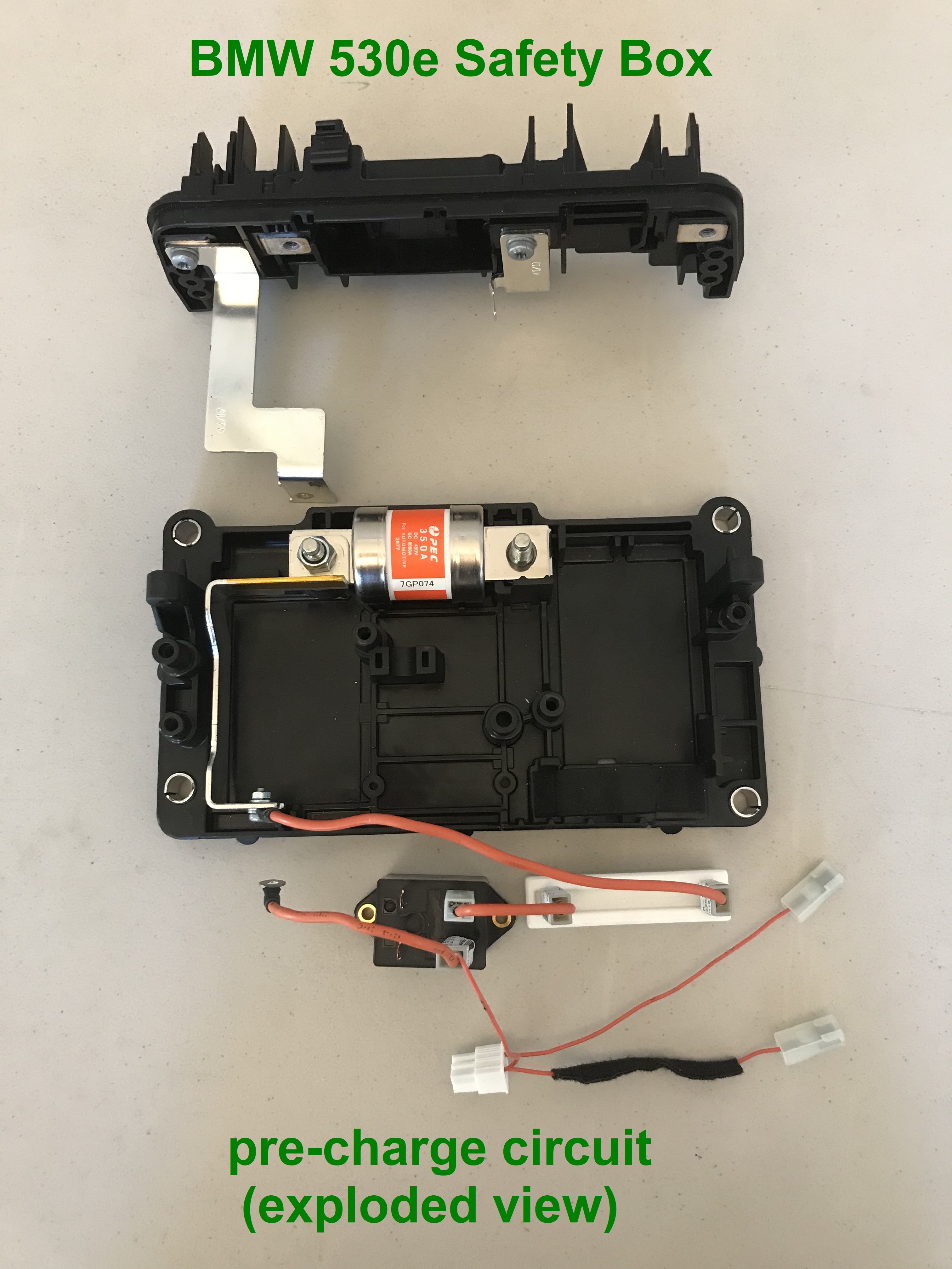

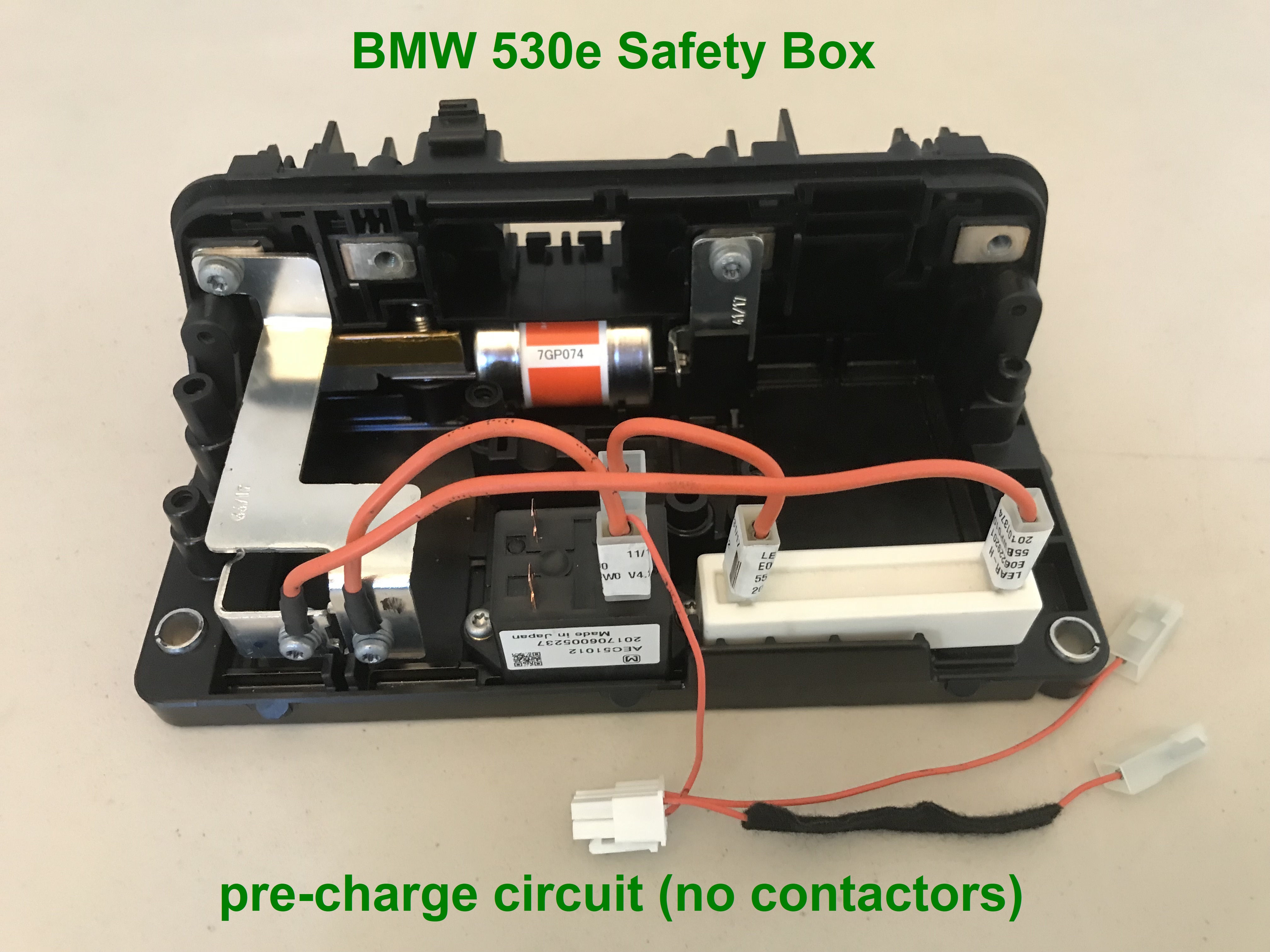

BMW 530e Safety Box just the pre-charge circuit

FYI I've blown through a bunch of the resistors in these packs (through idiocy) to the point where I couldn't find any more. It's fairly easy to re-route the wiring outside to a different size/shape, with all the usual safety caveats.

For use in place of resistor i would recommend NTC inrush limiters with a propper voltage rating.

Out of interest, how have you been blowing the resistors? Pulling drive current without the main positive contactor pulled in?

cloudy wrote: Mon Jan 31, 2022 10:21 am Out of interest, how have you been blowing the resistors? Pulling drive current without the main positive contactor pulled in?
Close - powering up DC-DC before it closed. Long story. Fixed it months ago now but cost me three resistors before I did.

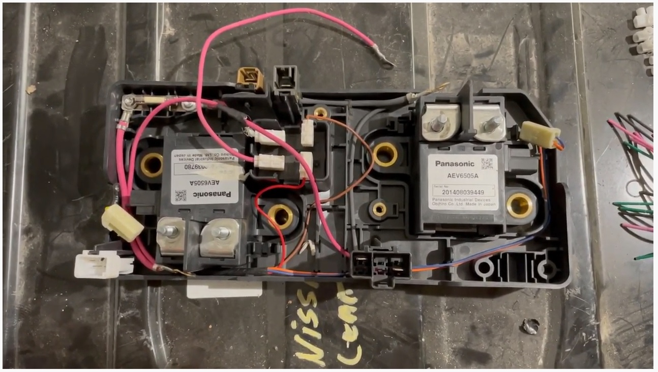

I couldn't help but see the similarities between the BMW Safety box and this one from a first gen Nissan Leaf (YouTube just suggested this video today) thought you may find it interesting

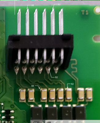

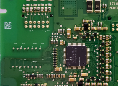

I've been reading these forums for a few months. I bought a random BWM module with the CSC module. I've been working with a friend to try and talk to the module by CAN bus, but we've not yet hand any luck. I'm attaching pictures I took and the pins I think I've traced. I'm not sure if we can use can bus directly with just these CSC modules but I thought it must be possible somehow. It seems there's many versions of these CSC control boards, and some differences. We've been working with a can shield on an Arduino, and gotten nothing. Not even sure we're hooking it up correctly, given the Hhigh, Hlow, Lhigh and Llow. I've read the lows as an inverted signal, and assumed I don't need to use them? Not sure how to find the address of the device, if we have to identify it and send it a wakeup somehow?
mjc506
Posts: 343
Has thanked: 30 times
Been thanked: 29 times
Post by mjc506 »
Ah, that looks like one of the secondary CSCs - only the first module on the second gen packs has the CAN interface.
You can talk to that chip over UART, it will need some careful soldering though.
https://github.com/mjc-506/bmsSerial/
Or Catphish has a gadget that talks using the COM lines directly - no hardware mods needed.
