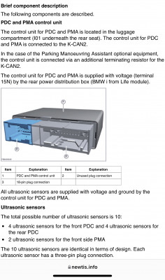

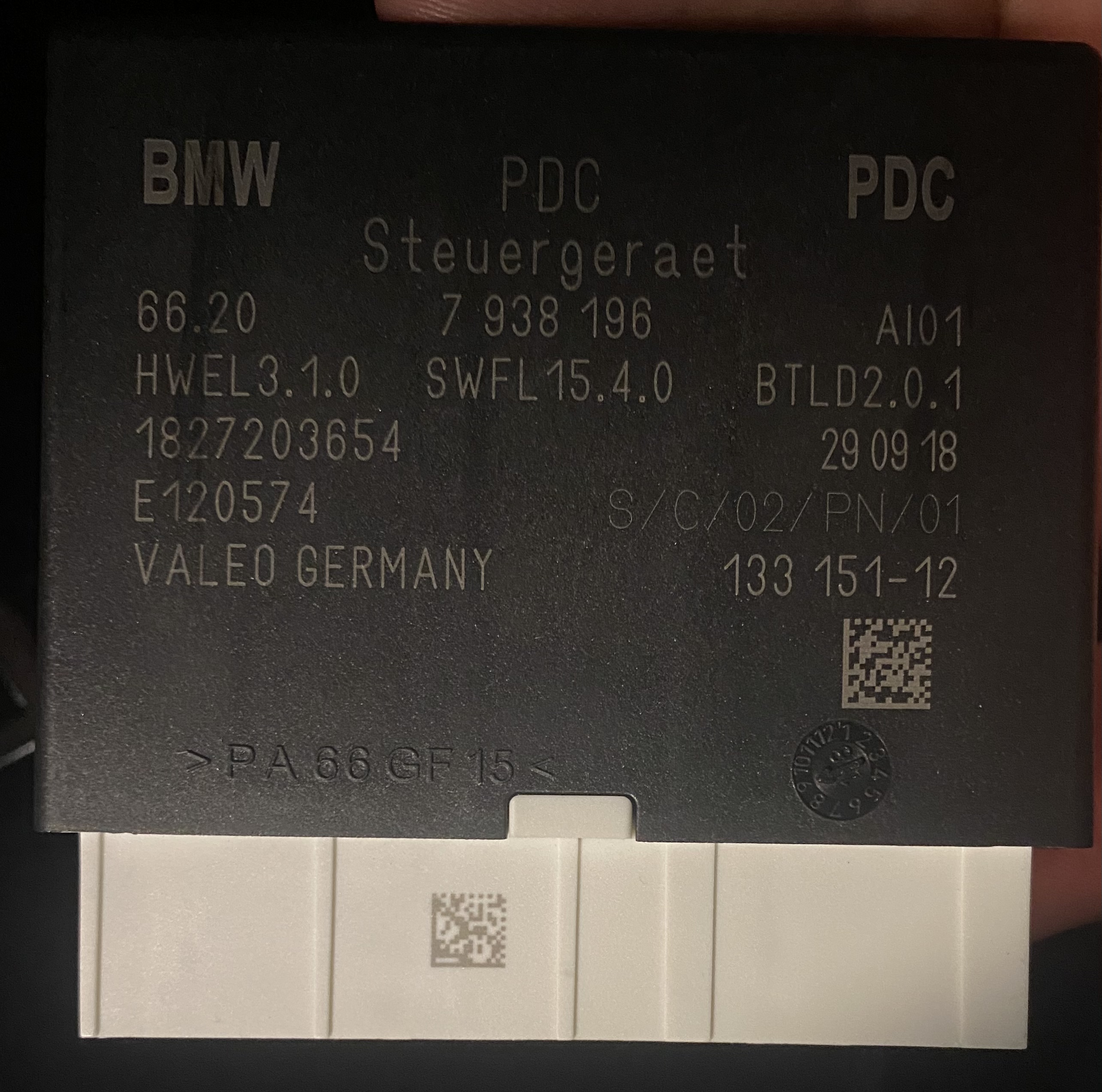

Hi, I want to add the front parking sensors on my BMW i3. Does anyone know the pinout of the PDC module?
I already have the colors code of the wires and sensors, just need to know the pinout numbers of the module.

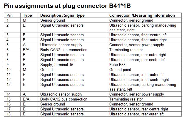

Here you go:

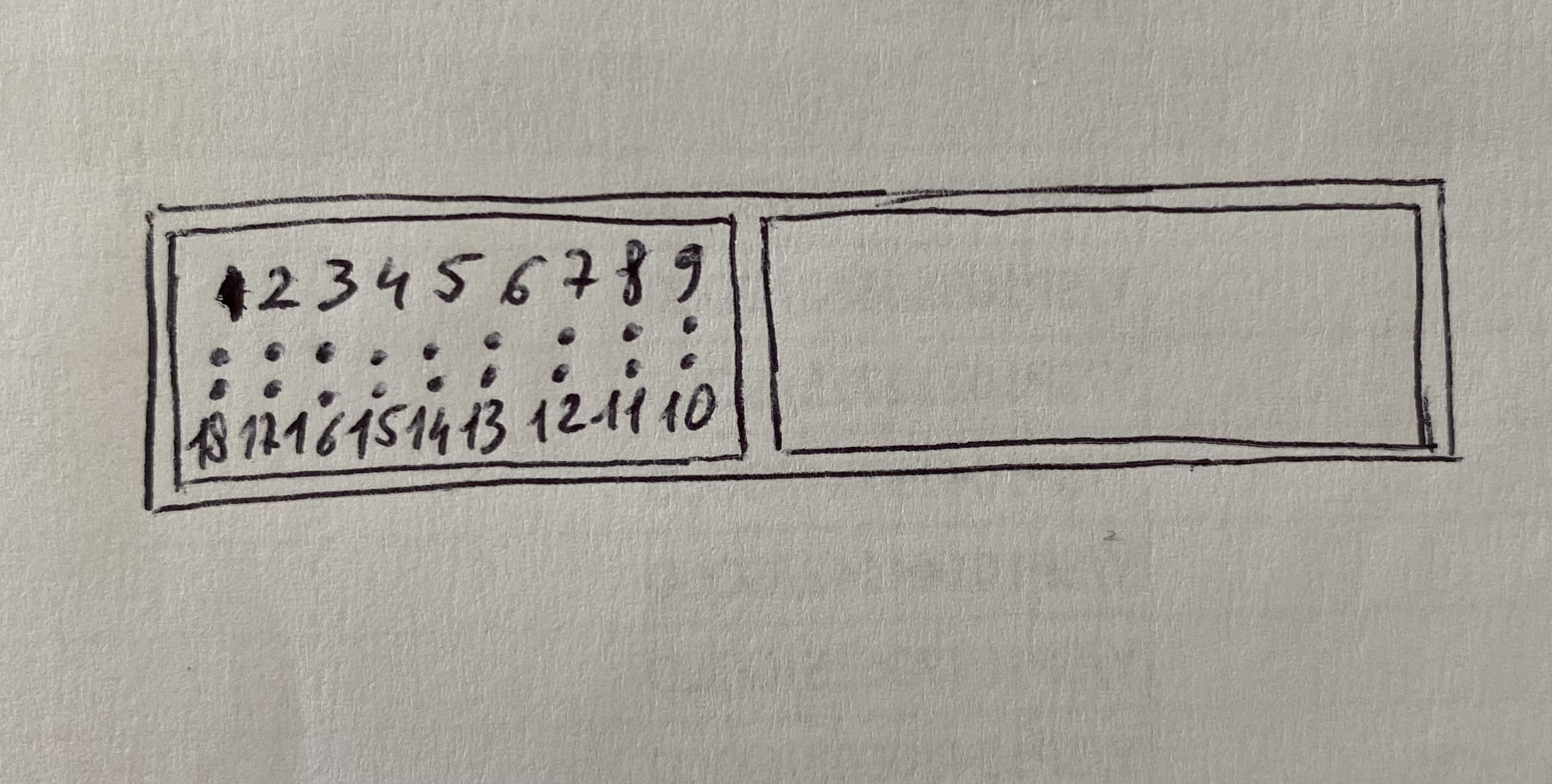

Do you know if it is this pinout sequence?
Thank you

not sure sorry - you should be able to trace the ground easily to confirm pin 10. Canbus will probably be twisted together (pin 6/15) so that might help also...

If you have the loom half of the plug pull it apart, it'd almost guarantee it was numbered somewhere on the plug, usually really small though

Usually there are very small numbers in the socket as well.

Thanks crasbe I found it 👍
