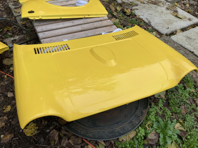

  • Picked a color and got some paint on the hood and doors

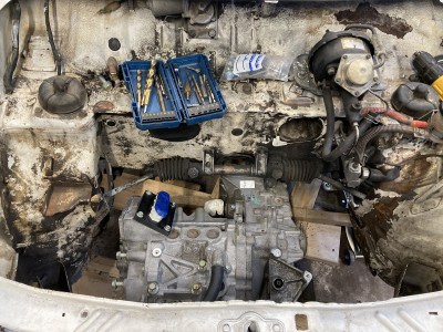

  • New subframe welded up -- paint going on this week
  • Leaf EM61 going in this week

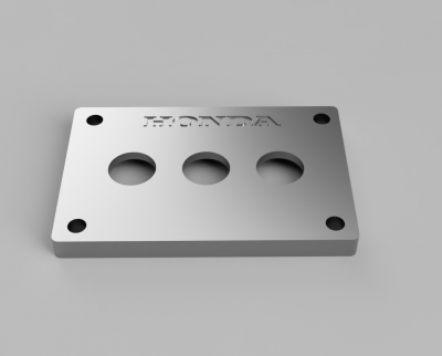

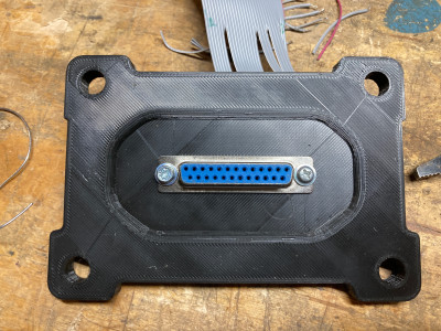

  • Blanking plate for Prius Gen3 (Had some DB25 connectors lying around -- CADed out printed). Thanks to bobby_come_lately for the base model
  • Leaf EM61 Blanking plate (3phase cable glands out CADed and printed)

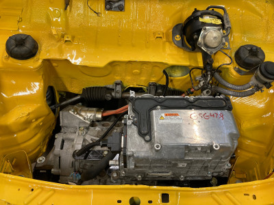

A little more progress made:
  • Body painted
  • Nissan Leaf EM61 motor mounted
  • Prius Gen3 inverter mounted
  • DC-DC working from inverter (resistor swap)
