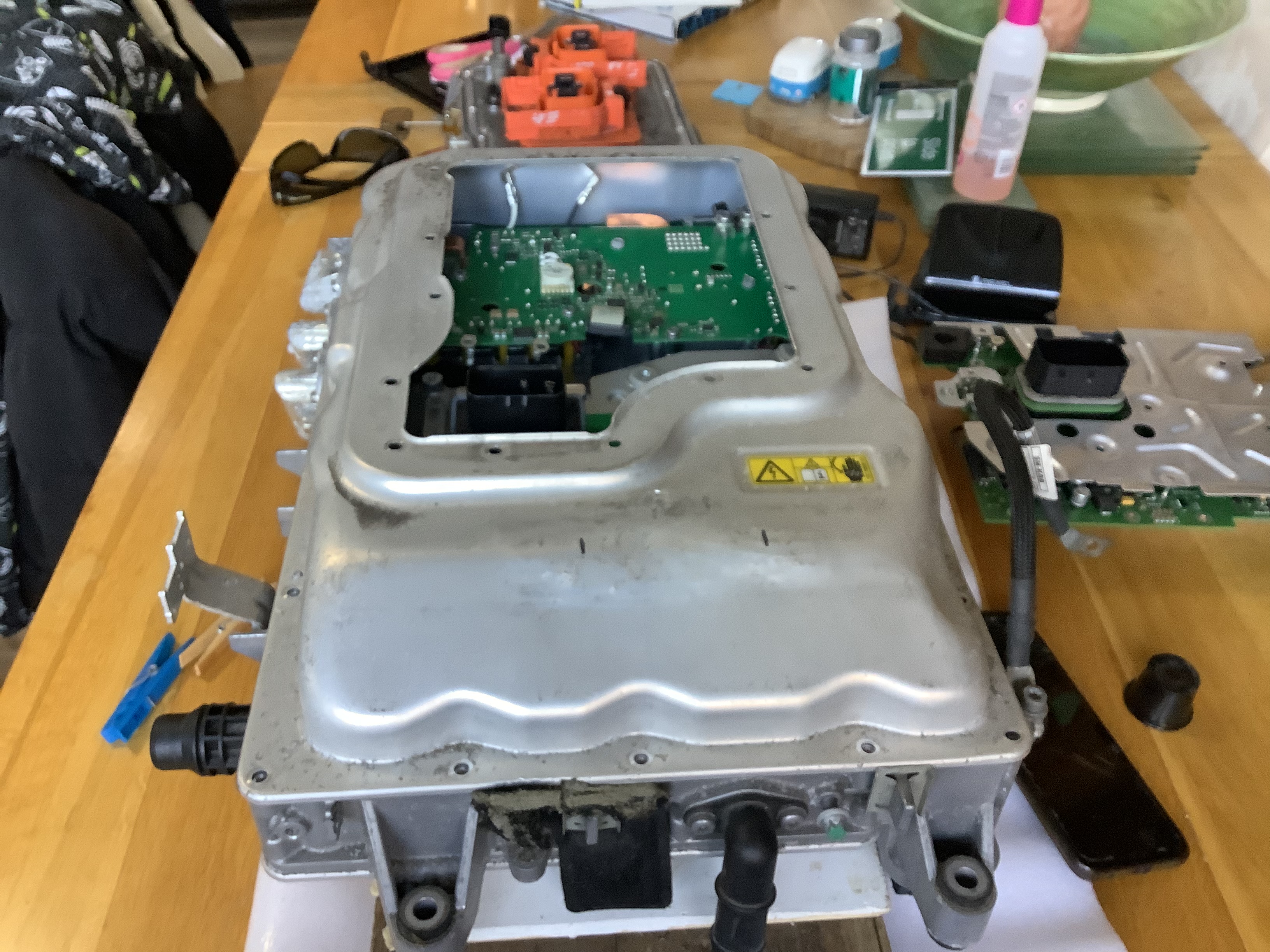

I've just popped a video up on my YouTube channel showing me replacing the two boards of anyone is interested. I know most of you are ahead of me but thought it might be interesting.
I'm now looking at the parameters but if anyone else has made a start please could you give any details of what you are setting? I have managed to do the basics like polespairs (6?) Voltage (360?) Snshs to i3 and throtramprpm to 11400?
Cheers
Cheers
Restoring and converting a Classic Mini, I have mad ideas, semi sensible ideas and NO idea if I’ll ever get it done
- Posts: 5819
- Has thanked: 162 times
- Been thanked: 1044 times

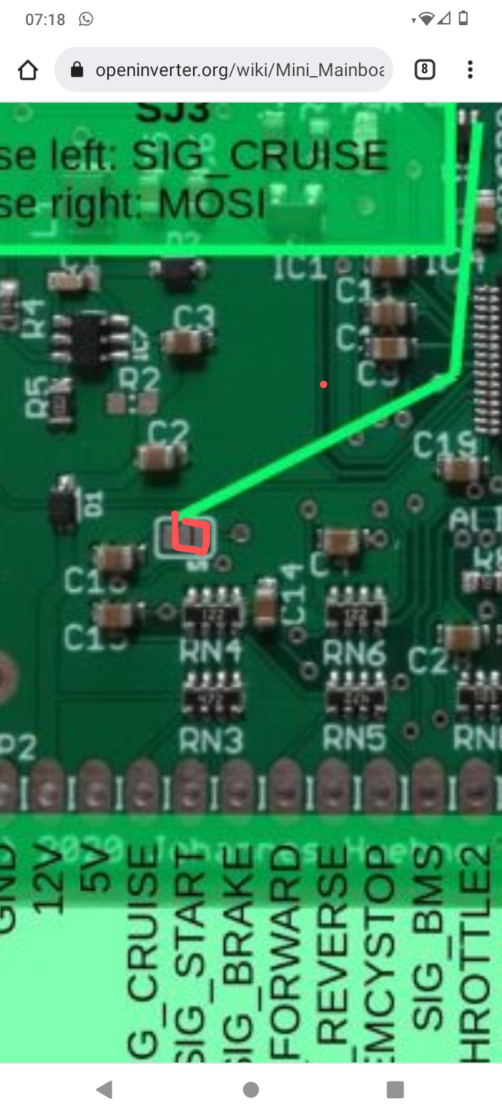

Re: i3 controller hacking from diyelectriccar.com
Very cool to see the other end
I noticed that I forgot to close SJ3 for you: https://openinverter.org/wiki/Mini_Mainboard
Just put a solder blob on to the direction of C4 on there.
Also understood now that the resolver always comes in on that red connector, would be neat to be able to plug it right in.
I'm not sure how to add photos on here, if this works is this where you want the solder Johu?
- Posts: 106
- Joined: Thu Jun 04, 2020 12:23 pm
- Location: Dorset, England
I can't post a photo
Do you mean the centre connection to the connection on the right (nearest C4)?

- Posts: 5819
You can post photos in the attachment tab below the editing field
- Posts: 106
- Posts: 5819
Exactly, that one, those two pads

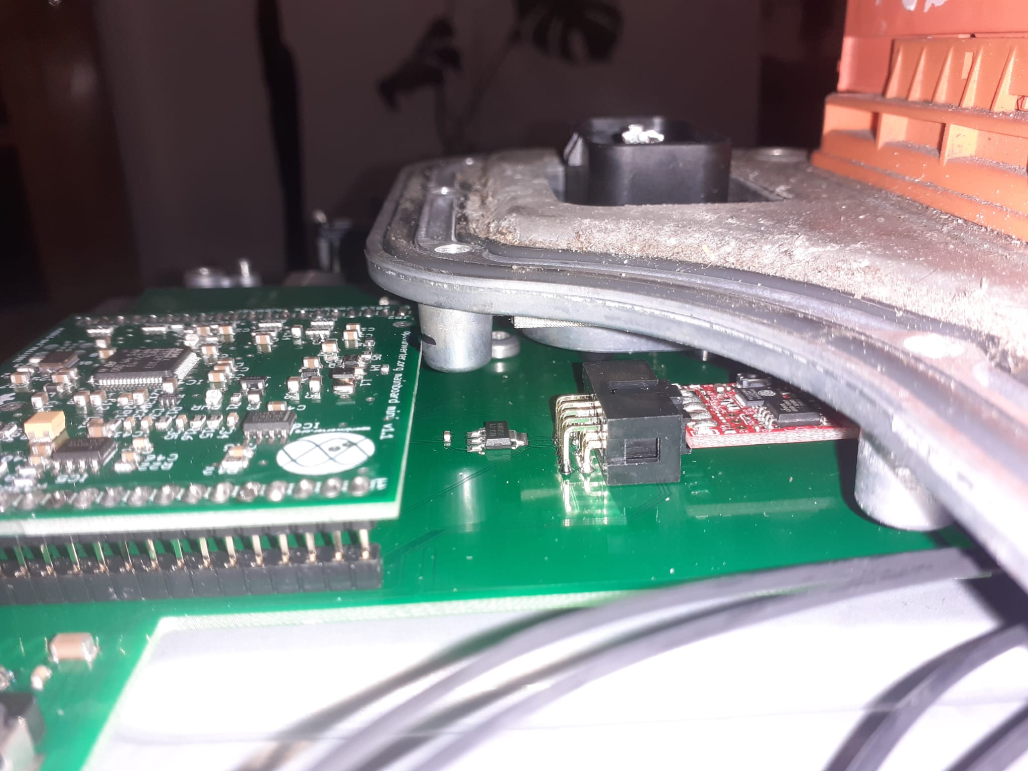

I've bent the backing plate using a socket and vice to give clearance to the board. Is anyone else looking to put the plate on top of the board too?

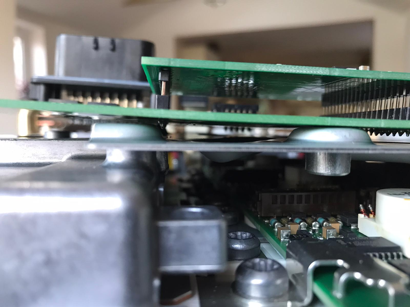

Putting the bits back together as someone mentioned on here before the board comes into contact with one of the bolt holes from the upper plate. If the small board could be moved 4 or 5 mm towards the edge it would have clearance.

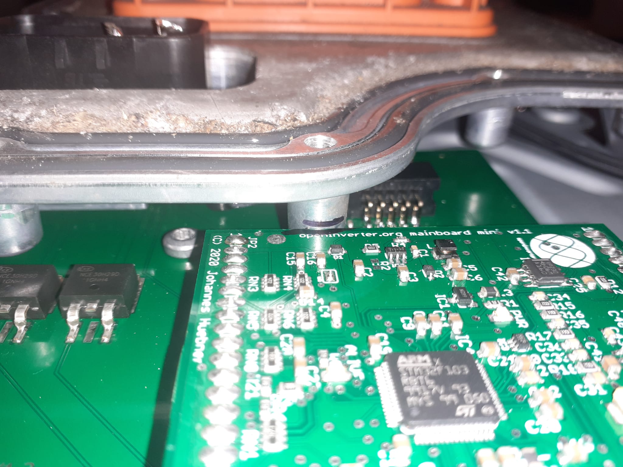

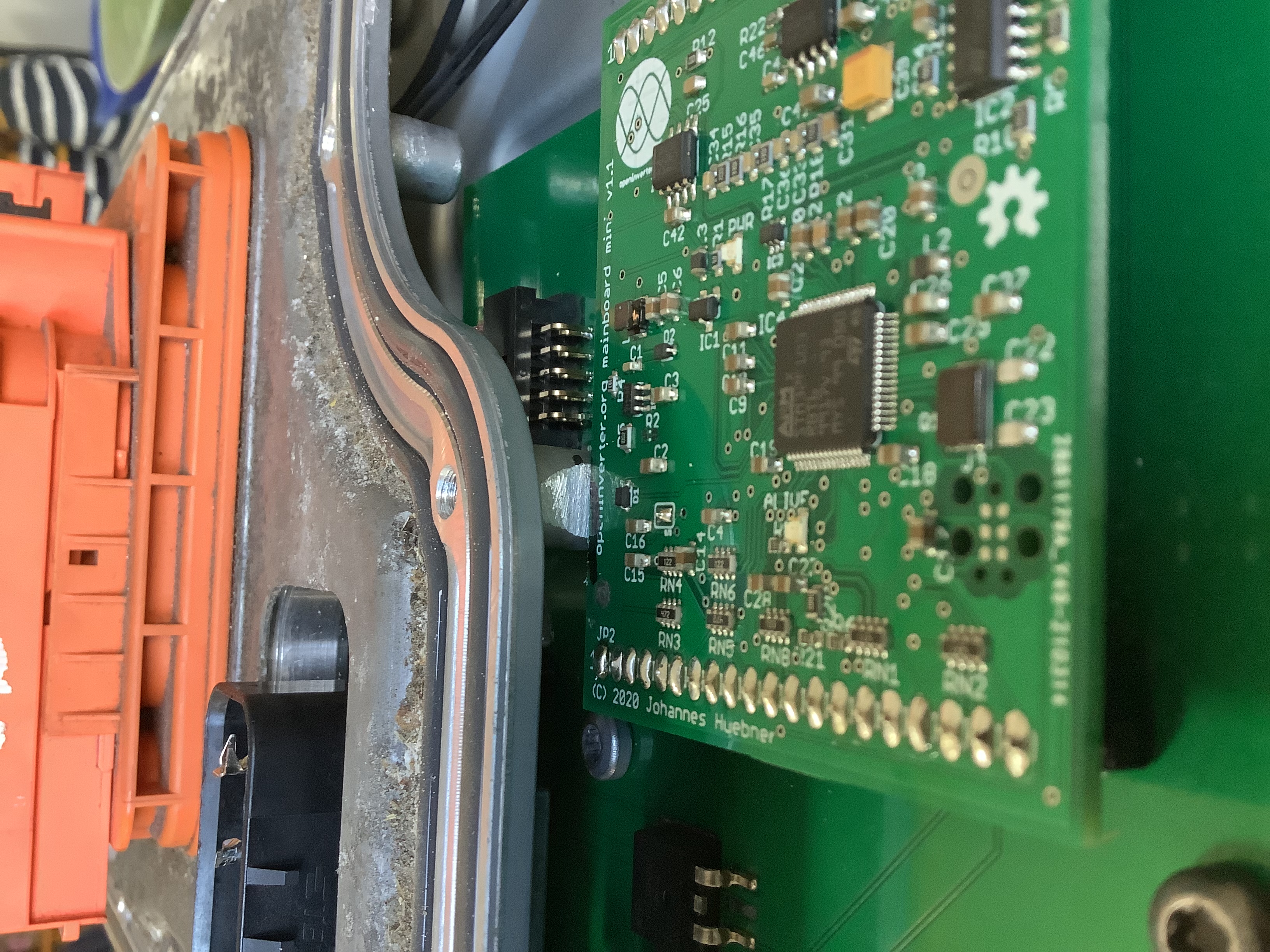

Bugger, I have signs of overheating already on the 6th pin from the right, any ideas?
- Posts: 5819
Why do you think it's overheating? I can just see some excess flux. There is no serious current on any of the pins

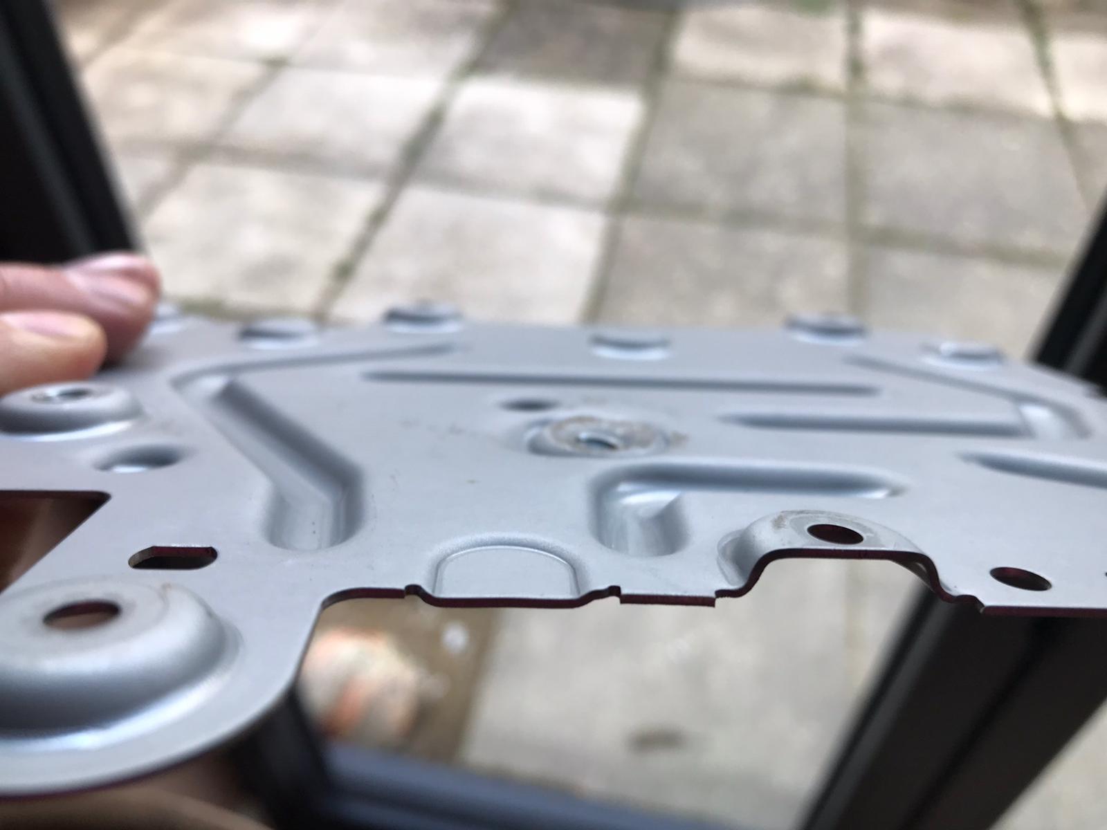

I’ve managed to file the upper plate bolt retainer without going through to the thread, hopefully that’s enough clearance
I’ve had to reshape the lid a bit, pushing it out away from the board between the two lines.
