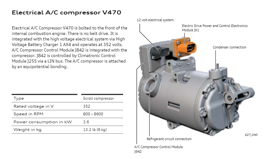

I managed to get my VW / Audi air conditioning compressor running today. It works with a nominal 352V and is controlled with a LIN bus.
So far I haven't read much about the LIN bus here. But it's easier than CAN. There is a master (my controller) that sends headers, followed by 2 to 8 bytes of data and a checksum. Or only the header is sent and a slave (A/C kompressor) replies with 2 to 8 data bytes and a checksum.
In my case I have to send commands on ID 32 and get measured values and status messages back on ID33. I have to send the desired speed, an activation bit and a start bit, then it runs and receives the current HV voltage, the actual speed and a temperature.
connectors are:
HVA 280 KEY_D from TE +HV left side (near to the 12V conn.), -HV right side (far from the 12V conn)
1J0973714 8= +12V , 5= GND, 2= LIN
to control the A/C
ID 32 (0x20)
length 6 Byte / ENHANCED Checksum
Byte 0 =RPM (dec 20-250)
Byte 1 bit 2 = aktivate
Byte 1 bit 0 = start
Byte 2-5 = 0
back message:
ID 33 (0x61)
length 8 Byte / ENHANCED Checksum
Byte 0 =1 at HV voltage under 200V, =0 above 200V (below 200V it want work, so its a kinde of HV OK)
Byte 1 =112, always, i dont know why
Byte 3 =RPM as set via PID=32 in Byte 0
Byte 4 =110 below 200V, =14 above 200V, =46 when er running.
Byte 4,5,6 =0, always, i dont know why
Byte 6 =temperature 160 at 24°C, i don't know the scaling and what themperature that is til now
Byte 7 =54 at 109V, =28 at 56V =83 at166V scaling: Voltage/2

Do you know if the different part numbers for the compressor have the same protocol and voltages?
From what I've found now there are three part numbers with different suffixes. I could imagine that there are different versions for R134a and R1234yf. All of those are not made by Denso, even though they look like the one in the picture.
12E820803B
12E820803C
12E820803D
12E820803E
5QE816803
5QE816803A
5QE816803C
5QE816803D
5QE816803F
5QE816803H
5QE820803
5QE820803A
The one I found which is made by Denso is used in Porsche Hybrids and has the part number 7PP820803B, but it looks nothing like the one in your picture.
Can you share the part number of the compressor you used for testing?

There pretty much the same apart from the 7PP.
the letter at the end signifies a hardware or software revision normally minor changes.
the 12E compressors was originally for the VW E-up but was also used on the early golf GTEs before they where changed to the 5QE ones

@muehlpower: Can I add the picture in the first post to the Wiki?
