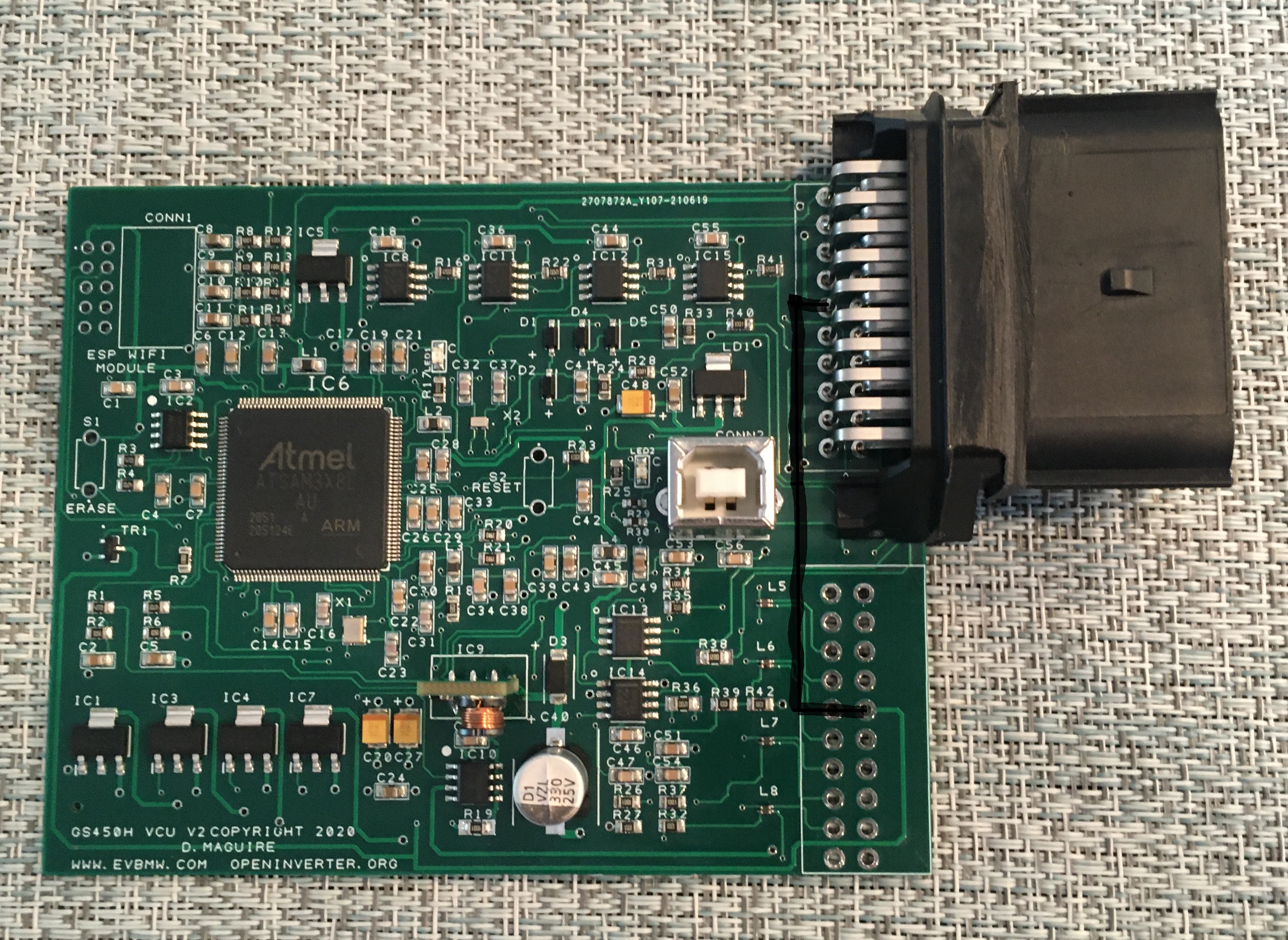

mayes8229 wrote: Fri Dec 10, 2021 2:43 pmYour board has V2 in silkscreen, so there's your answer. Because it's a V2 there's a different power switch and a BJT rather than a FET, but that doesn't change the previous comment about not being able to PWM that signal.

Technically the only thing holding us back from going to a single 20 pin header connector aka the black B plug is the Transmission Oil Pump PWM signal on pin 16
Gregski
Posts: 2723
Has thanked: 499 times
Been thanked: 945 times
Post by Gregski »
SOLUTION: I call it the internal PWM ByPass
yes I will unsolder the B Connector pin #6 from the circuit board first

Gregski wrote: Sat Dec 11, 2021 4:19 pm SOLUTION: I call it the internal PWM ByPass
It’s your project, do what you want. You might not even need to desolder the pin, just unconfigure/undefine it in the code. If you find that you need the ground from connector A you can always jumper that over to the ground on B. Having said that, there’s a lot of potential functionality you’d be foregoing by not using any of the in/outputs from A.
