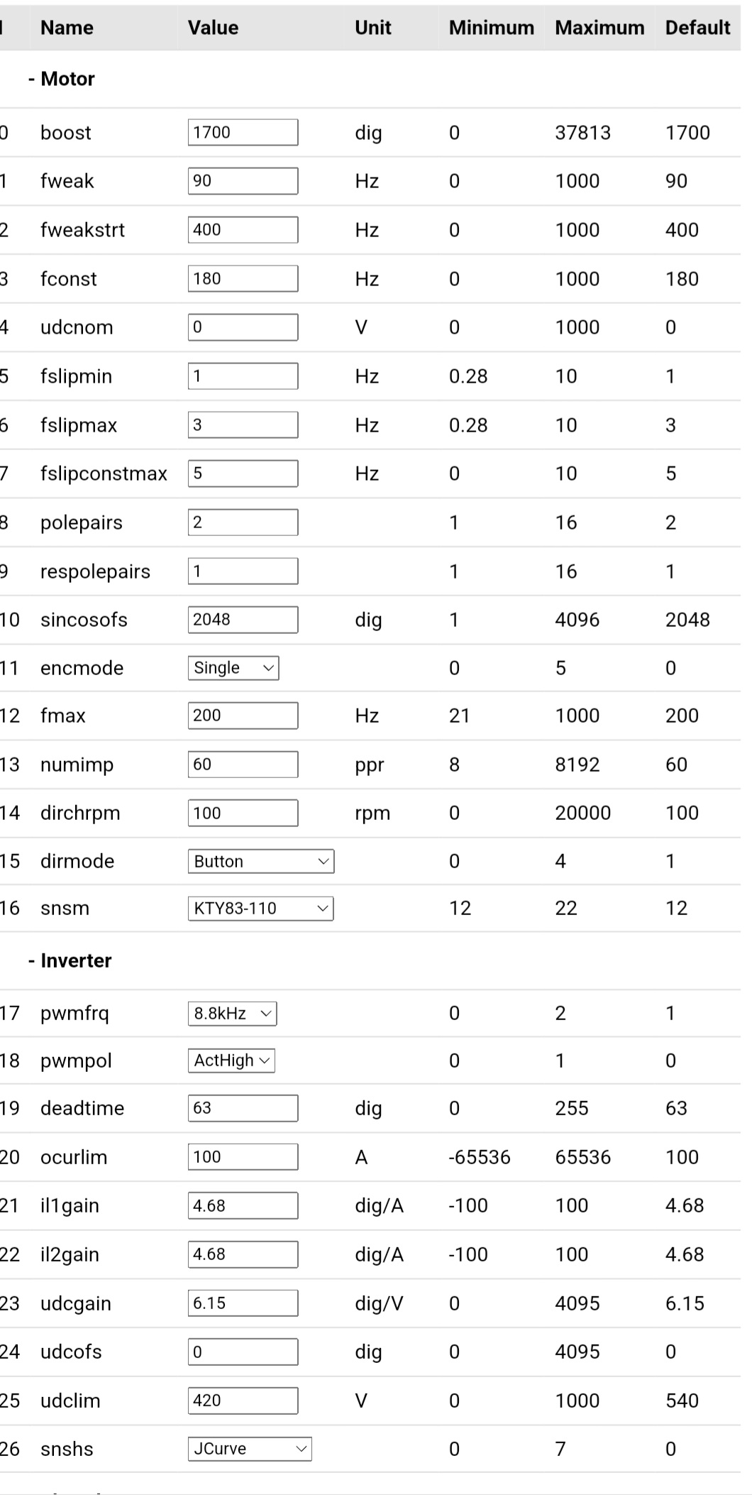

Re: Main relay opening when throttle signal
Johu here are some pics of the web parameters
with no voltage applied.
- Been thanked: 1913 times
Re: Main relay opening when throttle signal [SOLVED]
You have default parameters loaded, please use the "Download File" button here: https://openinverter.org/parameters/view.html?id=15 and then the "Upload parameters" on you web interface. Then save to flash. I'm guessing something in the configuration makes it trip.
