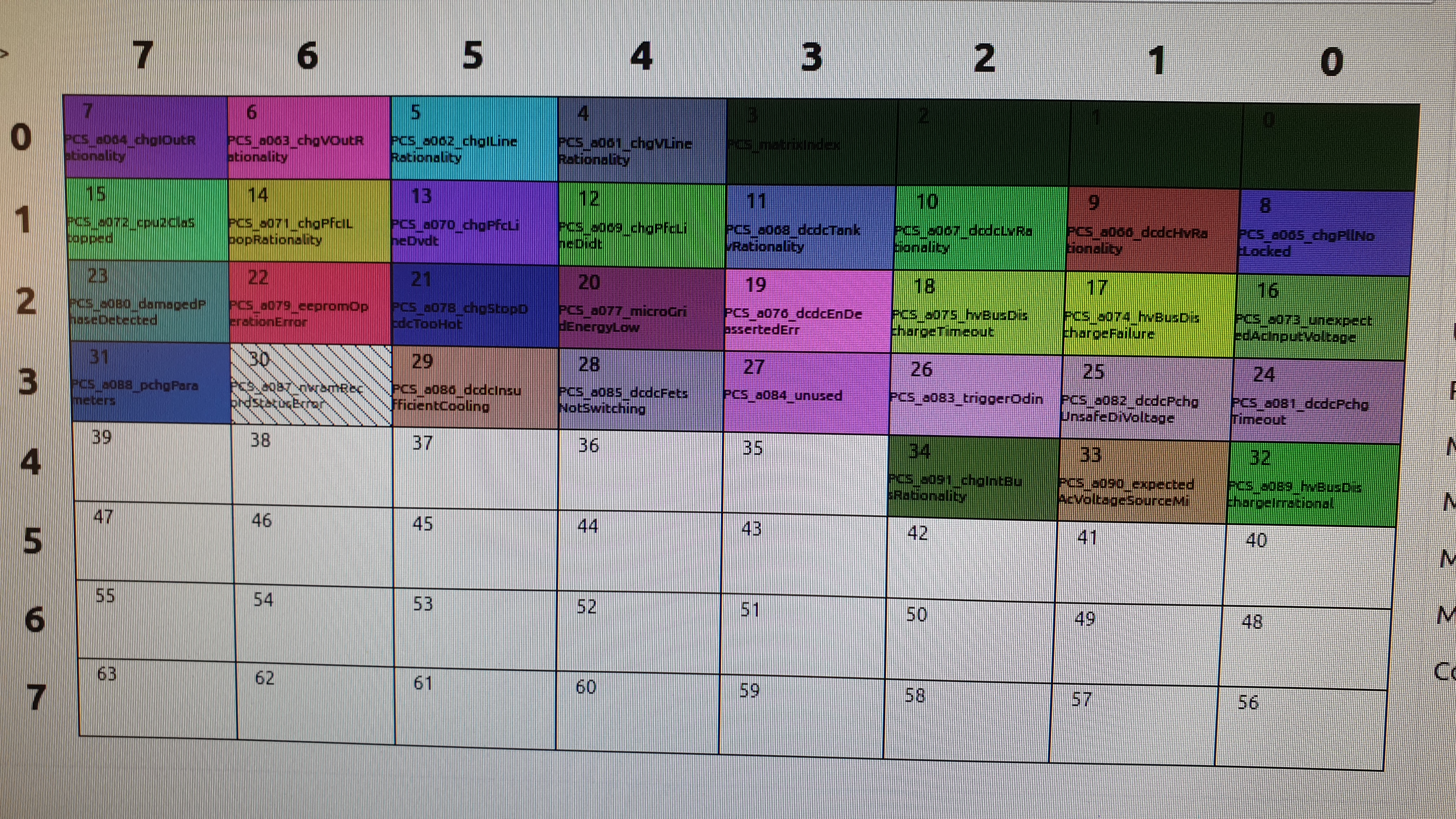

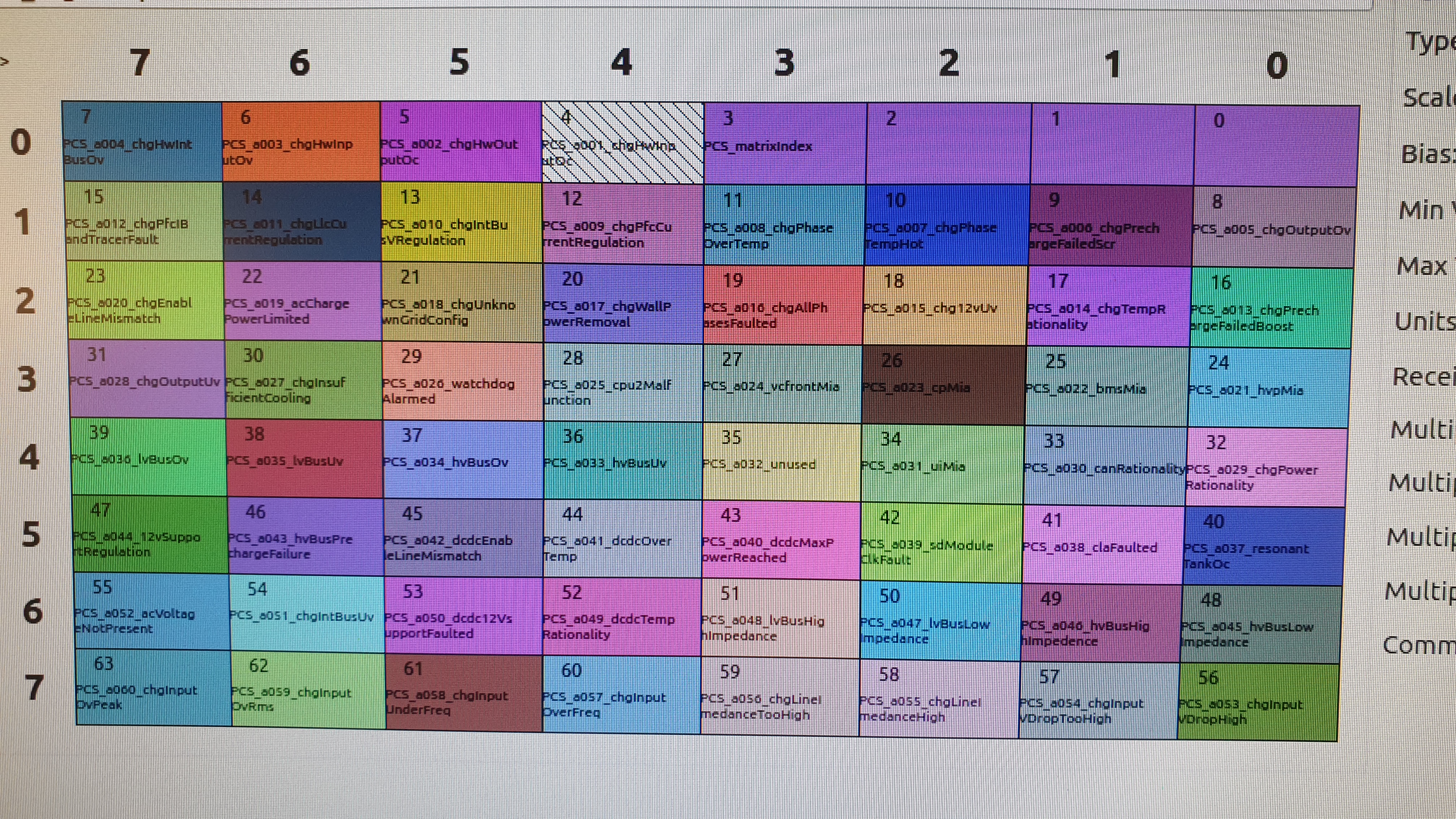

Message id 0x3A4 is the PCS alert matrix. It is a multiplexed message that will tell you all of the PCS's woes and complaints.
Byte 0 lower nibble flips from 0 to 1 indicating which message page is displayed.
Attached two pictures detailing the bits and their labels. The ones of most interest will be the "MIA" flags. e.g. page 0 bit 24 = hvpMia this means the PCS is not seeing a message or messages that should originate from the hvp (high voltage processor).
Now, all that is needed is for someone to transcribe this info into a dbc file and use it in conjunction with the CAN logs from the failed attempts to determine what is annoying the PCS. Then we can work on a solution.

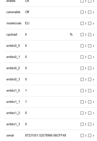

Added some experimental code:
So now all those bits can be found at the bottom of the page in errbitsX_Y where X is the page number and Y is the index. Y=0, bits 0..15, Y=1 bits 16..31 and so on. Please submit what you're getting when the PCS should be charging but isn't.
In this version I've also fixed the 2D/5D issue.

Did a quick test with the new firmware and the dcdc converter did not work this time, but we can skip that for now.. Lets focus on charger
Also read the can message. 0X3A4 @ 01 00 01 00 00 00 00 00
Getting error bit 16 on page 1, which would mean PCS_a73_unexpectedAcInputVoltage
according to Damiens matrix.
I have double checked that the voltage is not present before EVSE activate
Can it be that we enable EVSE Before the pcs get start sign from the PCS controller maybe?
