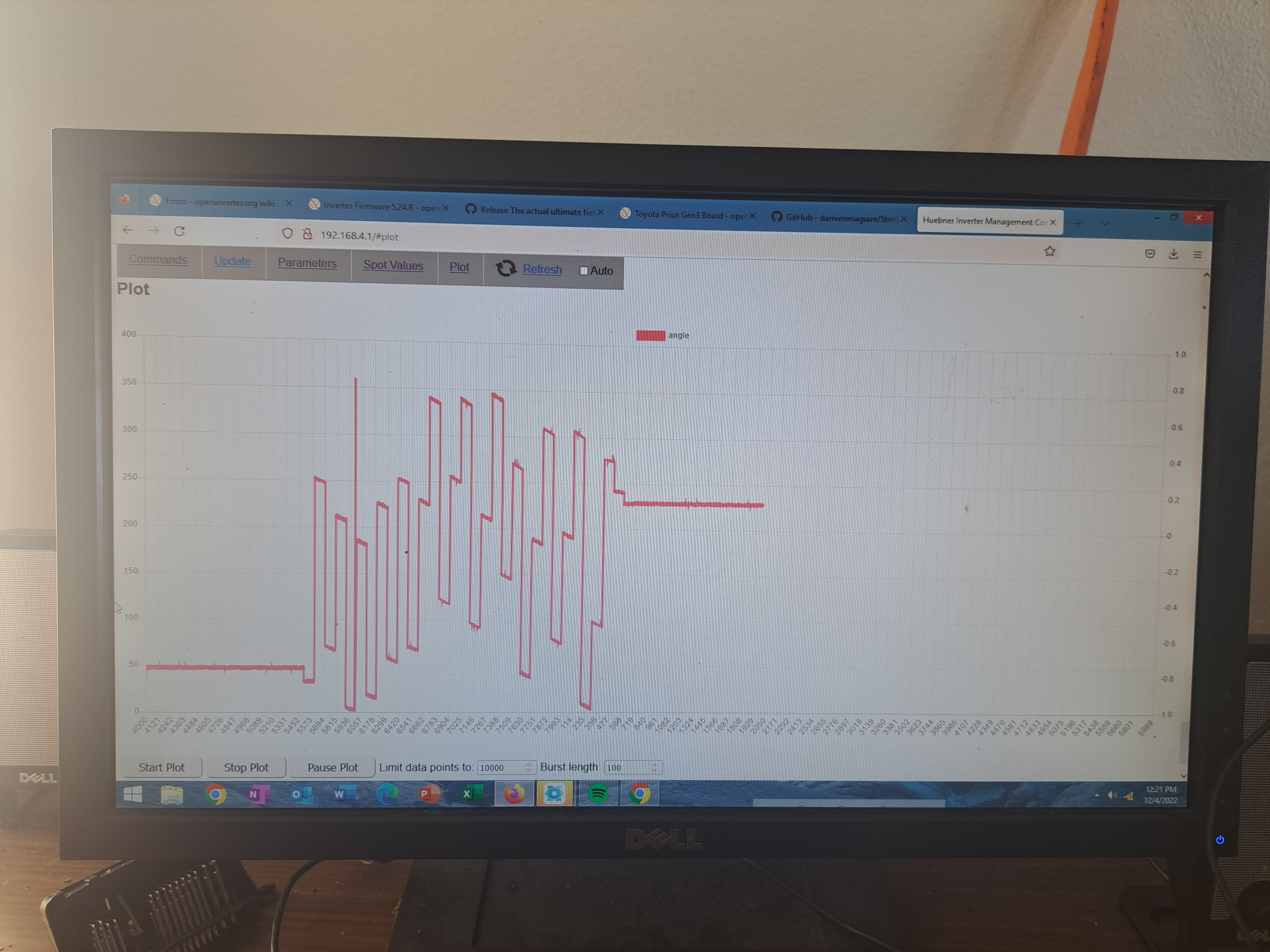

5 months since I looked at this thing and I'm finally making some progress.
Found out the ribbon cable I had connecting the idc connector to the stock prius external plug was bad. This caused me so many headaches!
Removed it and just running a bunch of jumper wires for now.
Any insight for finding the number of pole pairs on a resolver? The angle plot I'm getting is close, but still not quite right.
Motor shakes a little when applying manual id in FOC but no movement.

Can't help you on pole pairs, but on the shaking - is it perhaps the phases that need swapping around? This threw me once. Thought it was the resolver and actually it was the phase connections.
andrewjenkins34
Posts: 57
Joined: Thu Dec 17, 2020 1:48 am
Been thanked: 15 times
Re: 330e Hybrid Transmission
Post by andrewjenkins34 »
Thanks for the feedback.
Unsuccessful finding pole pairs of the resolver but I read somewhere that resolver pole pairs typically match motor pole pairs and I have 8 motor pole pairs. Used an led connected to motor windings to count the pulses through a full rotation which gave me motor pole pairs.
I tried the same thing with the resolver but couldn't get the led to pulse. Either way, I tried it with 8 and it spins.
I was able to get the motor spinning in FOC using manual id and I think I found the correct syncofs. Motor responds to throttle input as well but when I change to sine the angle jumps all over the place so I still don't have the right resolver settings. Instant overcurrent with any throttle input.
Thought I'd try swapping the resolver connections with no hv while in sine to see if I can find a setting where the angle reads constant then go back to foc and retest.
When in foc, the angle reads constant by the way.

These are the 4 plots I get using 8 pole pairs.
Ev8
Posts: 835
Has thanked: 44 times
Been thanked: 172 times
Post by Ev8 »
Why are you trying to run what appears to be an ipmsm motor with the sine firmware?
andrewjenkins34
Posts: 57
Because I'm learning along the way and didn't know that I shouldn't. Thank you for clarifying.
Ev8
Posts: 835
Post by Ev8 »
Ahh ok, yes you’ll be needing FOC sine is for induction motors, grab the latest foc build it’s a big improvement over previous versions
