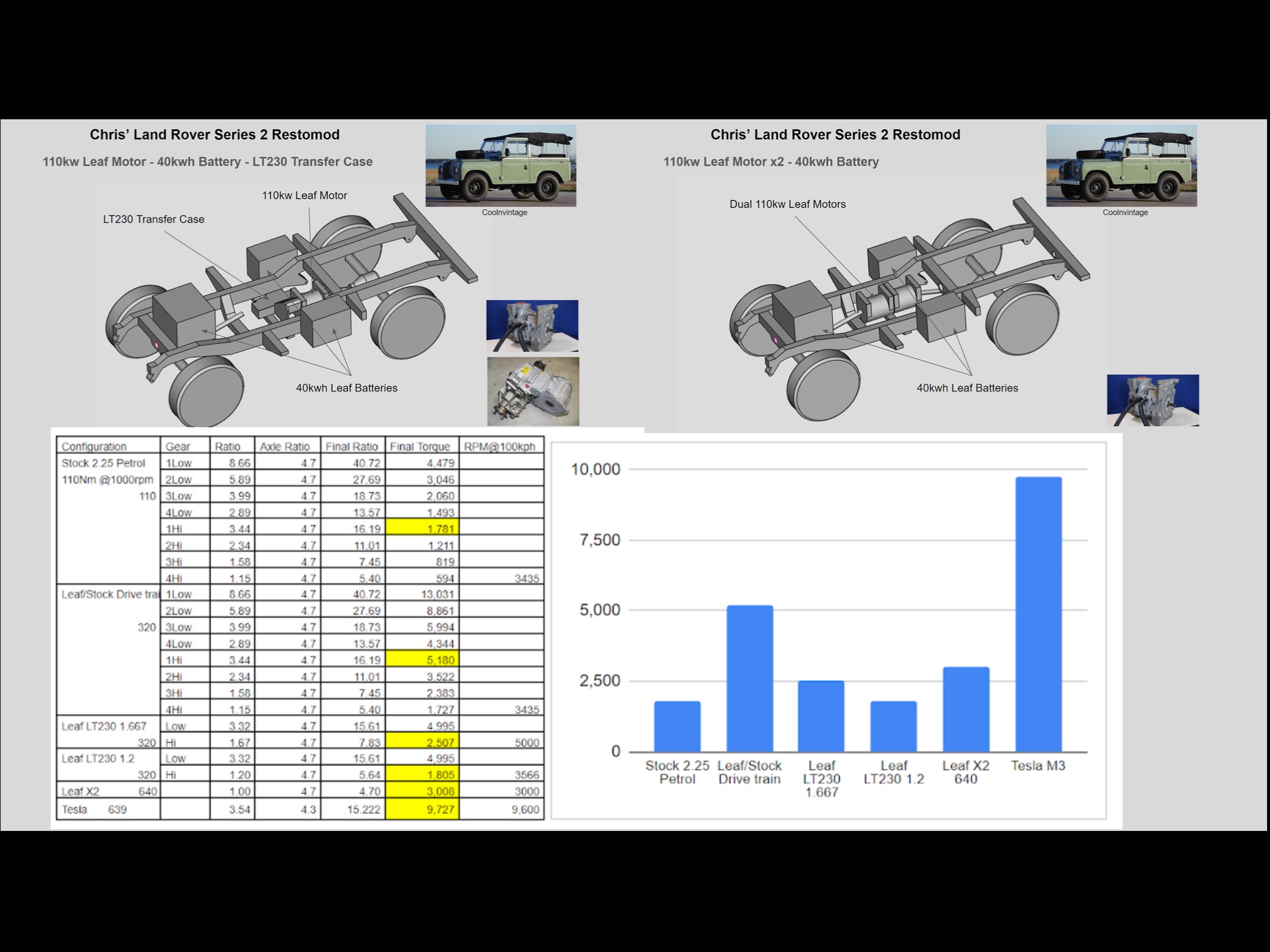

I’m thinking about using the Leaf for the conversation on my 1960 Series 2 Land Rover. I live in the mountains so torque is very important to me. Here are a couple of options/comparisons that I’ve come up with…

We're getting lost in semantics. The Leaf has gearbox that is 8:1 to the wheels. If you unbolt the Leaf gearbox and use the motor in a RWD application, it's 1:1 to the differential, which is likely around 4:1.
Driving the differential directly (with a total 4:1 reduction) results in very slow acceleration and an absurdly high top speed. It's simply an inefficient solution—you leave so much on the table.
The primary reason to keep the manual transmission is because using a 2:1 TorqueBox to drive the 4:1 rear diff (for a total of 8:1 gearing) costs $3,000 and requires fabrication to mount, whereas manual transmissions are "free" with the donor car and are already mounted from the factory.

2t car, 66cm wheel diameter, 8: 1 ratio, 570Nm results in 6.9 m/s acceleration, i.e. 4s to 100km/h. With a battery with 360V and 1200A, if there is no field weakening before 6400RPM and the efficiency is 90%.

Isnt 300Hp enough for one motor?easyandi wrote: ↑Tue Dec 21, 2021 5:26 pm I don't think it makes sense to use two motors on one axle. Then it would be better to use a larger motor on the axle.
I would like to continue to one engine in front and one in the back. The question is, is the power of the leaf motor enough or do i have to look for anotherone.
You just need to select inverter and battery to fit...
Re: Nissan Leaf Motorvarianten
300 hp per engine and way too much. How did the owner do that? How much kw does its inverter have?
