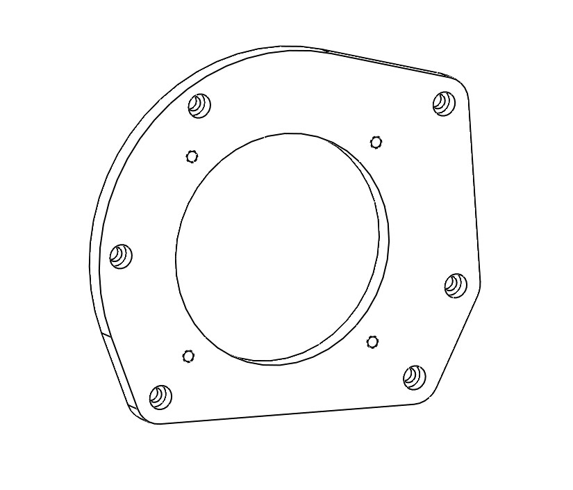

em57 universal adapter plate drawing
Tremelune
Posts: 74
Joined: Mon Jun 10, 2019 6:07 pm
Location: Los Angeles
Been thanked: 13 times
Re: Nissan leaf hardware: adapter plates, couplers, axles, etc
Post by Tremelune »
Well that's lovely. Has one been installed in a driving car yet?
Posts: 1156
Has thanked: 246 times
Been thanked: 469 times
Tremelune wrote: Sat Jan 08, 2022 2:50 am Well that's lovely. Has one been installed in a driving car yet?
Cheers.
not this revision with the NEMA B-face pattern, but the older design, which has the exact same mounting position for the leaf side, is in use in as variety of vehicles

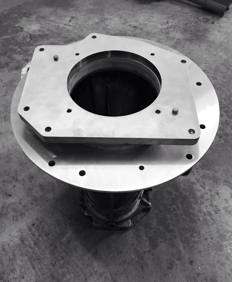

adapter plate kits for old vw beetle/bus transmissions and nissan 5speeds.
intermediate bolt pattern is all nema b-face.
next is machine mockups, verify fitment, then off to production!

Good work on the adapter plates, just checking a couple of bits on the VW plate. The two lower fixings on a VW gearbox are studs, is there enough clearance to allow for these. Also, the standard engine is not aligned by the bolts, but by a small lip on the engine ( now adapter plate) that goes into the bell housing. Is this present as I can not see it on the drawings. Hope this helps
Posts: 1156
VWJoe wrote: Fri May 20, 2022 9:30 am the standard engine is not aligned by the bolts, but by a small lip on the engine ( now adapter plate) that goes into the bell housing.
Yup! That is present. The first screenshot shows a lip on the plate.

the NEMA B-face assembly approach really shines through with how much cheaper it is to get an bespoke adapter.
Just finished measuring the Outlander rear motor, onto the em61 (gen 1 leaf) next. Then NEMA adapter plates for those motors aswell!
Posts: 1156
Re: oem hardware: adapter plates, couplers, axles, etc
Leaf em61 and outlander rear motor adapter plates cad files on GitHub. Currently Untested. https://github.com/bratindustries/adapter-plates
