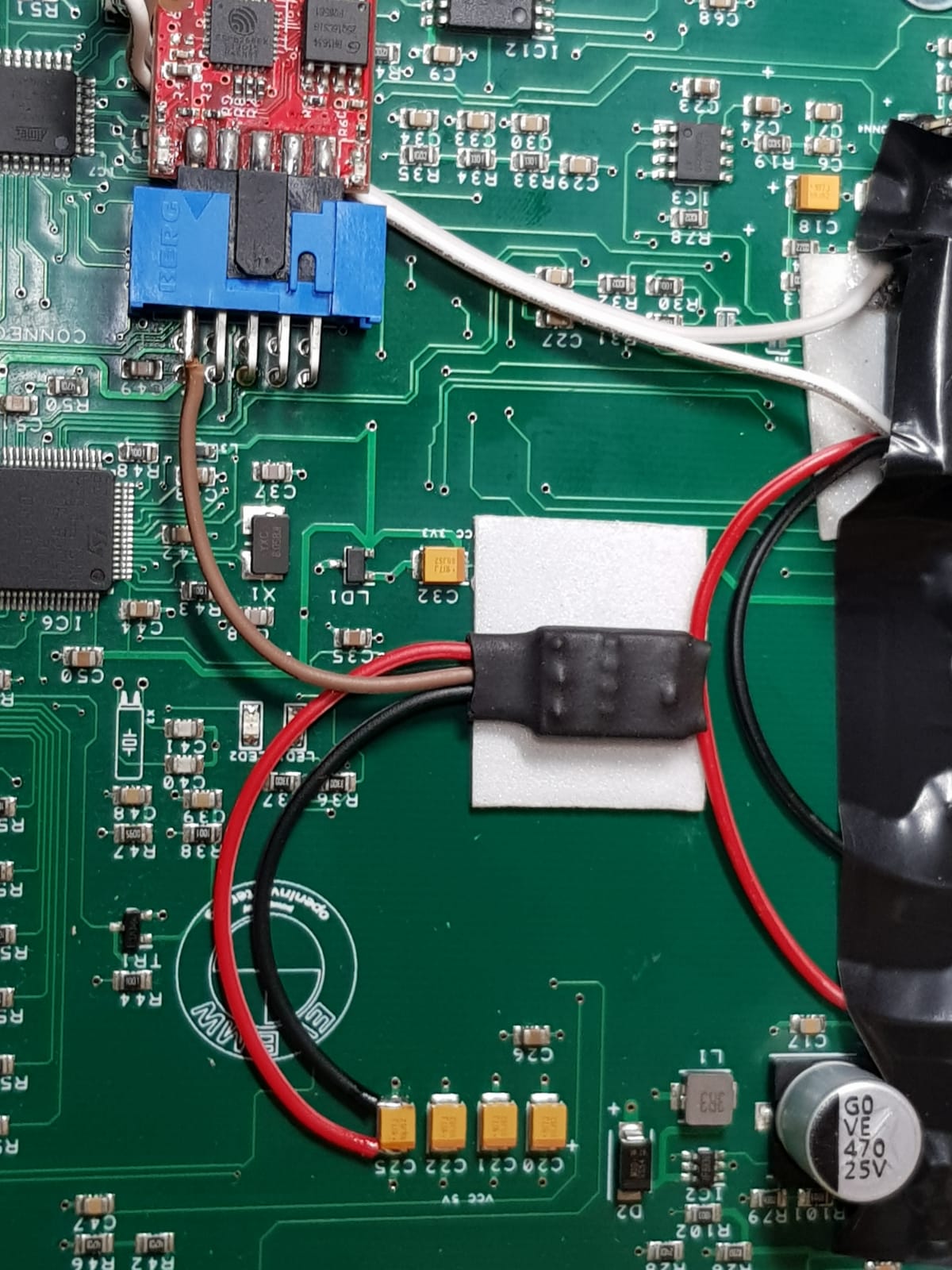

I have a trouble with spontaneously stack a logic board during driving. If I run a Plot it occure wery quick.
I think it some connect with STM core load if load more, it will occure quickly.
Is anybody faced with this bug?
Difficult is - board inside an inverter on a car. How it examine and fix? Change a board?
My Tigra is driving, but the problem can occure on 100km/h on a motorway. It`s damn

Having trouble understanding what problem you are having? Do you have the plots that may help with understanding what the issue is?

We may be looking into another LDO issue. Wifi module soaks up 3V3 power giving garbage ADC readings that somehow lead to tripping out.

If that's the issue, I've updated the wiki with Damiens suggested fix. A capacitor needs replacing.

Thanks.
I will try it.

I try to suit thinking hat and see :
ESP8266 consume 215mA in transmit mode, but LDO (XC6206P332) provide only 200mA
Where is power for STM32 ?? Asking I ?? (Where is money lebowski ?(C))
May be we must place one more LDO for STM32 separately??

I didn't do the cap change yet. I had a little dc dc board laying around so used that from 5v.

I have this problem with two Olimex boards on my dual inverter, each using its own ESP8266 wifi module. It needed a lot of decoupling even with 500mW LDOs each. I am not sure what happens, but i suspect reference plain rises because of noise and one Olimex drops OC error when i press throttle or just start DC switch.
Interesting enough i didnt observe the sam with Wemos D1 mini board. Here i have stable wifi.

OK. I placed one more LDO separately for ESP8266. First pin to the ESP8266 I cuted .
It`s working!!
I`ve not faced with brain board shuts down.
I think it must be in Wiki .
