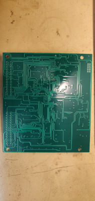

I am about to assemble the zombieverter board and I have trouble finding out which chip goes where.
I have:
3 x 3122C HAJA
1 x TJA 1055 /3/c NXP 5120006B TnG2122
1 x V7356 PUGB
1 x 2004AE SN 141 8PT
1 x MCP25625 E/ML 212296E
2 x 600
but no idea where they go / to which IC number they correspond
I hope someone can help me out here

Re: ZombieVerter VCU Support
I found that IC10 = MCP25625 and IC20 = TJA 1055
IC22 and IC21 are clear, they are the two very small ICs with 600 on them
The 3 x 3122C could be IC27, 28 and 29
Not sure where the other ICs go
I manage to find out the IC14 and IC19
IC14 looks like it is the 2004AE SN 141 8PT
IC19 looks like V7356 PUGB
I hope this is correct
I've not got my board at the moment so can't check but I found these on my phone if they are of any use ;

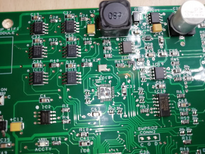

ok, here we go... I installed the ICs and connected the board up to 12 volts power. However nothing happens, no LEDs flashing or anything.
How can I tell if it is working? I measured the voltage coming in to D5 and IC11, but after that no measurable voltages coming out of IC11.
Anybody had the same issue or is just my board or ways how I connected it up?
Check voltage on L3. Should be 5V there, if not, check resistance to ground on L3. Did You correctly soldered D1 and D5?
Hi Deeamon,
No voltage on pin 2 of the XL1509 IC11, nor on L3.
The diodes where pre-assembled when I received the board.
What is the best way to check polarity of the diodes?
... with the diode function of a multimeter. Diodes only pass current one way. If you don't have diode function but can test voltage what you'd do is put your negative probe on ground and then touch the positive to either side of the diode. If one side has +V and the other does not then the diode is blocking voltage from getting through and might be installed backward. If neither side reads voltage then power just isn't getting there. If both sides have power then it might be installed properly and voltage is probably getting through.PaulHeystee wrote: ↑Sun Nov 21, 2021 3:13 pm Hi Deeamon,
