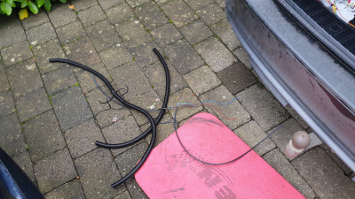

Went out today and removed about a metre of unnecessary wire and several joins from the charge port to LIM. Wrapping up I plug into ac just to test and was tidying up the wires with a few cable ties when THUMP THUMP! Contactors drop out. Wiggle the wires and bit more THUMP THUMP! contactors back in. Not one but TWO bad connections in the 6 pin connector on the LIM. I'll let you guess which two completely unimportant wires those might have been. Replaced the whole lot and dabbed a bit of solder on each just to be sure. I hate connectors. Anyway, knowing my luck it will have no effect whatsoever:)

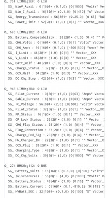

If I'm correct the wire is split/shared towards the charger and the lim.
I know that the LIM canbus sends 3b4, so the data is available the charger could be 100% canbus.

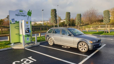

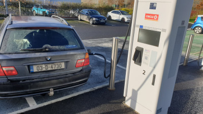

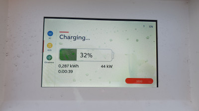

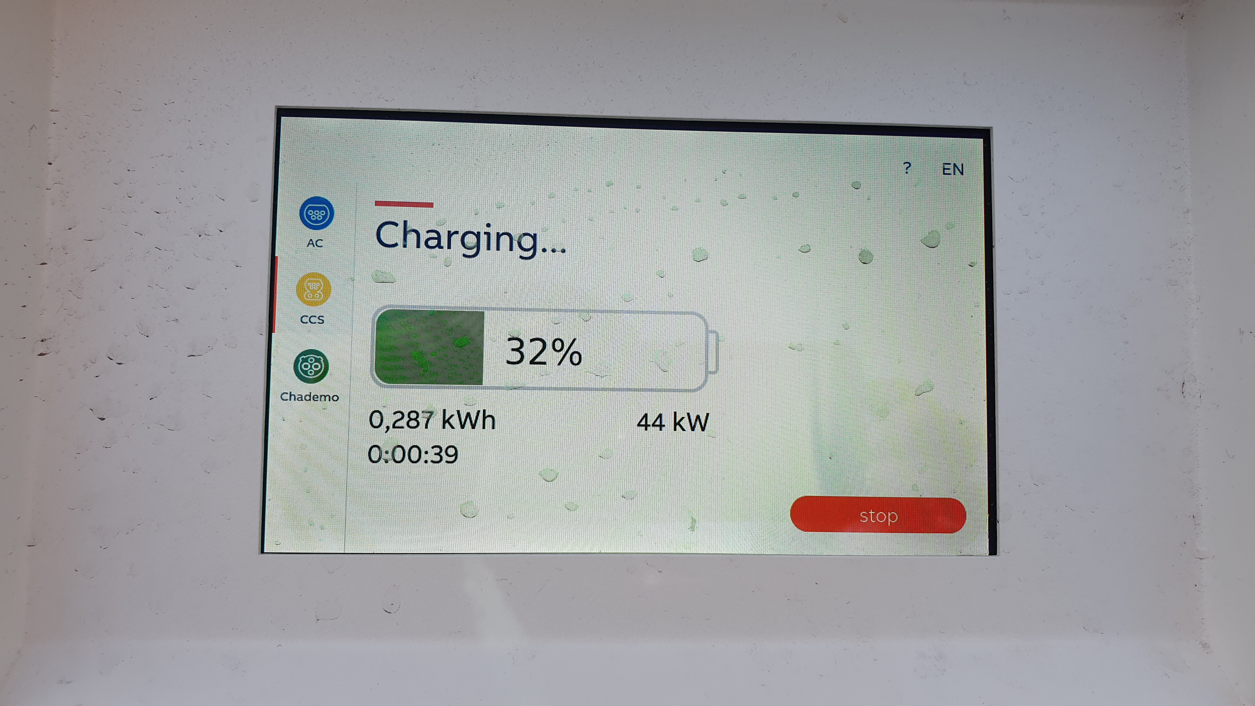

Last weekend I went on a 200 mile voyage to buy some underfloor heating mat and visited some CCS chargers including a few old friends who didn't work before but do now.
And today I was off again on a shorter 100 mile trip powered by my new best pals at ABB
That's right the ABB terra that didn't work before does so now.
At the Ionity station today I was sandwiched between some Audi and an ID4 that were charging when I arrived. When I plugged in I got the dreaded message but the new state machine just keeps retrying and after 30 secs or so we started charging. Perhaps some PLC interference from the Wolfsburg crew?
Anyway, I'm a happy camper now:)
