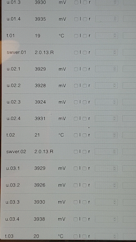

Johannes I managed to complete full calibration process. I get cell voltages reported and LEDs on the slaves are blinking really fast in sequence. However when I refresh the web interface every time the reported voltages are changing slightly by a few mV or sometimes up to 10 mV. This is especially visible if I leave the web interface on auto refresh. Is this normal and if not what could be the clues to resolve it? Does the first board need to have different diode than the rest of the boards? Thanks

Could it be the reference voltage not being stable enough? 10mV is pretty close to the 1mV accuracy aimed for on the first post though.

On the newest revision all boards have the same BOM. 10 mV is certainly too much fluctuation. Are you sampling just one board? If so, sampling itself distorts the readings and the problem would go away once you chain in more boards.m.art.y wrote: ↑Mon Nov 08, 2021 10:08 am Johannes I managed to complete full calibration process. I get cell voltages reported and LEDs on the slaves are blinking really fast in sequence. However when I refresh the web interface every time the reported voltages are changing slightly by a few mV or sometimes up to 10 mV. This is especially visible if I leave the web interface on auto refresh. Is this normal and if not what could be the clues to resolve it? Does the first board need to have different diode than the rest of the boards? Thanks

Hi, how much fluctuation are you seeing on your boards - how much is normal? Why would it be that one cell fluctuates more than others on a slave - I've seen it on all 3 of my slaves. Are the slaves sensitive to the wire lengths that connect to the cells?
Also how are you achieving stable voltage reference please?

I wonder if the 3V / 2.5V reference for the differential range was a good choice... Maybe a shunt reference would make more sense? Can you check whether your 3V is stable? (IC3)

Yes, the output looks stable and is ~2.5 V (slightly different on each board). This is what I get when I am sampling 3 slave boards. Actual voltages are between 3.932 and 3.930 V.

So I tried to discharge my cells while keeping the BMS on and the reported cell voltages followed and remained within about the same fluctuating 'error'. Johannes could it be that this fluctuation is caused by not accurate enough calibration? Or still not enough slave modules on the chain - I've got 3 wired in. Thanks

No, calibration would only affect the absolute values, not the jitter. I can compile a software later that has a configurable round-trip time or so, see if that helps.

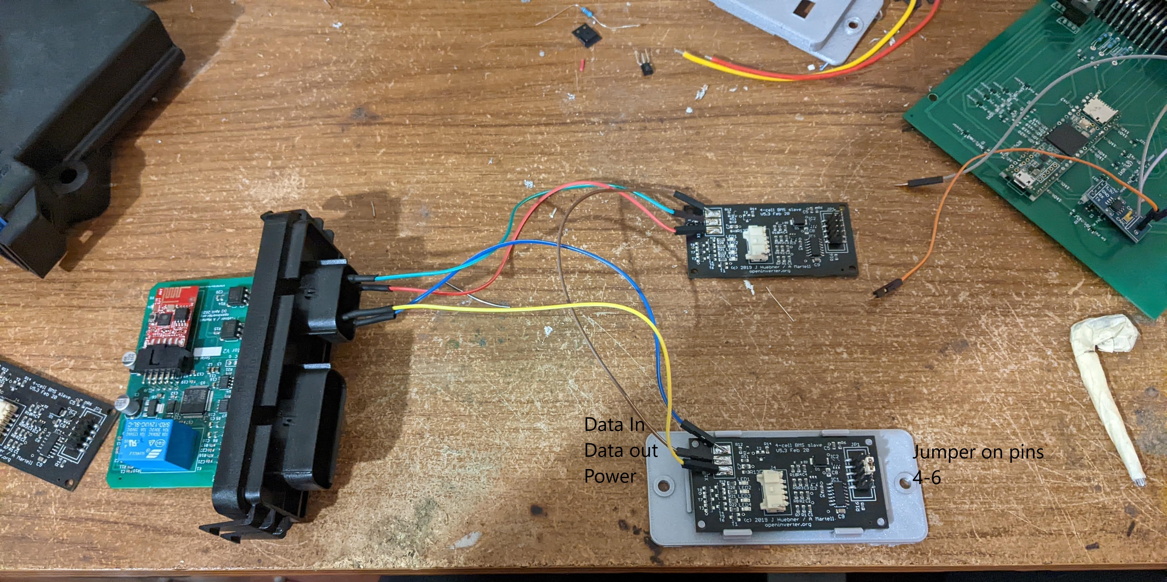

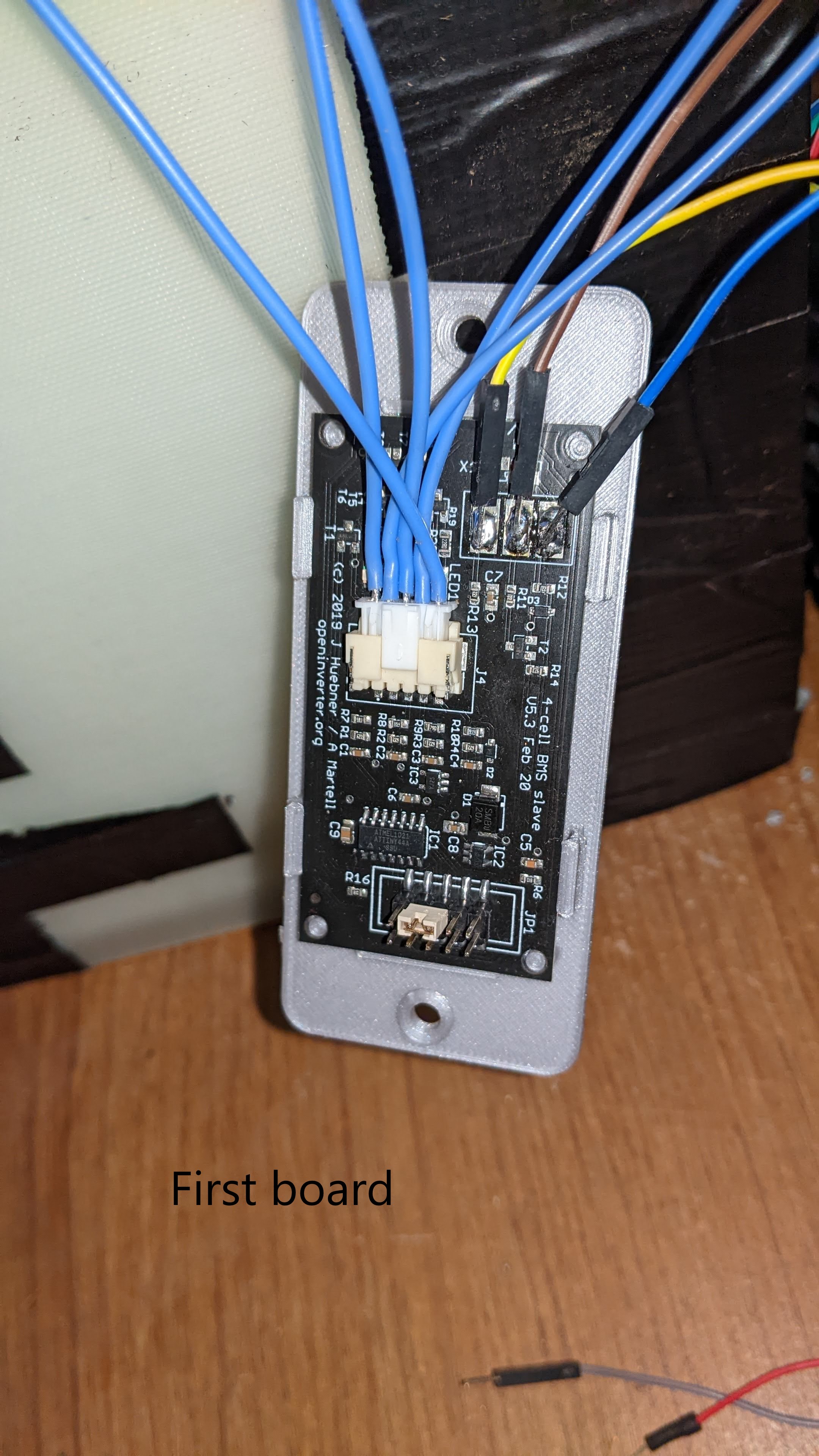

I have a couple slave modules on the workbench at home at the moment, just trying to get some initial communication and confirm that setup is all working. Is this the right Layout of the pins for the slave boards in terms of data in/out and power? Also wanted to check if the jumper pin was correct for first board selection. For some reason Kicad likes the isolator files but doesn't want to open the slave board files so I can't check the layout on there.
At the moment I don't get any communication, as in addresses don't get set. But I did have the jumper on the other board, just realised as I took the photo this might be incorrect and changed it for testing tomorrow.

Solved with the help of Marty.
For others, first board jumper needs to go here All other boards need a jumper here

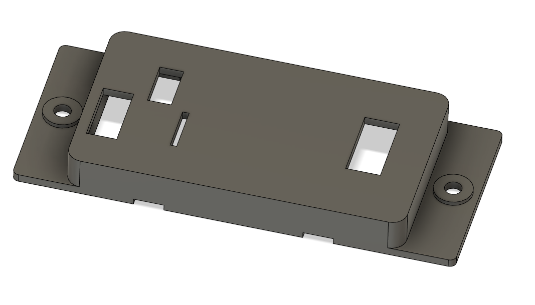

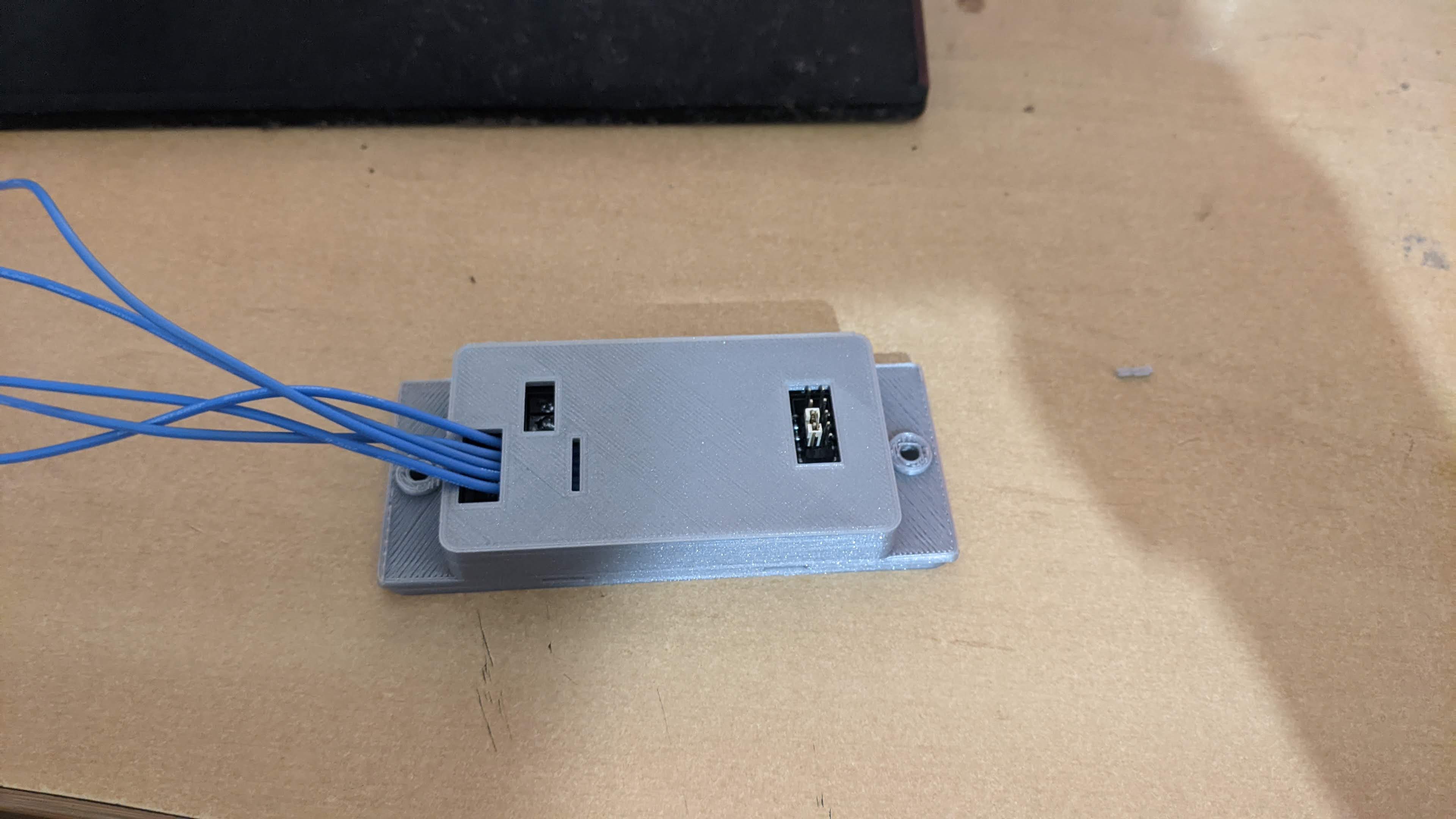

Made up a slightly modified cover for the slave boards to make room for the jumper pins sticking up in the latest revision. I also moved the cell tap outputs as my connector there comes out on an angle so I just needed some space for the wires to come out.
I'll print out a couple to test and once it fits well I'll upload the .step and .stl for others to modify to suit their setup.

Second version seems to fit fine. Attached is the stl file for printing and fusion file if you wanted to change it a little. Forums wouldn't let me upload a .step file but I can send them if anyone wants them.
It's not super polished but it does fit the jumper pins now. Clips onto the slave base file that sonachan1 made up, also attached as I couldn't find them on the thread again.

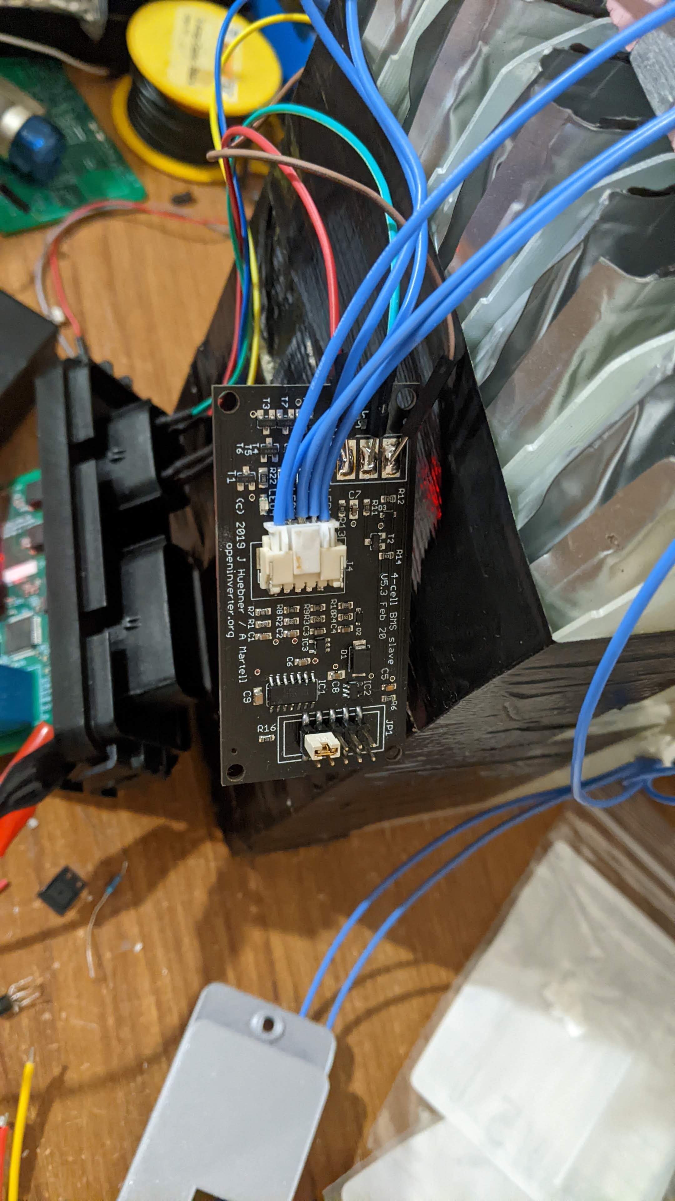

Re: 4-channel BMS with daisychain bus
Hi guys!
I've made some main boards and some slave boards
I've flashed firmware to the main board and wifi adapter, so i can see smth
i've done all calibration
when i connect two slaves to main - main sees only first slave module
when i connect three slaves to main - main sees only first slave module
when i connect four slaves - main stops at getversion , but shows in interface 3 slave modules
please give me a hand
what to check ??

Double check the slave boards are hooked up the correct way around. The first slave boards needs to be on the most negative side of the battery from memory. Also try switching the polarity of the data and power lines from the slave boards to the main board. One of those is labelled incorrectly.wacomg wrote: ↑Sat Mar 26, 2022 3:17 pm Hi guys!

1. will post pictures in 10-15 hours
2. i do not think it matters but will check it
3. I've switched the polarity of input on main board ( because without it it's not working at all )
