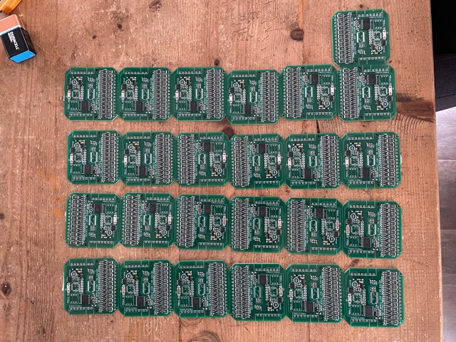

I have finalized the order for a first batch of 25 units BMS12 (without the 3D printed housing but STL file is available).
Prices wil be around 50 - 60 euro per 12 channel module.
If anyone is interested let me know.

First batch of BMS12v3 arrived from JLCPCB today.
The missing parts should arrive this week also so they can be completed and tested/programmed next week.

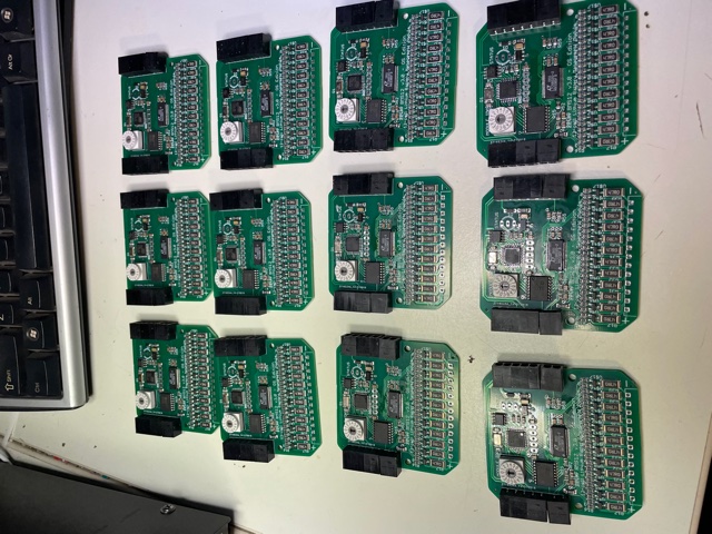

prensel
- Posts: 130
- Joined: Mon Nov 25, 2019 1:36 pm
- Location: Dreumel (NL)
- Been thanked: 4 times
Re: ZEVA has gone "open sorce"
Ready to go (almost) !
I have about 12 boards ready to be programmed.

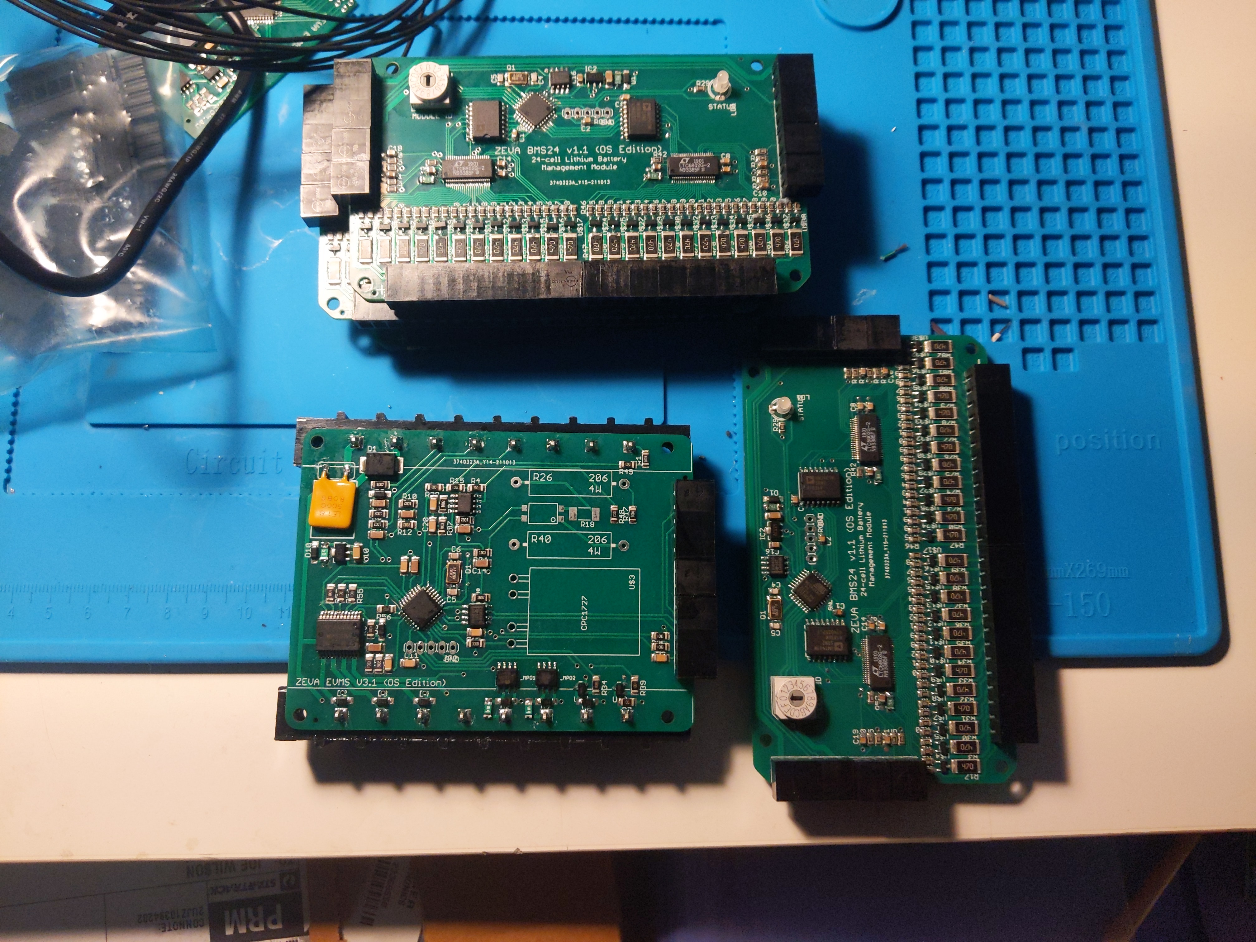

Dusty4
- Posts: 85
- Joined: Tue Dec 25, 2018 12:41 pm
- Location: Western Australia
- Has thanked: 11 times
- Been thanked: 9 times
Cool, I have ended up having a go myself, I have made the bms24s. I am hoping to test in the next few weeks.

Dusty4
- Posts: 85
I had them made at jlcpcb, I then sourced the rest from Digi-Key, mouser and eBay.
