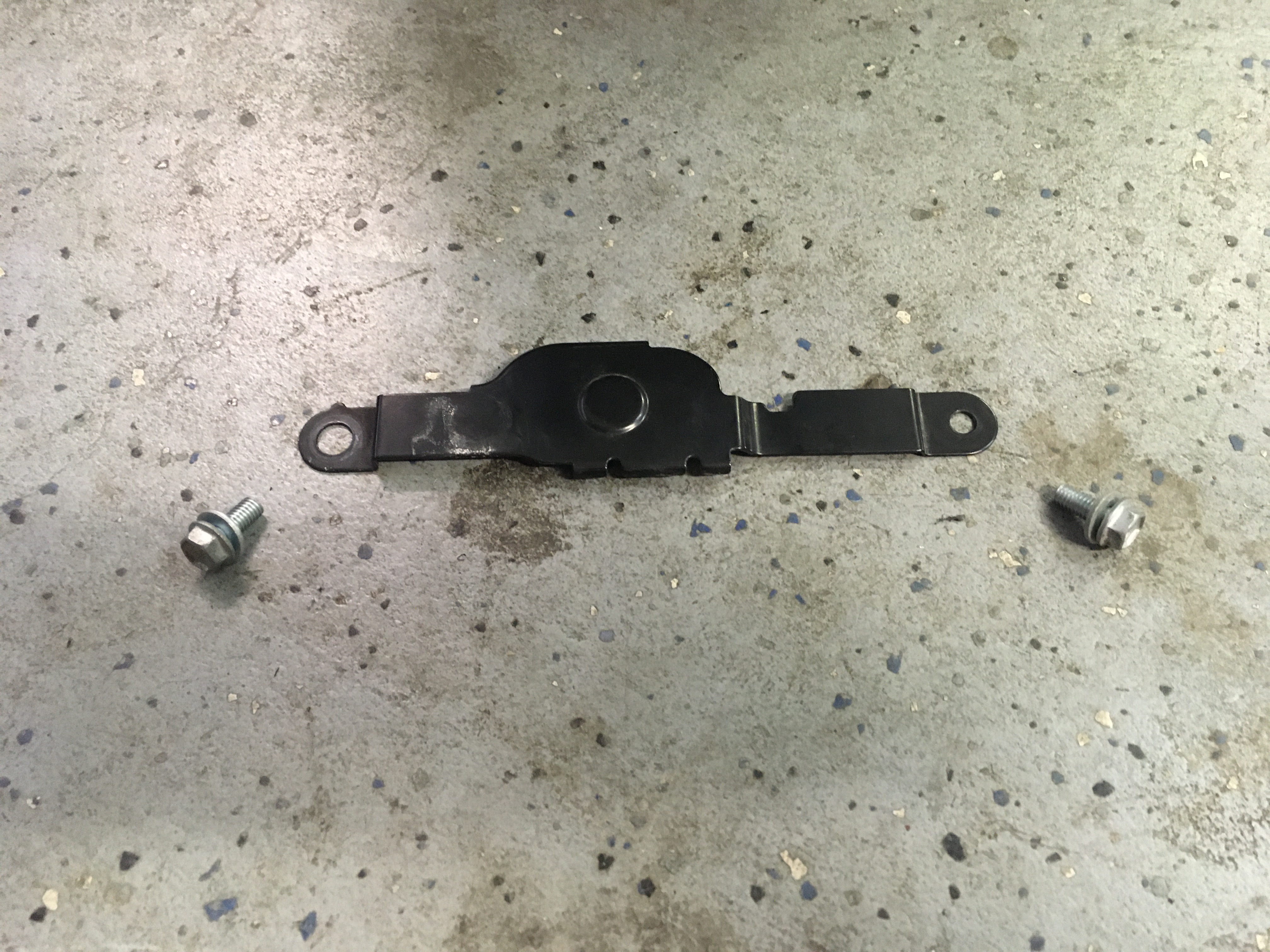

and removing the glued on plastic underneath that black metal strip required my level of precision

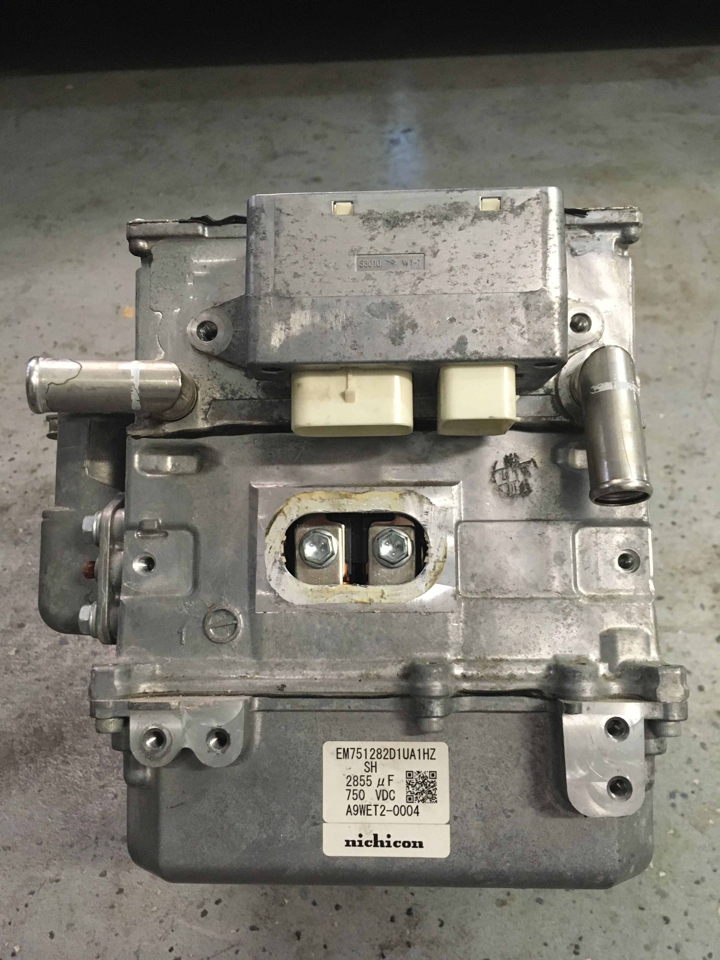

I decided to labelize ("Add" and "Subtract") these bus bar thingies as Damien likes to flip the Inverter upside down from time to time to make things interesting in his videos, this is where we will connect our electron hoses later on

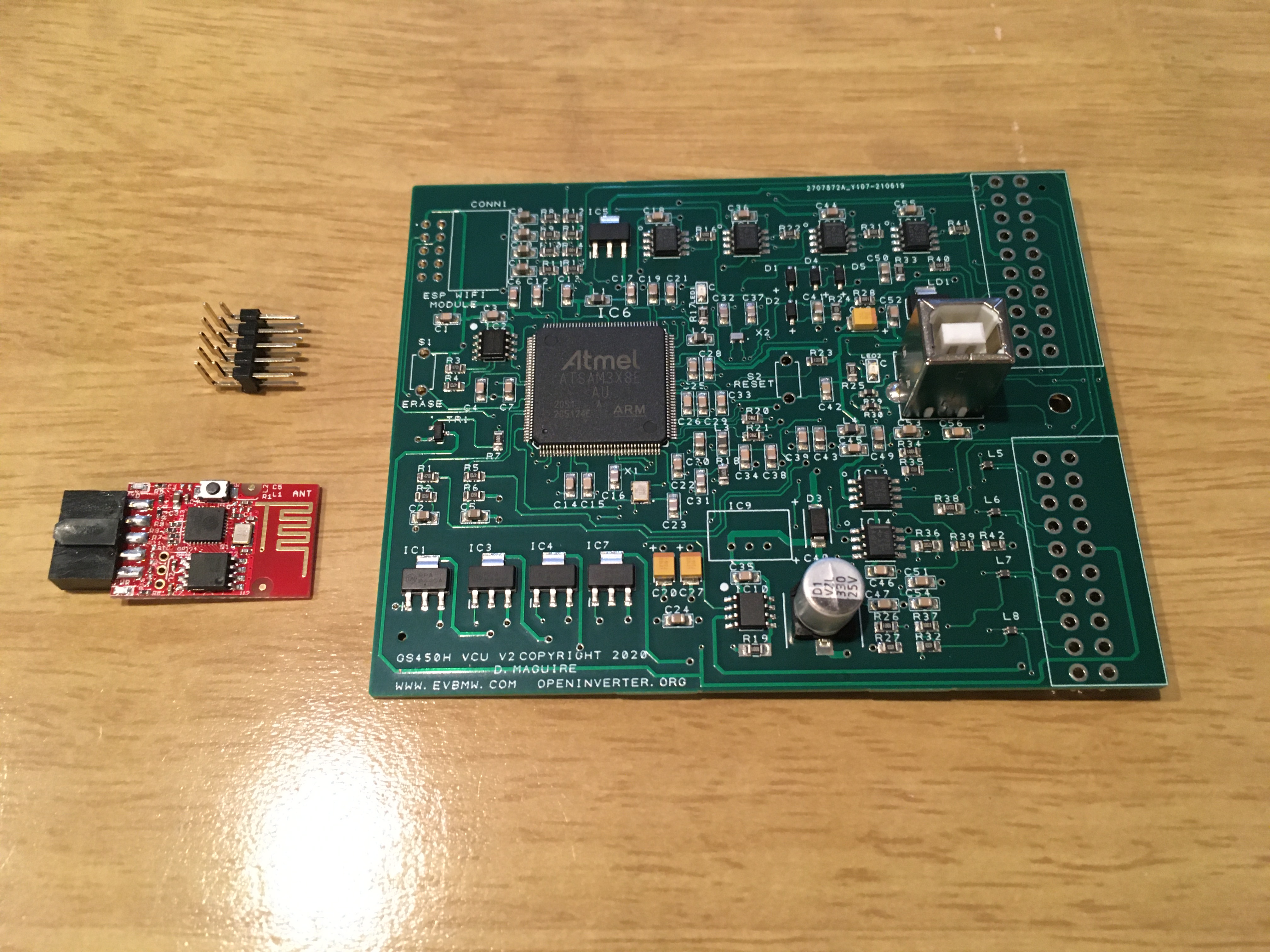

So this is what I was expecting... the pic is a bit misleading as it pictures the 40 pin connector header thingie, yet on his website it states "Enclosure and connectors NOT supplied." again absolutely no complaint here just an observation and a clarification for anyone following along, that's all.

and this is what I got...
I do realize there is a parts/components shortage, this is more of an "observe and report" than a rant or a complaint, I am truly grateful to have gotten anything at all considering the circumstances, I am also very happy to see that he already soldered on the USB port for me
Missing is only the small black 5 volt switch mode regulator
FYI the shipping from Ireland to California took exactly precisely 2 weeks to the day

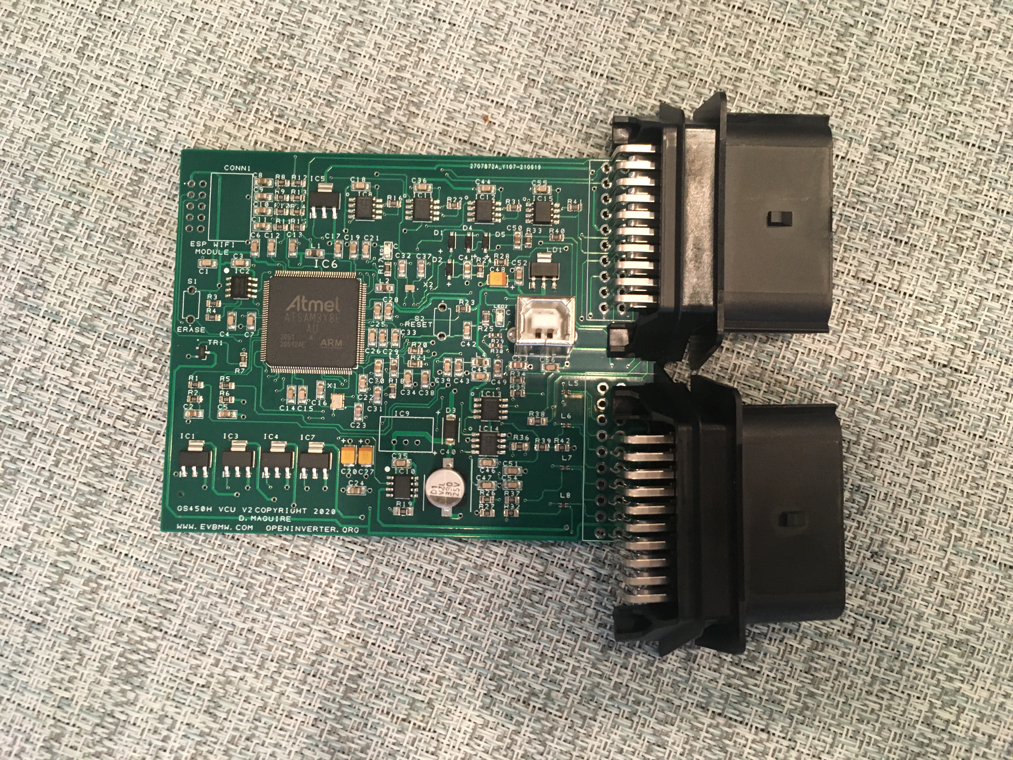

with the electronics parts shortage, I had to find an alternative to the Cinch 40 pin connector and I gotta admit I now know way more about connector pitches and number of pins and pin positions and rows than I care to admit, ha ha
Meet "Mo" short for Molex, part number 348302001 this is that original 40 pin header's long lost cousin, on it's mother's side, so it still takes the same 33472-2001 plugs believe it or not

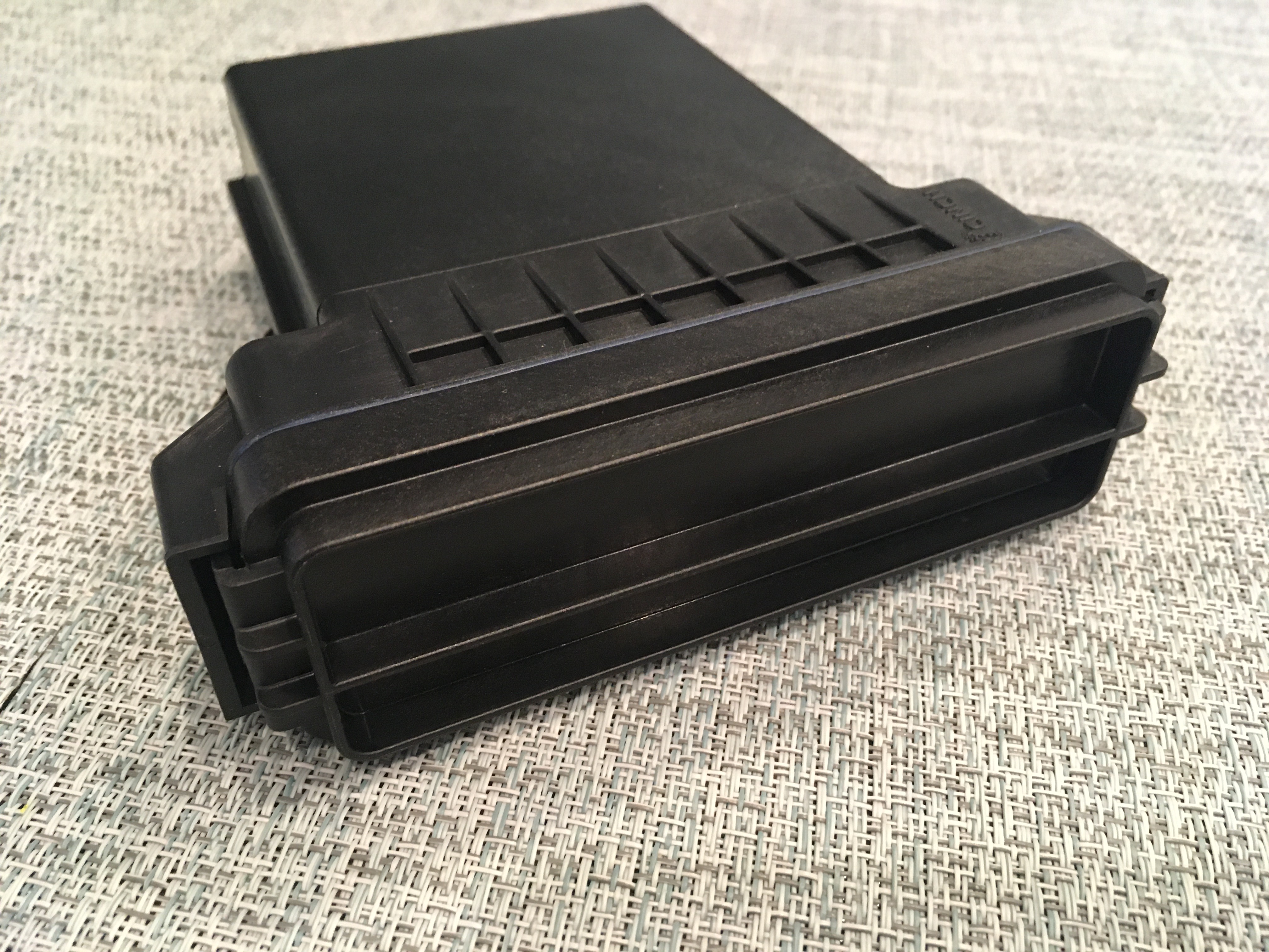

isn't this the most inefficient and wasteful packaging ever?

so the first thing I checked was the plugulators, and quickly realized HUSTON We Have A Problem
the gray plug seems to be keyed slightly different and won't go over the 20 pin connector, the black one matches it perfectly
