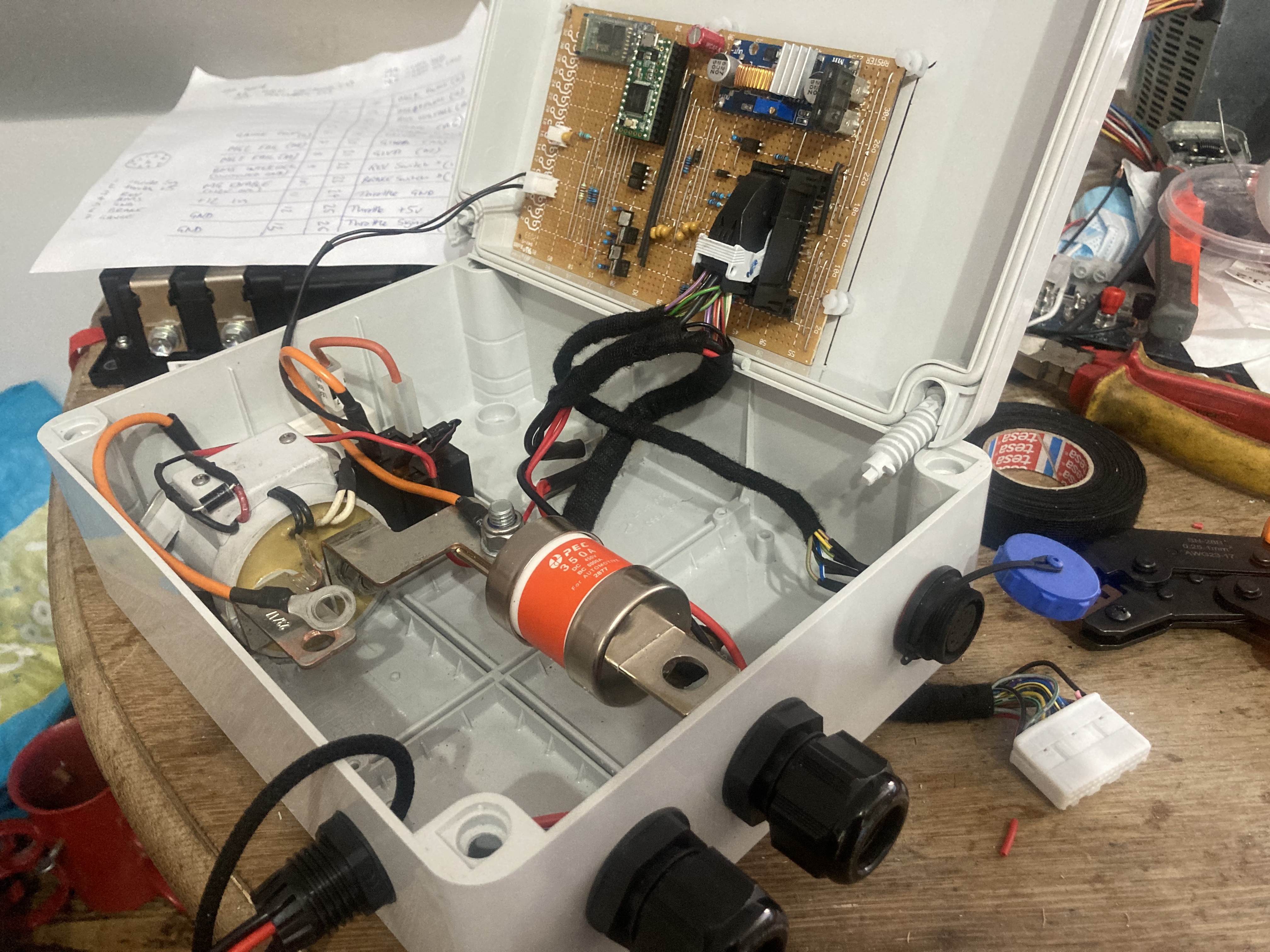

It’s really quite a simple board, it’s perf Board, there is a 5v power supply, a teensy 3.2, some digital inputs that are opto, isolated, some analog inputs scaled with appropriate voltage dividers and some low side outputs that are driven by logic level mosfets, I worked out the resistor values for the voltage dividers to scale the inputs based on info from the gen2 adapter board thread and on my own tests from sensors etc, to scale to an appropriate 0-3.3v value,
But no I didn’t draw a schematic it’s that simple I built it as I went from my head and a few notes, I just built it straight to perf board,

Ev8 wrote: Mon Oct 18, 2021 8:52 pm It’s really quite a simple board, it’s perf Board, there is a 5v power supply, a teensy 3.2, some digital inputs that are opto, isolated, some analog inputs scaled with appropriate voltage dividers and some low side outputs that are driven by logic level mosfets, I worked out the resistor values for the voltage dividers to scale the inputs based on info from the gen2 adapter board thread and on my own tests from sensors etc, to scale to an appropriate 0-3.3v value,
Hey a couple of questions...
The board you are showing is in a housing, but that is not the Prius inverter.. correct?
How does the Inverter interface to this board?
Do you have to make any other Mods besides putting all the IGBTs in parallel?
thanks vey interested in this..

The white plug in the picture plugs into the main inverter brick in the gen2 inverter

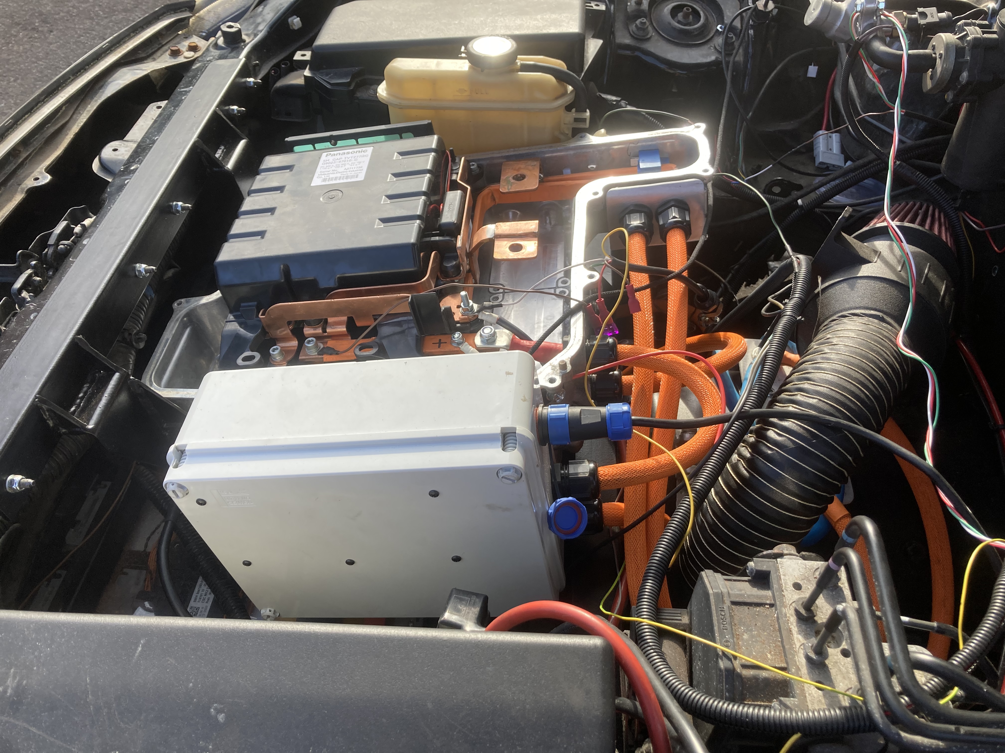

I put together a Teensy based Prius Gen 2 Inverter control box based on your box design.
I modified my inverter by removing the booster bits and tied the two output buses together.
I modified the Teensy code a bit. Changed low battery value, commented out BMS stuff (I don't have one). Also took out pre-charge test (already have one), took out temperature control (also done externally).
I attached PIN 20 and 25 to 12 V and all the other inputs from the Teensy to the 32 pin connector.
I also took out your Serial1 device control. All serial prints to to Arduino Serial Port.
Added many print statements to follow the values of all the pertinent internal items.
Got it all running except NO output to the motor. Using all six output lines. All have continuity to + Motor terminal and with each other and the tied internal output bus.
Tested accelerator. Teensy sees throttle at rest with .41 v and 2.68v full throttle.
Motor does not turn.
So, before dumping a ton of debug statements captured during this test, and since I have never seen any electricity come from this unit ever, with multiple different control devices attached, it seems to me that I should do a basic "can it really do it" test on the prius unit. If I can determine the prius unit is bad, I can get another and test it also. If I have done something wrong (probably), I can fix it. And I can add more debug data if need be. I'll post my debug output if you see fit.

Hard to see from your pictures exactly how your hv inverter wiring is done, you should have battery positive and negative present at the inverter brick inputs, battery neg also connects to motor neg, and motor pos connects to phase outputs,
Maybe post a copy of your modified code? And maybe a screen shot of your serial monitor in run mode, do you get a forward or Reverse status?

What does your “throttle PWR actual” read when you press the throttle if this changes from 0 then you are making pwm, does your teensy pwm 4 trigger a logic level fet that drives all of the inverter pwm pins low?
Also why remove the inverter temperature part of the code? This gives you on chip monitoring of the igbt temperature rather than just cooling water temperature.
