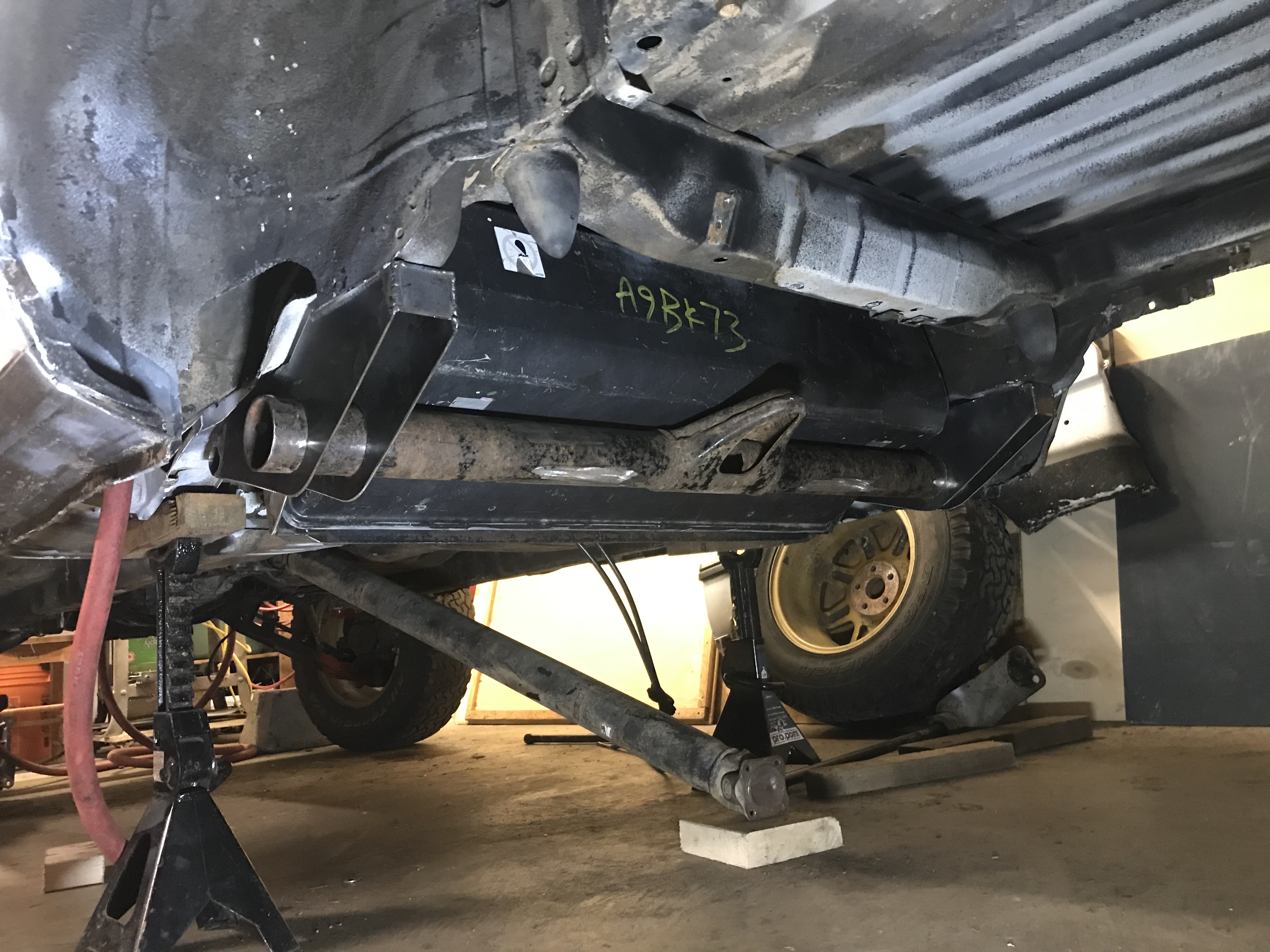

Life has been busy, but got first full fitment of batteries in. The T section of the Gen2 Chevy volt battery tray was cut off and I welded up a frame which bolts up underneath the bed of the brat.
Had to increase the rear subframe/torsion tube to a 4in lift. As in the middle of the crossmember is the torsion bar adjuster. I picked up a very rusty parts car, which came with 2 rear suspension clips. so later down the line I’ll remake the entire cross member so the torsion adjuster is out of the way, with out significant lift blocks. (Which will get linkd)
A few more brackets to make and the battery will be fully supported. Temporary ratchet strap loopd across to reduce cantilever forces...
New crossmember gives me the added bonus of increasing the trailing arms by 3-4in. just like vw baja bugs!
the other section of the battery tray was modified to bolt in to a series of points behind the the seats in the cab.
there was just enough space to make one long batter module fit here.
So that opens up space for another 3.1 kw module in the rear hanging tray. so on the hunt for a second pack :)

finishing up the modifications to the rear torsion spring crossmember. The new brackets provide a additional mount point for the battery tray. And moves the crossmember 2in towards the front of the car, and 2in down. Resulting in the rear battery weight loaded onto the suspension, rather than threw the chassis.
The crossmember relocation also accommodates the longer/wider trailing arms.
