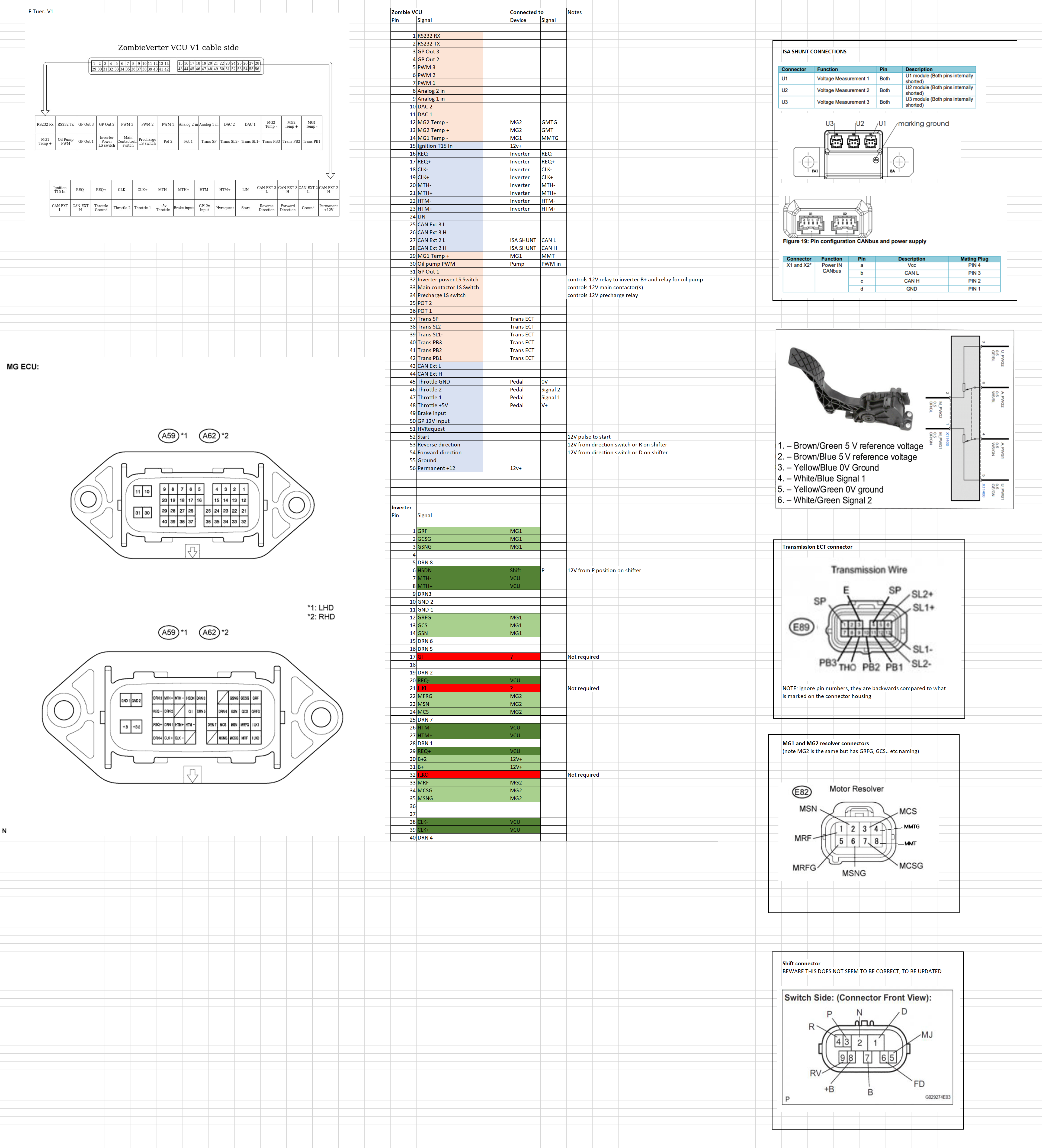

Here's a list of connections and where they go to, or at least my best guesses. I've added it to the wiki since it's better than nothing, but will update as I learn of further errors.

et0 wrote: Thu Oct 14, 2021 4:23 pm Here's a list of connections and where they go to, or at least my best guesses. I've added it to the wiki since it's better than nothing, but will update as I learn of further errors.
This is great! Hope that the other connections can be filled in soon, along with maybe some definitions of the abbreviations, and for what purpose the others may be used.

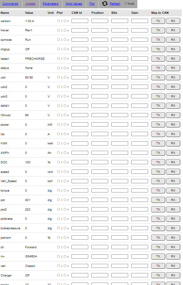

OK, the tweezer trick worked. Assuming that's the reset line for the STM, I might solder a button on there.
And the shunt appears to be programmed (it's reporting udc at least), and the VCU seems to be back to life.
Problems I'm having:
1) InverterPowerLSSW does not pull in the relay to turn on the inverter, so I bypassed it for now. Can hear the relay buzzing slightly.
2) tmpm was 6400, which produced an error. I zeroed it out in the code, and the error has gone, but that seems like an issue.
3) Now I have "run" and no error, forward selected etc, pot signal is good, 0.6A pulled from the HV supply but no sign of the motor turning.
4) no terminal still
What should I look at next to get the motor spinning please?

Please don't bypass components like that. If the relay does not turn on its for a reason. What motor/inverter setup are you using? Are you seeing UDC at the correct voltage? have you set udcsw and udcmin to sane values and calibrated the throttle? Is there a direction selected and T15 on? I feel the need for a setup video ...

Lexus GS450h as far as I know.
Inverter number G9200-30030 A06K06Y023
Can't see a number on the transmission.
Yes, UDC is showing 65V after starting, so is INVudc. udcsw is set to 45 as is udcmin.
Yes I have calibrated the throttle (set min just below the lowest value and max just above the highest value) and can see the pot input moving correctly.
As I said, Forward is selected (and showing on the GUI) and T15 is on. Start has been triggered and pre-charge happened OK.
All this can be seen on the screenshot I think?

It's been a bit since I messed about with the lexus stuff but sounds like you are good to go. Data exchange is happening with the inverter. 65v is more then enough to spin up the motors. What is invstat parameter? When you press throttle is potnom and torque registering a change?
