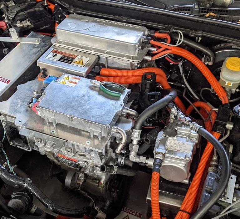

I found a Chineese supplier on Aliexpress that sold 3kW CAN controlled chargers with DC voltage limit at 420Vdc.
I bought one to try it and figure how to implement CAN control for three such chargers. I need them to charger my 104S battery.
That is charger module meant to be installed into racks where it has cooling and command infrastructure prepared.
CAN control is completely the same as Volvo chargers, with difference in telegram response time. Even data rate is the same at 500kbps. Only instead of command msg at 800ms this charger works with 02FF telegram at 100ms rate.
My intention was originaly to get two of the same chargers and reprogram them to work from different phases at parallel output.
I would have liked to make a central plate where both chargers would bolt to. Inside that plate i would drill channels for cooling and plug most of them. Finally i would cover the whole assembly with formed alu cover to seal it from the outside. I would get 2x 3kW chargers from 2 phases.
In the end my first Volvo charger failed and i decided to install this unit into its housing.
I had to get the housing trimmed down to install additional 10mm plate as thermal interface.
Now it looks almost identical to original Volvo charger and it didnt require complex drilling and sealing.

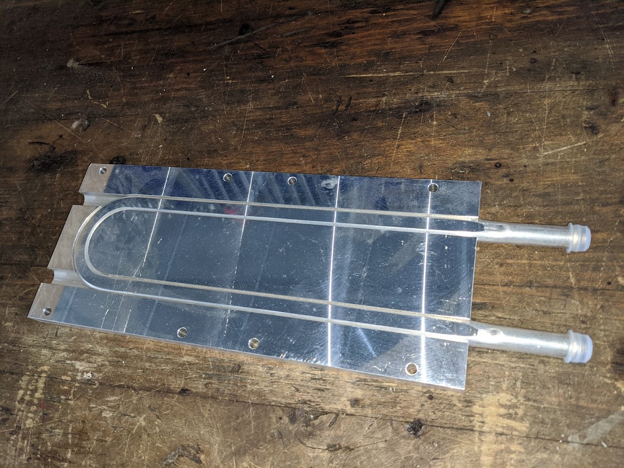

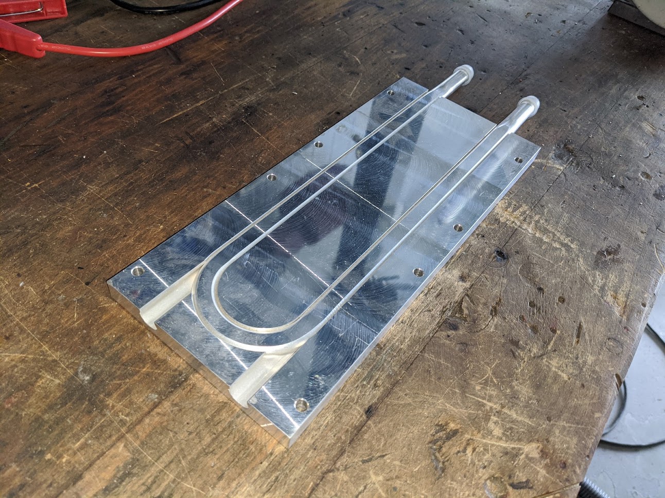

Re: Eltek/Volvo charger

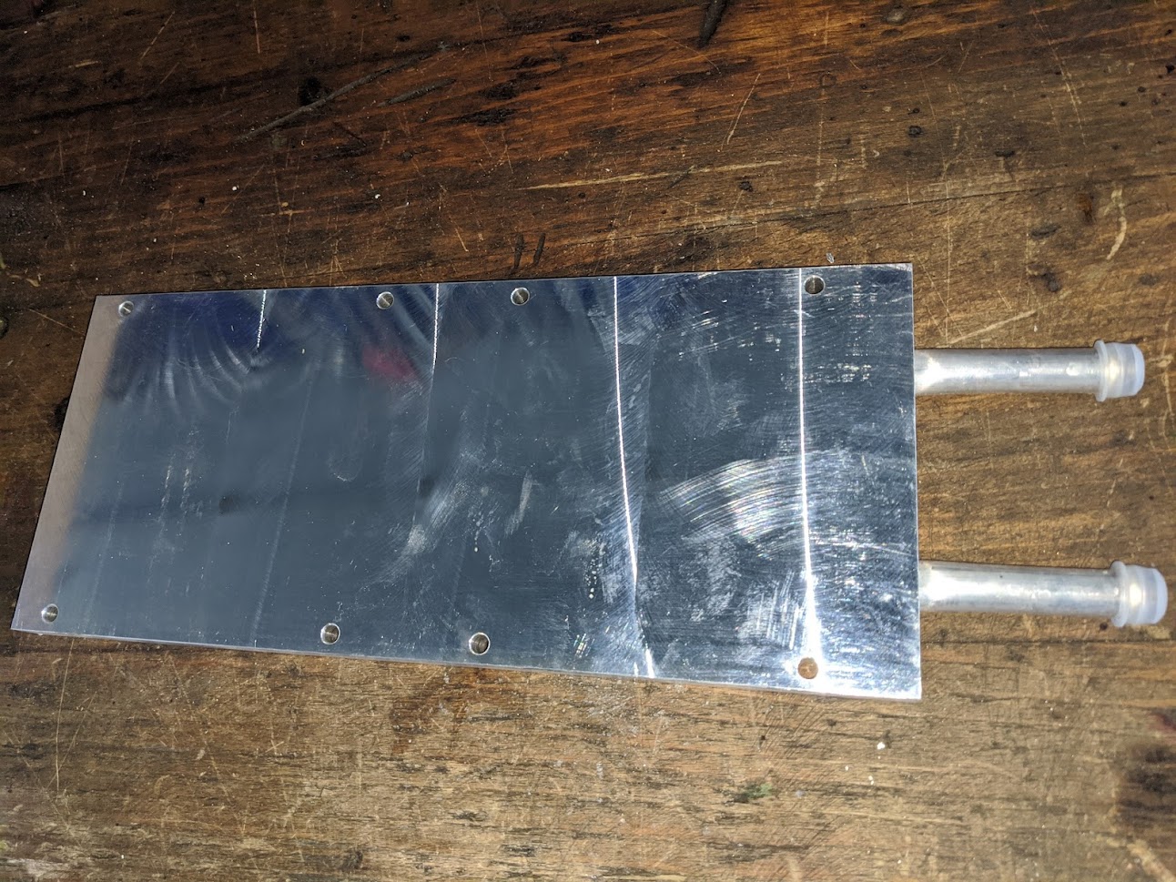

Just in case anyone is interested - i've got one left over water cooling plate for these chargers! If interested PM me
I'm using two of these 3 Kw Chargers on 2 phases, works perfectly fine.

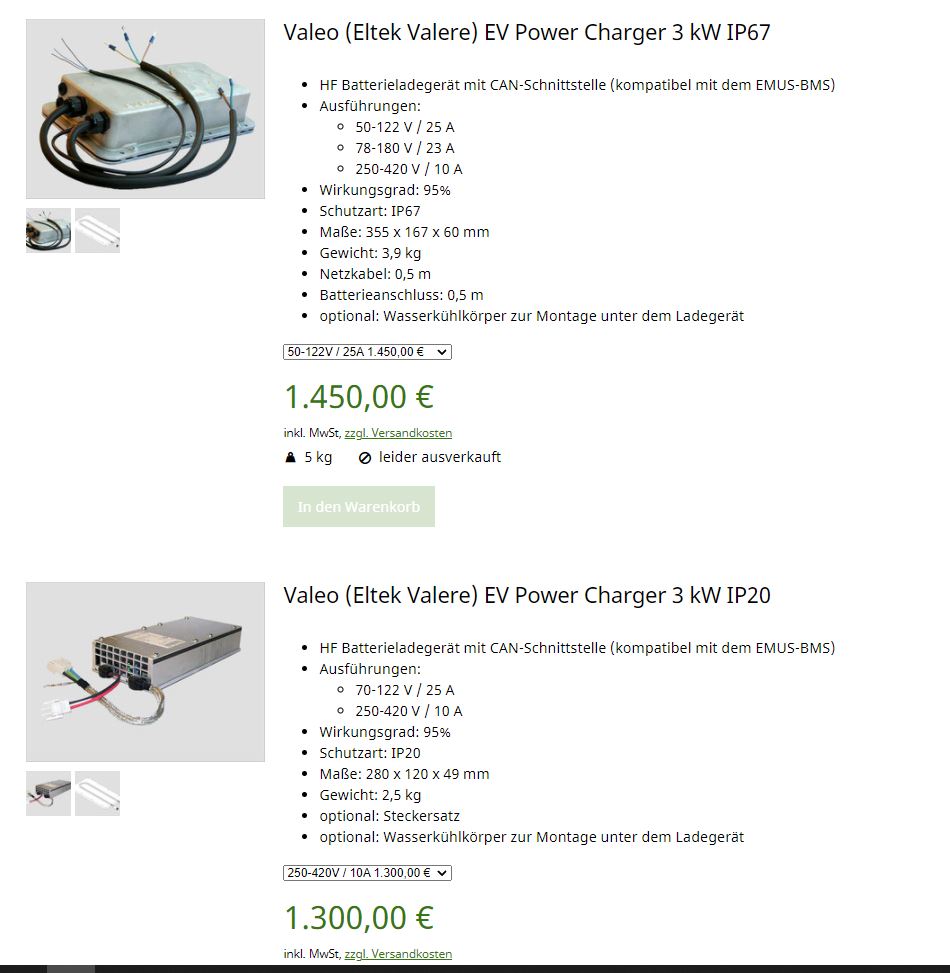

The cooling plate is designed for the IP20 charger, i'm using it with the IP67 charger anyways, just squeezed it inbetween my 2 chargers
I ordered the last 2 available ones from EV Europe but only used one. One of them was 125โฌ.
My Chargers are Eltek Valere, i'm charging with 2 phases 6 Kw per hour.
IP20 vs IP67 - technically exactly the same charger, the IP67 though has the better housing in my opinion

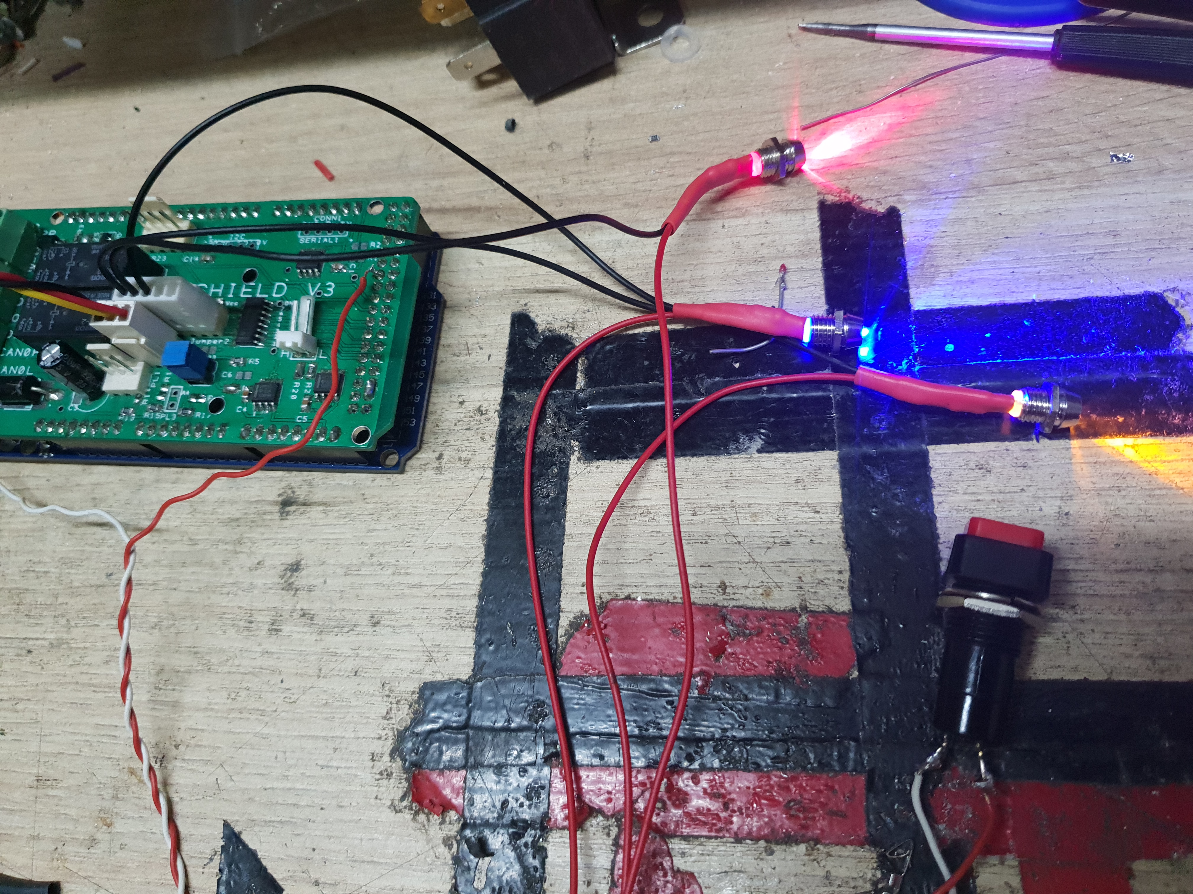

I have researched a flag operation within my DUE so i can use a single button and toggle between chargers.
I have 3x Eltek chargers wired 3phase in star circuit with common neutral. Each can pull 3kW from its phase. Now in my house i have various loads distributed between phases. To avoid overloading my system i decided to make a loop in my DUE code that will allow me to toggle between chargers with a single button. This will only take one input pin and toggle between 3 CAN addresses in any ombination.
CheckButton function is used with flags
I also added three LEDs to signify each charger channel and provide visual UI.
I coded them to transistor pins of the ULN2003 chip so DUE provides pulldown and 12V is connected to each LED.
When i push the button it changes state and switches to the next case. Thus i can toggle between various combinations of 3 chargers and LEDs show me which chargers are lit. The green button is there for DUE reset.
//Charger flags
bool Charger1 = false; //flag for charger1
bool Charger2 = false; //flag for charger2
bool Charger3 = false; //flag for charger3
//Then i call function
checkButton();
Now function i declare with all options and debouncing
void checkButton()
buttonState = digitalRead(button);
if (lastButtonState != buttonState)
lastButtonState = buttonState;
//has the button been released (HIGH is not pushed)
if (buttonState == HIGH)
buttonCounter++;
if (buttonCounter == 1) {
Charger1 = true;
Charger2 = false;
Charger3 = false;
else if (buttonCounter == 2) {
Charger1 = false;
Charger2 = true;
Charger3 = false;
else if (buttonCounter == 3) {
Charger1 = false;
Charger2 = false;
Charger3 = true;
else if (buttonCounter == 4) {
Charger1 = true;
Charger2 = true;
Charger3 = false;
else if (buttonCounter == 5) {
Charger1 = false;
Charger2 = true;
Charger3 = true;
else if (buttonCounter == 6)
Charger1 = true;
Charger2 = false;
Charger3 = true;
else
buttonCounter = 0;
Charger1 = true;
Charger2 = true;
Charger3 = true;
//Now i can see all combinations and toggle code for CAN bus telegram
if(digitalRead(PP_pin) == LOW) { // if PP_pin senses EVSE
digitalWrite(PP_relay,HIGH); // turn on Cp_relay
if(millis()-lastime > myVars.transmitime) //Nominally set for 120ms - do stuff on 120 ms non-interrupt clock
if(Charger1 == true){
lastime=millis();
sendCANframeA();
printstatus();
digitalWrite(LED1_pin, HIGH);
else {
digitalWrite(LED1_pin, LOW);
if(Charger2 == true){
lastime=millis();
sendCANframeB();
printstatus();
digitalWrite(LED2_pin, HIGH);
else {
digitalWrite(LED2_pin, LOW);
if(Charger3 == true){
lastime=millis();
sendCANframeC();
printstatus();
digitalWrite(LED3_pin, HIGH);
else {
digitalWrite(LED3_pin, LOW);
else {
digitalWrite(PP_relay,LOW); // turn off PP_relay
} I coded them to transistor pins of the ULN2003 chip so DUE provides pulldown and 12V is connected to each LED.
