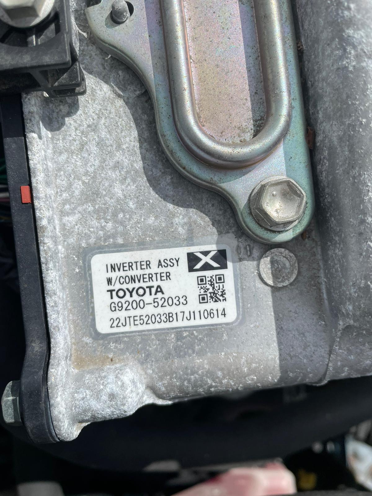

As the UK Government will not fund any fuel cell vehicle applications other than by OEMs, we decided to build a fuel cell powered 2cv to drive to Cop26. The fuel cell stack will be 3.5kW built by us from our own designed and fabricated alkaline fuel cells. They will charge a battery pack giving a range of 300 miles. The choice of a 2cv was that; we have one, it is ubiquitous, it’s fun, it demonstrates that any vehicle can be converted and it is a simple car. We invite anyone interested, wanting to learn more or wishing to contribute some time and knowledge, to join us. It is being assembled in France and will be driven to Paris, London and then Glasgow for the festivities. We want to embarrass the French and British Governments by showing that innovation is not dead and its not just their dinner pals who can accomplish serious change. The fuel cells will run on hydrogen produced from aluminium reactions and the total budget is 10,000 euros.
So our starting point was to blindly buy what looked like a cheap motor, a Meiden Y61 which is rated as 60 or 70kW (depending on source) and 400V AC. A lot hours on the the internet and watching of youtube revealed that it is from a Mitsubishi Outlander.
We set about trying to find an inverter which was in-expensive. We soon realised that the combination of cheap motor and inverter are difficult to come buy, it seems you get one cheaper and the one to control it costs more.
We went down the route of looking at industrial inverters and upgrading components, but the upgrades were as expensive if not more than an off the shelf industrial inverter which would have cost in the region of £5k.
It wasnt until we contacted EVBreakers and was inquiring about full drivetrains that they put us onto Damiens site EVBMW which lead us here. What a find!

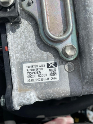

So, from the information we have read here, we have purchased a Toyota Auris/Yaris inverter from EVBreakers along with data and power cables for £180 including delivery.Image

Toyota Auris/Yaris Inverter
