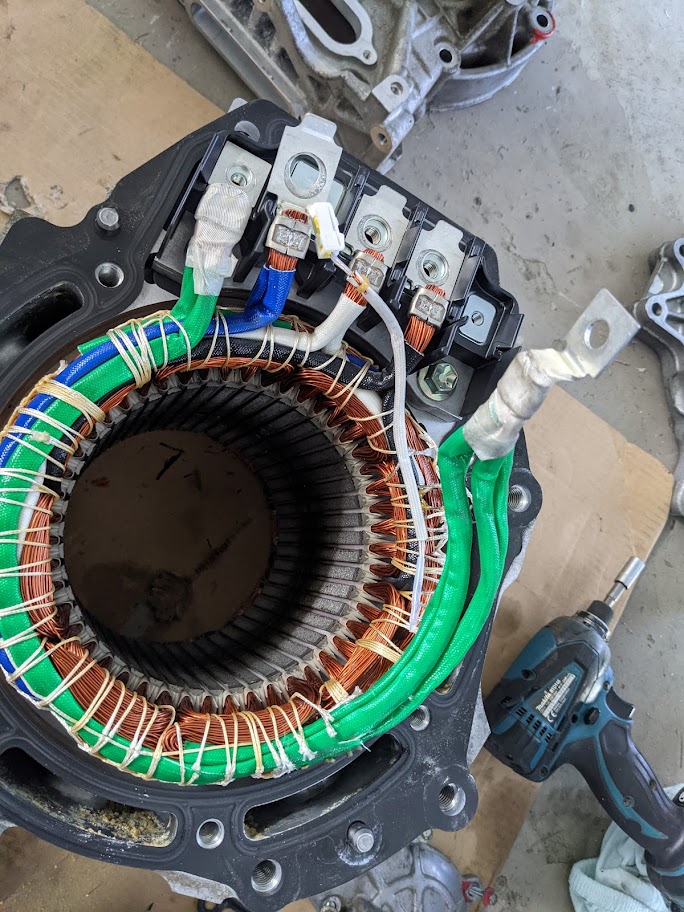

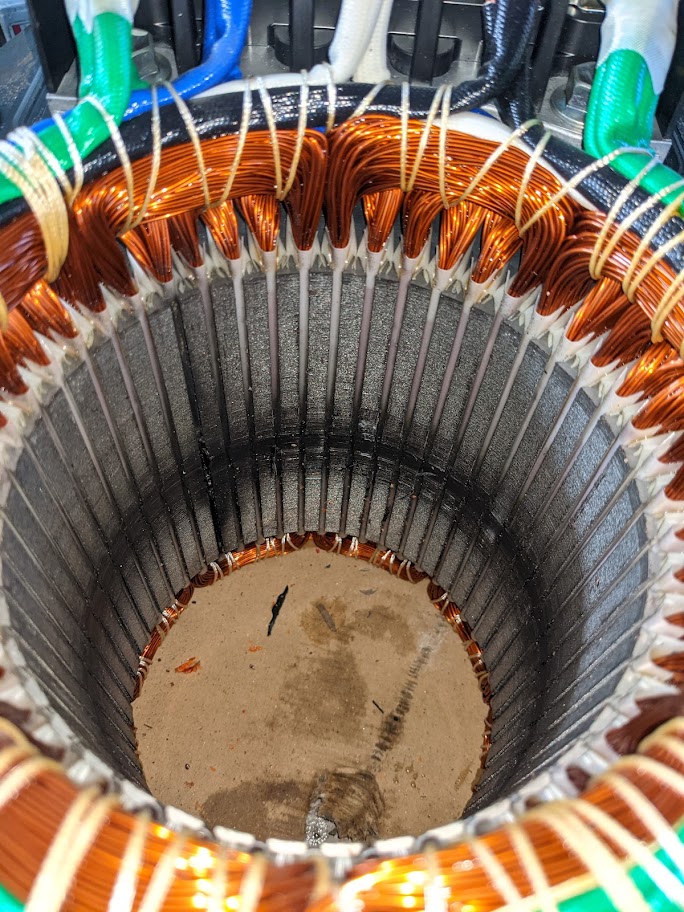

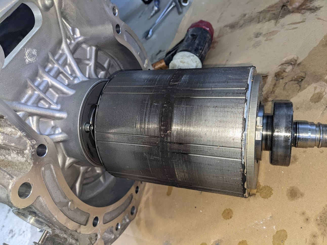

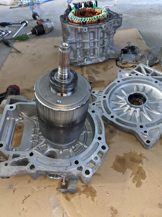

In the name of the science of all power thirsty poeple i sacrificed my motor. The good news are though that Johannes and me sucessfully found a way to increase the power of the leaf engine significantly. But the first software i tested didn't have the RPM limiter implemented and i thought: "What should happen? Just don't spin it too much".
But when tuning the parameters i played with syncadv to further increase the power in the upper RPMs, which i did sucessfully. But the way the pedal behaved was different from now on - it somehow barely reacted until i pressed it to approximately 2/3 of all the way and then it suddenly send a full throttle signal. I was stuck in traffic for a while then i had the most stupid idea: I pressed the pedal with no gear in over that certain point and the motor suddenly spun up all the way. It was a terrible noise and from then on it didn't work anymore.
I then started to look for the failure and found this:

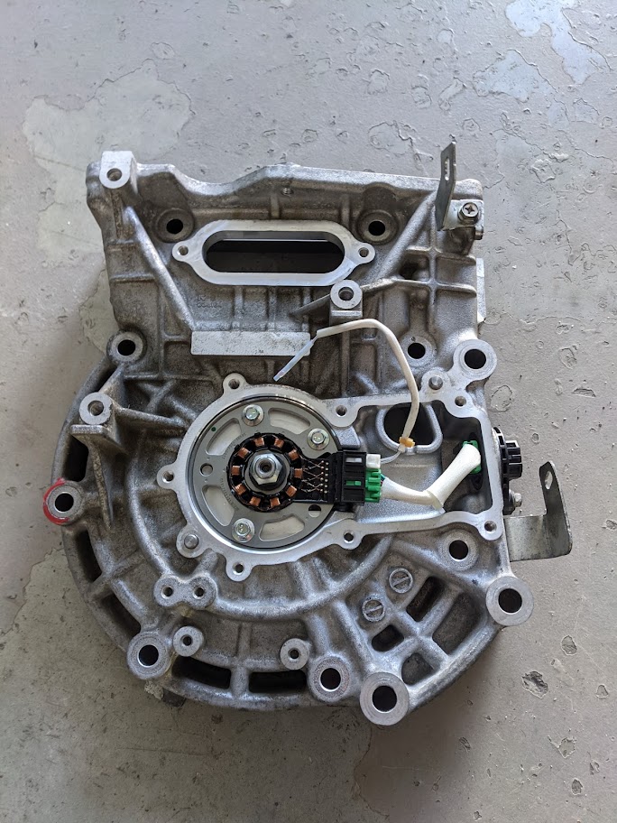

When overspinning the engine something must have broke and from then on i guess it was a chain reaction. It seems that the two halfes of the magnet have twisted a bit:
Now i've cut the shaft of the magnet and cut our the temperature sensor to send this to Johannes as a test bench for the resolver and the temp-sensor.
If you ever wanted to know where the temp sensor actually is located - it's on the rear end and not far into the motor:

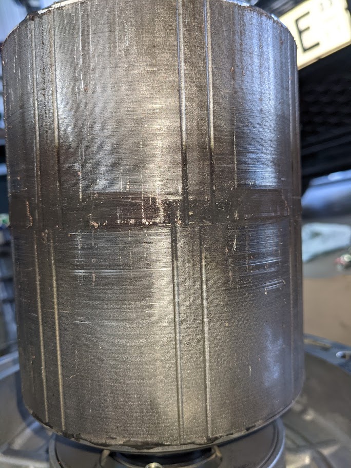

The offset shape on the rotor is normal.Zapatero wrote: ↑Fri Oct 01, 2021 10:38 am When overspinning the engine something must have broke and from then on i guess it was a chain reaction. It seems that the two halfes of the magnet have twisted a bit:

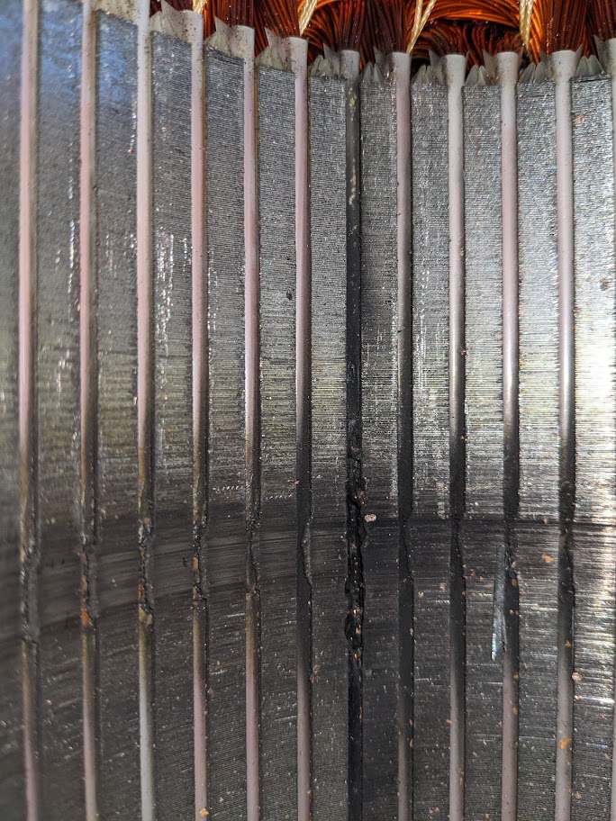

That rotor has contacted the stator - not normal! to do this it has either bent (unlikely) or the bearings have failed (more likely) The bearing looks a little blue - is this true of the photo?
Can you report the numbers on the bearings? and you can usually look up maximum RPM's.

De motor isn't supported in the middle, only on the extremes.
So if you go to really high rpm's you should see the mechanical forces pulling it out of the centre.
The middle is where it will bend like a chord and thats where it started to touch and self destruct...
RPM limit is a must on the same levels as amp limit.

The problem is the rotor; in the middle it will bend. 20.000rpm isn't nothing! You need to remove weight and make it stiffer for that.SuperV8 wrote: ↑Tue Oct 12, 2021 3:18 pm This is an interesting article regarding the Leaf motor and bearings.

I agree the rotor could bend - but there would need to be a large out of balance force applied, but also if this failure was due to a bending rotor (like a cord or skipping rope) I would also expect it to have only contacted the stator at one point and have a small/confined witness mark on the rotor - not all the war around.EV_Builder wrote: ↑Tue Oct 12, 2021 6:33 pmThe problem is the rotor; in the middle it will bend. 20.000rpm isn't nothing! You need to remove weight and make it stiffer for that.SuperV8 wrote: ↑Tue Oct 12, 2021 3:18 pm This is an interesting article regarding the Leaf motor and bearings.

The damage/witness mark on the rotor from the photos looks fairly circumferential to me which suggests either bearing failure or rotor diameter expansion due to high centrifugal forces.

What if, if we say the rotor bent, it then got some friction with the stator (obviously), and it started to roll along the stator like a wheel? That would make it get a circumferential mark.

exactly and if the material is softer then the one it touches the surface will increase. not saying the bearing liked this exercise but the play of the bearing would be always there...

The bearings where totally fine, no excess play at all. The rotor must have expanded in the middle.
