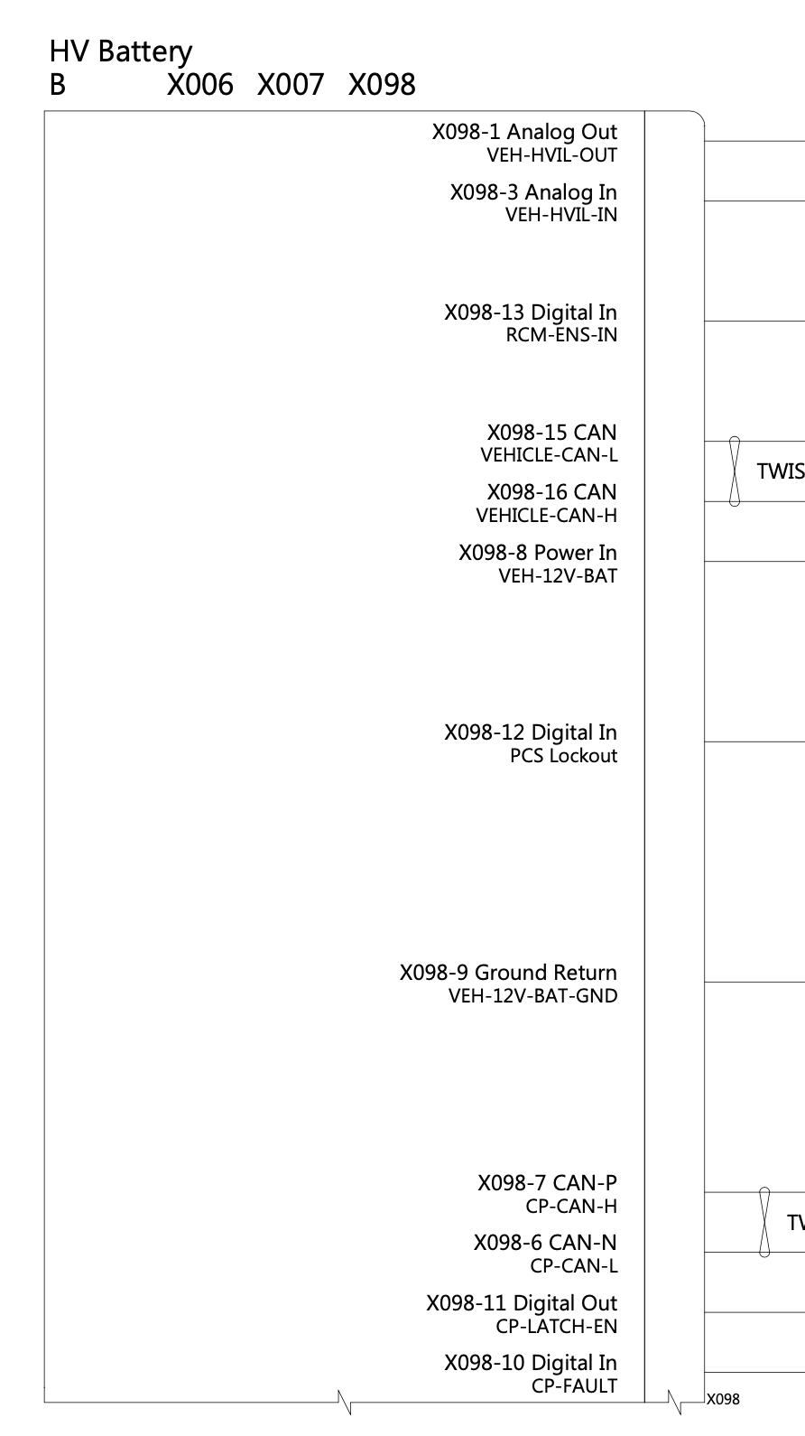

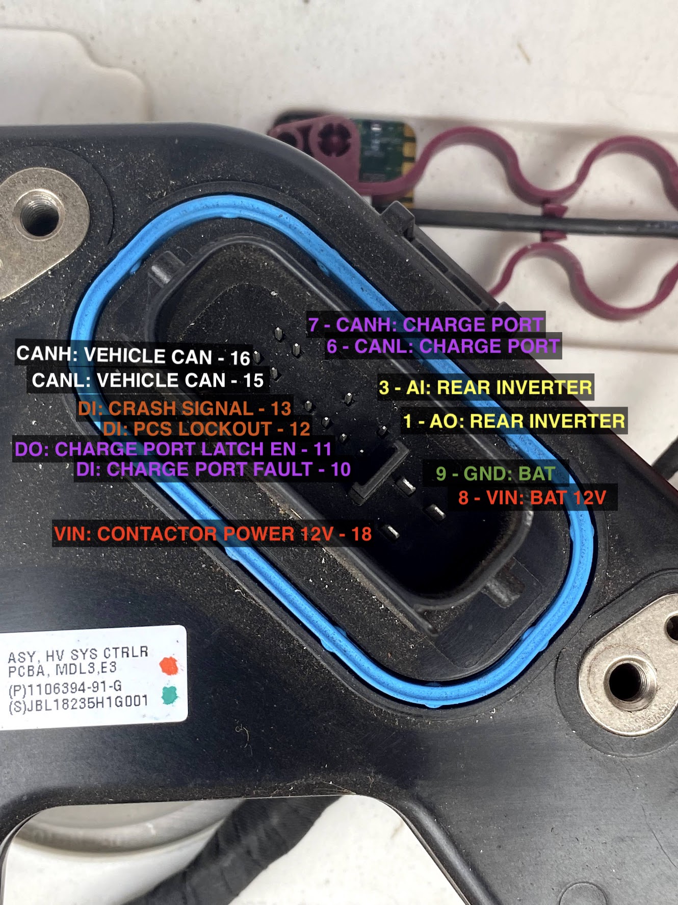

Full pinout attached. Check the PDF for full page of connected components.
2019.1_Model3-SOP3-1LHDandRHD copy.pdf- (107.13 KiB) Downloaded 1274 times

It seems like you're all reading data off the Charge Port CAN. Did I get my pinout wrong or is vehicle CAN not being used for monitoring values?

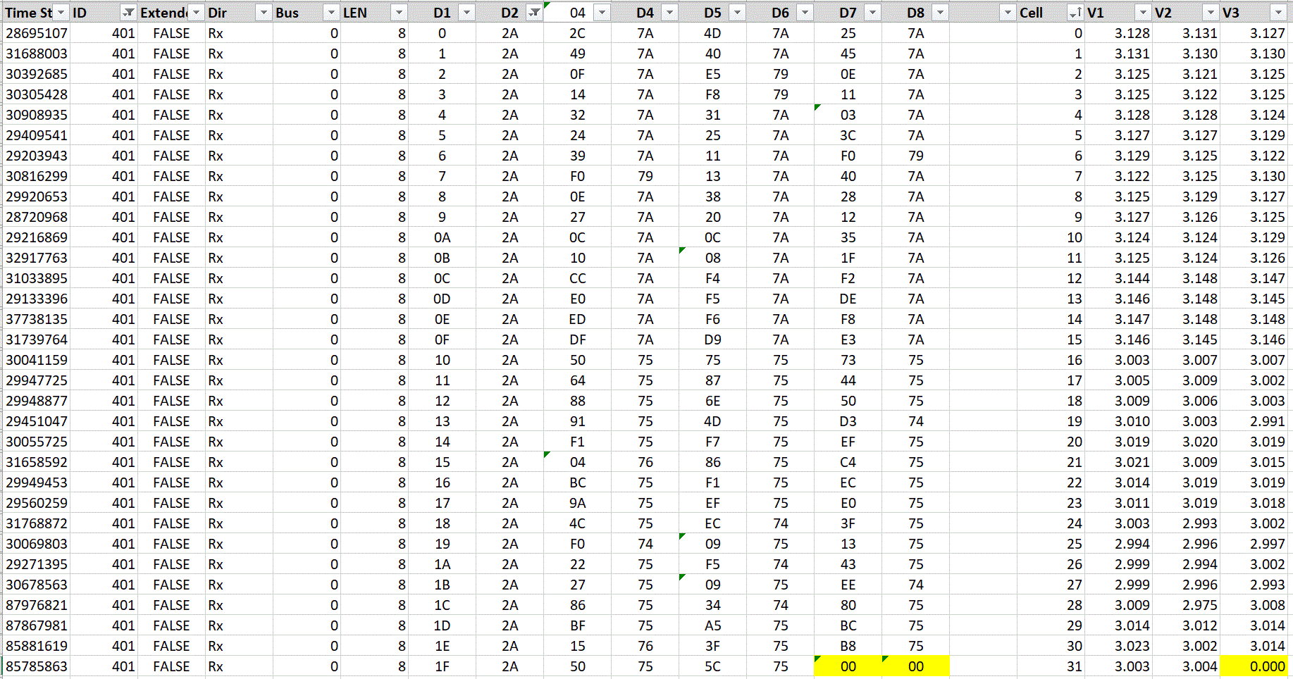

I've been using CAN ID's 292, 312, 332, 401 and 712 for now. They don't all show on any one CAN bus, so I've just been swapping between the CP and vehicle CAN as needed
Re: Model 3 High Voltage Controller
I am working on replicating the steps of getting voltage data from message 401 captures as shown in the example below and could use some help. Have read through everything here multiple times and have tried a few different ways. It is clearly described here how to do this with message 332 captures , but not for message 401. How exactly does one take the CAN message 401 and convert it to the 3 voltage readings. If anyone has a spreadsheet with the formulas that would be awesome, or just a written description of the process from hex to binary to decimal to voltage, thanks.

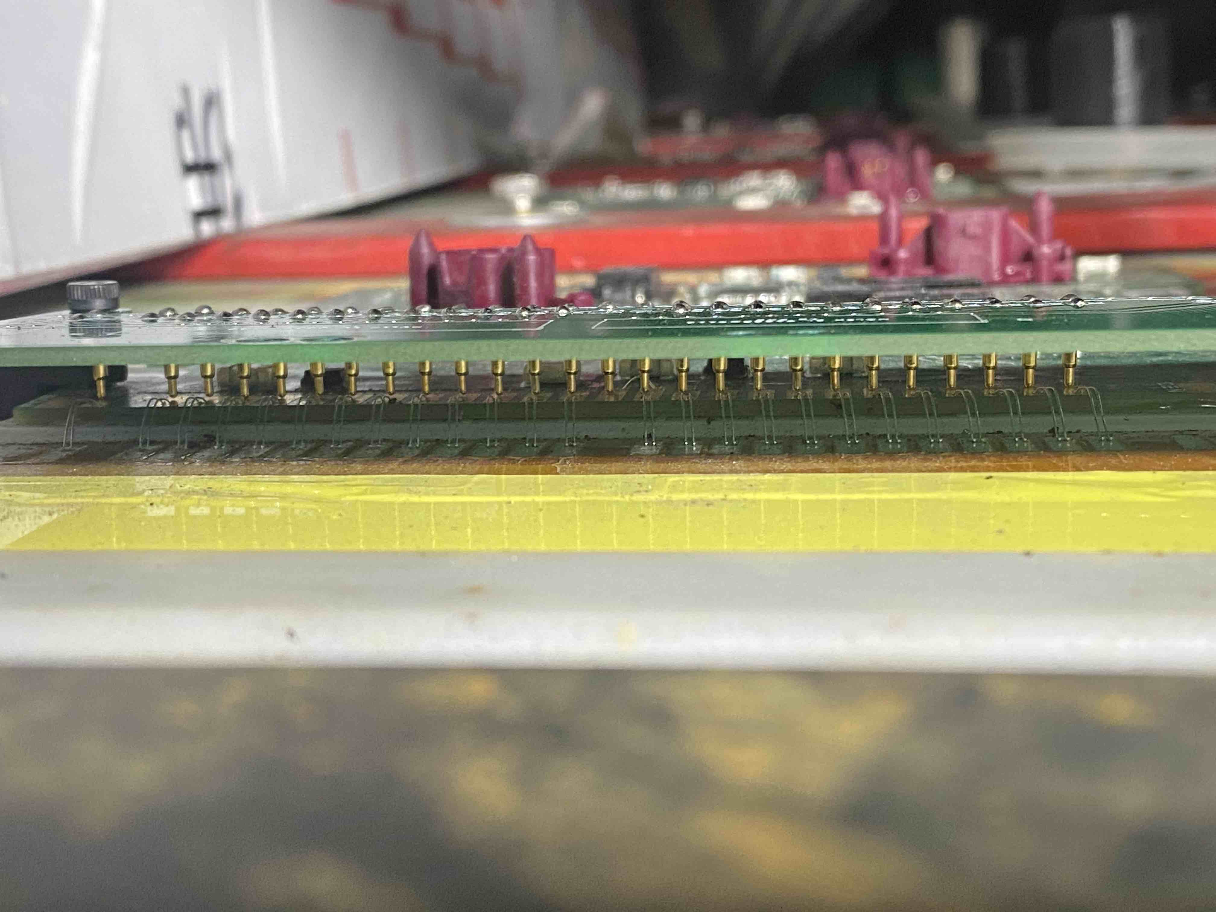

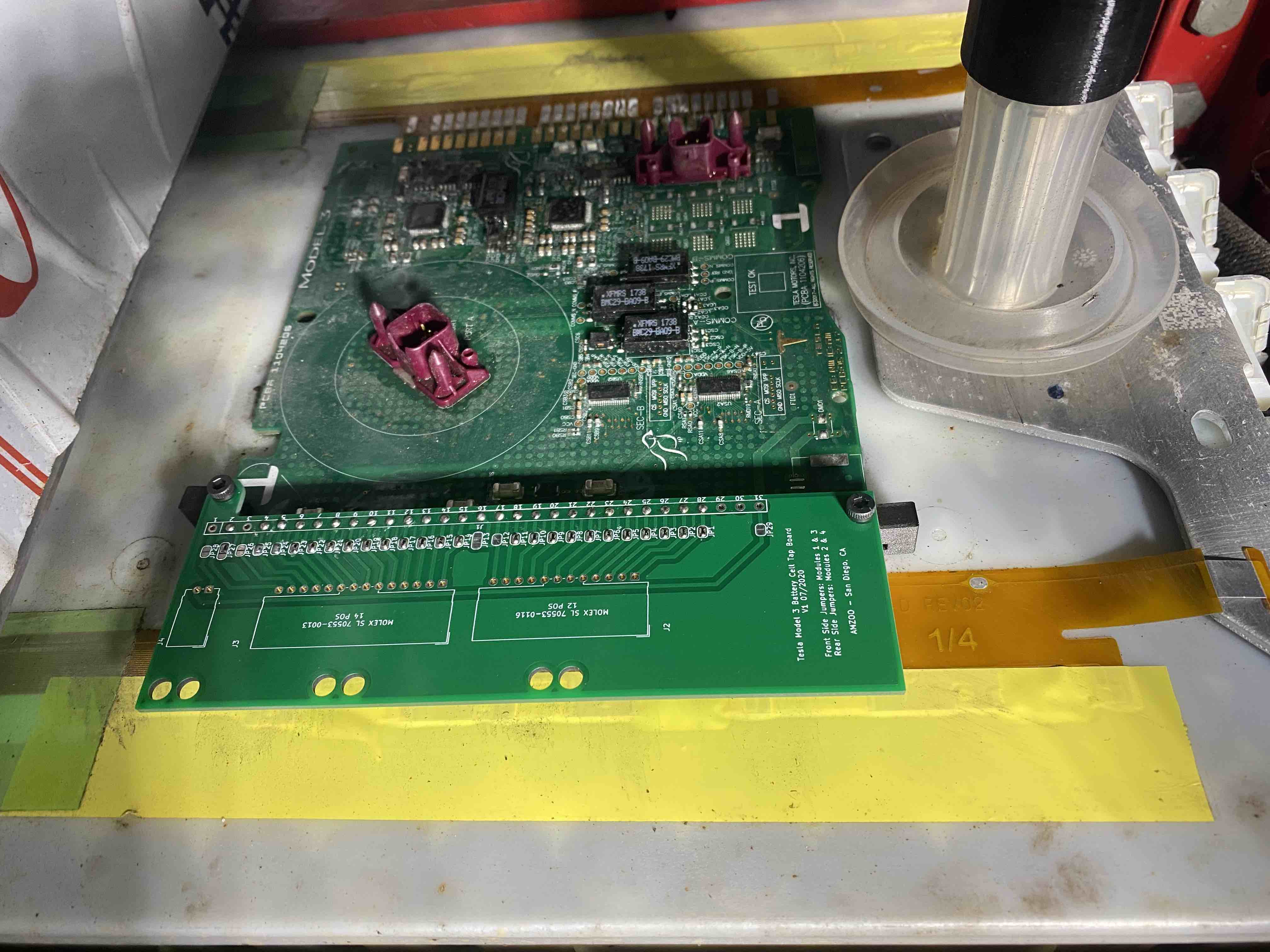

Finally back on this after a hellish end of a year for me. Here is the cell tap board on one of my modules. The Molex connectors I spec'd for these boards are backordered, so I'm planning on soldering wires directly to the board.

I initially used a current limited lab PSU to provide 12v on pins 8 and 18 with 0v on pin 9. The current drawn was about 60mA.

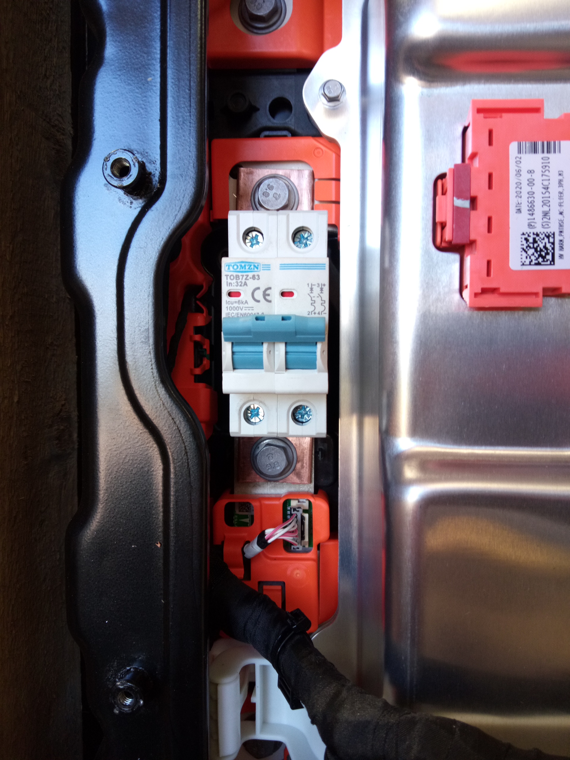

Next is to fix the pyrofuse. My application will never draw more than 25A so I am considering replacing it with a DC 1000v 30A fuse or MCB.
Edit. Just replaced the Pyrofuse and the vehicle CAN port still outputs only msg 0x132. I must be missing something.

I now have all messages on the vehicle bus. I needed 12v on the stud terminals, + on the outer one. I was pleased to see 0x401 was present on this 2020 pack. A CanDue/Savvycan log is attached.

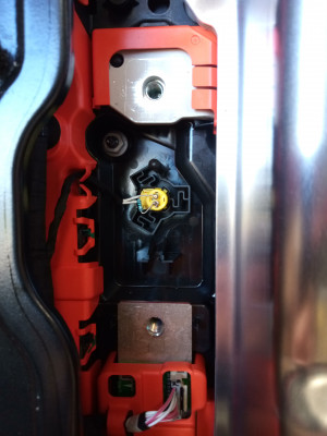

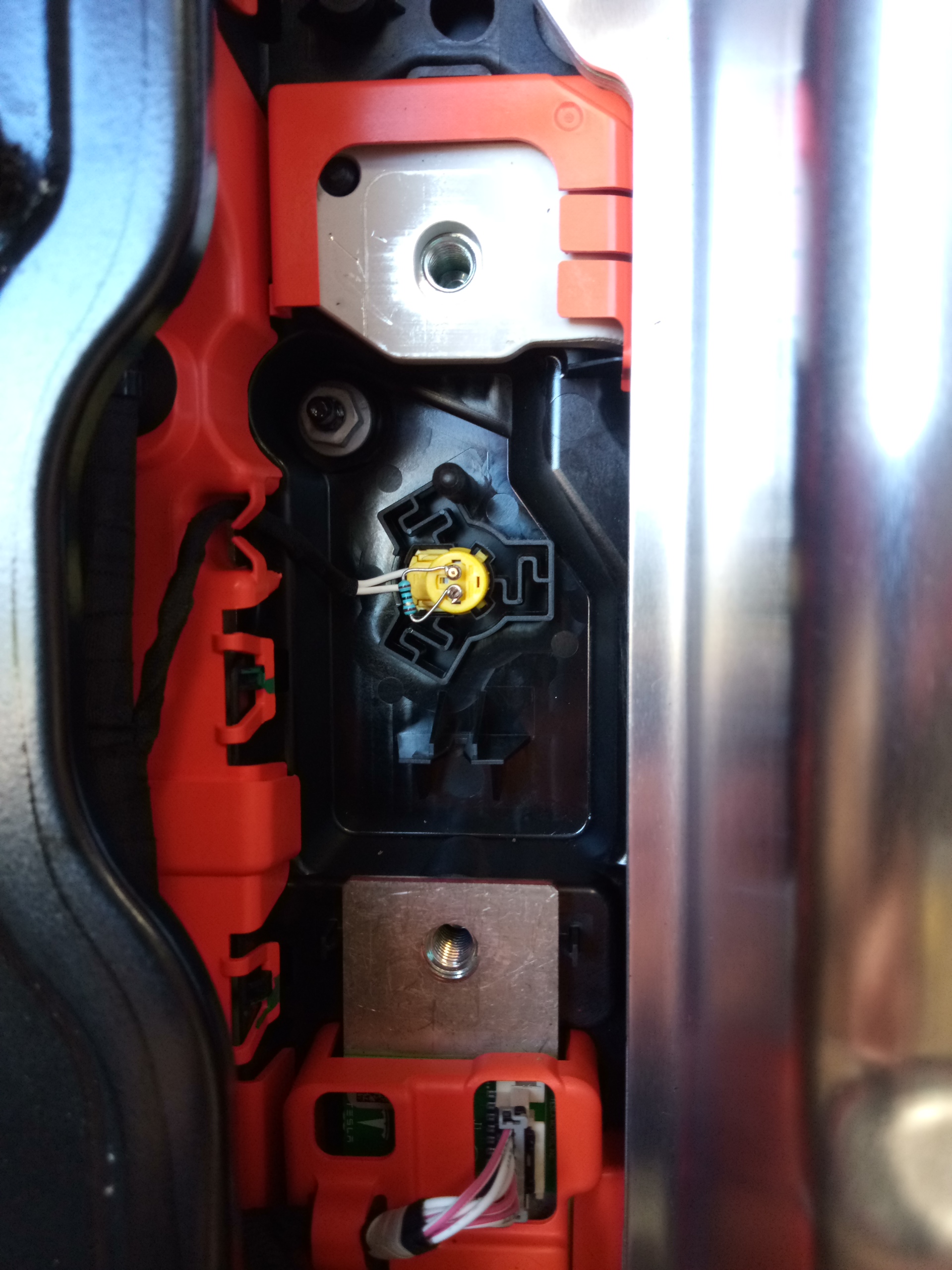

I replaced the pyrofuse with a DC circuit breaker and put a 10 ohm resistor across the pyro element terminals in an attempt to fool the bms into thinking the pyro fuse was ok. The contactors still did not close !
I studied the results in msg 0x20A while sending 0x221 and now can see that the hvil is ok because there are reports as follows...
0x20A C9 11 09 92 10 00 before sending 0x221 this is spewed out
after sending 0x221 messages at 5mS intervals
0x20a C9 11 09 12 38 01 the 01 means hvil ok and 38 = pyrotest +dc link allow + closing allow
this is sent for 30 seconds then it reverts to the first - even though still sending 0x221, so the closure is aborted.
I confirmed the hvil by unscrewing the two bolts of connector x098 then I saw...
0x20A c9 11 09 12 10 05 the 05 means "penthouse lid open"
So, no closure yet and running out of ideas. Starting to think of hard wiring to the main terminals inside and running cables to my own contactors outside. Not elegant!

Not much help for the coding side but maybe try a resistor between 1.8 - 2.2 ohm, all airbags in vehicles are that resistance that I have come across.
