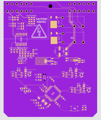

muehlpower wrote: Tue Jun 01, 2021 1:01 pm i changed my circuit a little and now it's fine. The circuit is required to measure the voltage at the charging connector and to pass it on to the LIM
What is up with the value R14 in your revised schematic? Is that not used? I copied your schematic and added two relays that have 15 ohm dpak power resistors to keep the LIM contactor drivers happy. Does this look correct? I did presently omit your R14, but will add back pending your feedback.
VOLT_DET.pdf
(33.28 KiB) Downloaded 574 times
muehlpower
Posts: 689
Has thanked: 14 times
Been thanked: 141 times
Re: BMW LIM based CCS2 Controller
Post by muehlpower »
jon volk wrote: Fri Sep 17, 2021 1:10 am
What is up with the value R14 in your revised schematic? Is that not used? I copied your schematic and added two relays that have 15 ohm dpak power resistors to keep the LIM contactor drivers happy. Does this look correct? I did presently omit your R14, but will add back pending your feedback. VOLT_DET.pdf
A resistor from TLV6001 pin 4 to ground reduce the output voltage at 0V input, a resistor to 5V increases the output voltage. In my prototypes I installed 220kOhm to 5V and replaced one of the 100kOhm resistors on the input side with 82kOhm, which improved the accuracy.
jon volk
Posts: 574
Location: Connecticut
Post by jon volk »
muehlpower wrote: Fri Sep 17, 2021 3:17 pm
Thanks for the input and I think that makes sense. Ill re-read through the datasheet to make sure I'm clear. Op-amps are definitely a weak point for me with circuits.
mikeselectricstuff
Posts: 120
Post by mikeselectricstuff »
I think you're missing a resistor from OUT to -IN on IC2
jon volk
Posts: 574
Post by jon volk »
I just kept confusing myself in trying to reverse copy/paste engineer the previous circuit. After spending some time reading through TI application notes and datasheets, I've arrived at the following schematic. I'm referencing how I arrived at these values in hopes it might be obvious where things went off the rails if this does not seem right. Like I mentioned before, opamp circuits are a weak point for me.
Input resistance values and rc filter came from this Excel tool.
https://www.ti.com/lit/zip/sbar013
AMC3301 datasheet
https://www.ti.com/lit/ds/symlink/amc33 ... 1893508066
App note for single ended input ADC
https://www.ti.com/lit/an/sbaa229/sbaa229.pdf
LIM expects 1.43v @ 0HVDC and 4.80v @500HVDC
To get a full range input at 500v, thats 600k ohm with a 294 1% resistor as the divider/shunt/whatever
Since we are only measuring positive DC voltage, that means OUTN will always be 0.
OUTP will be 0 @ 0HVDC and 2.05 @ 500HVDC (.250mv * 8.2 fixed gain)
Based on that, I came up with this revised circuit. In the spreadsheet, the LIM calcs tab has how I arrived at these resistor values based off the formula given in the single ended ADC pdf.
VOLT_DET.pdf
(34.26 KiB) Downloaded 648 times
Disregard the label typo. The top HV input should be labeled HV_P
AMC Voltage Sensing Calculator.xlsx
(244.09 KiB) Downloaded 587 times
muehlpower
Posts: 689
jon volk wrote: Sat Sep 18, 2021 8:24 pm
VOLT_DET.pdf
DC DC_HGND must be connected to HGND and not HLDO_IN to HGND.
Since I have connected INN to HGND, I get 1.44 V at OUTP at 0V input. R9 and R10 correct this value down a little so that it fits the LIM. So I don't need an extra voltage divider. I took 270 ohms so as not to need any special resistors, even if I don't fully use the measuring range with it.
The statement that I have 220K to 5V was wrong. It's just like my schematic, with no R14 and with one 82k instead of 100k.
jon volk
Posts: 574
Post by jon volk »
Ahh good catch on the HGND.
Aside from that, sounds like it will work. Thanks for the added explanation on yours.
Posting the final(?) updated schematics below.
VOLT_DET-HV_ISOLATION.pdf
(32.86 KiB) Downloaded 535 times
muehlpower
Posts: 689
jon volk wrote: Sun Sep 19, 2021 11:40 am Ahh good catch on the HGND.
i don't think it will work. OUTP and OUTN are not 0V with an input of 0V, its 1.44V. At 500V OUTP = 2.44V and OUTN = .44V approx
jon volk
Posts: 574
Post by jon volk »
muehlpower wrote: Sun Sep 19, 2021 1:42 pm
Got it, 1.44 centered common mode. Re-doing doing the calculations just needed to replace my R28 with the same 6080 ohm value. Values seem to align close enough and with the parallel resistor circuit, that gives me plenty of options for tweaking in the future. Without this change, it seems values would have been 0HVDC @ ~2.3v and 500HVDC @ ~5v
Thanks for the help.
I’ll post the final files to my GitHub after I’m done. It’s going on a board with an STM32F413 to handle two Volt BMS systems and any other battery related needs. Have the BMS code generally done but untested. Need to port the necessary CCS from Damien over to c/st-hal.

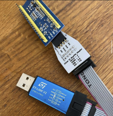

EV_Builder
Posts: 1205
Location: The Netherlands
Has thanked: 18 times
Been thanked: 37 times
Post by EV_Builder »
Can you add a header for connecting the ST-Link device?
I was thinking embedding the USB ST-Link within each case.
They are €12,-
Impressive work!

EV_Builder wrote: Mon Sep 20, 2021 8:44 am Can you add a header for connecting the ST-Link device?
They are €12,-
Impressive work!
I actually already moved it to a 4 pin stlink connection since I can’t seem to find my Tag-connect cable.

jon volk wrote: Mon Sep 20, 2021 11:06 am
They are €12,-
Impressive work!
My idea is to make a small cutout in the casing and glue the link
In the PCB. Or maybe we should populate those 4 wires on an USB mountable connector and make a STLink to USB cable.
Anyway we get access to reprogram and debug then!

The pin order I use is the same a blue pill (and that used on the Gen 2 Tesla charger). I made a small IDC cable adapter to plug the cheap STlink clones into without messing with jumper cables. But the files will eventually be available so anyone is free to mod as necessary.
