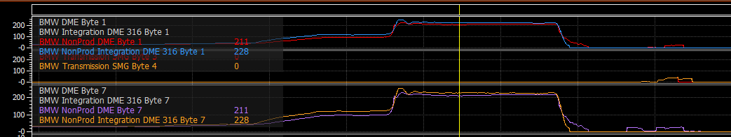

Ran the car on the Motec today. Ehhhh. So looks like some of my MAF math was quite bad. Super rich at idle. Oops.
Shift from 1 to 2 still fails. I think the main issue is the RPMs are falling too rapidly.
So close:
The lines in white are from a run on my code.
But..just kidding.
I'll have to take a look at this more closely, per channel, to see what is going on, but...yeah, not quite there yet.
Action items:
1. Fix MAF curve to actually be right.
2. Ensure the only limiting going on is the Engine Speed Limit
3. Try again. :)

Well, I got everything integrated and flashed. I turned on the option to use the new code, and...
A. What a difference a little filtering makes. ;) (Engine Speed Gradient vs Filtered version)
B. I wasn't sure the car was going to idle at all. So, quite happy.
I took a spin around the block and I need to fix the fueling first, it'll stall sometimes coming to a stop. Still doesn't shift to second gear yet. :( But I haven't touched any gear shift stuff recently, so not entirely shocked there.
Still more to go, but goal for today (start car, get it to idle) - achieved.

should be functionally equivalent. Except, it's not.
Turns out integer rounding will bite your butt. Because I had 60 / ... and not 60.0 / ... and using 16 and 256 in other places..I was getting wheel speeds that were only accurate to 1 km/h. Oops.
Also, that code was written before I had a better handle on bit shifting and ORing stuff together. The new code makes more sense, and probably faster, too.
