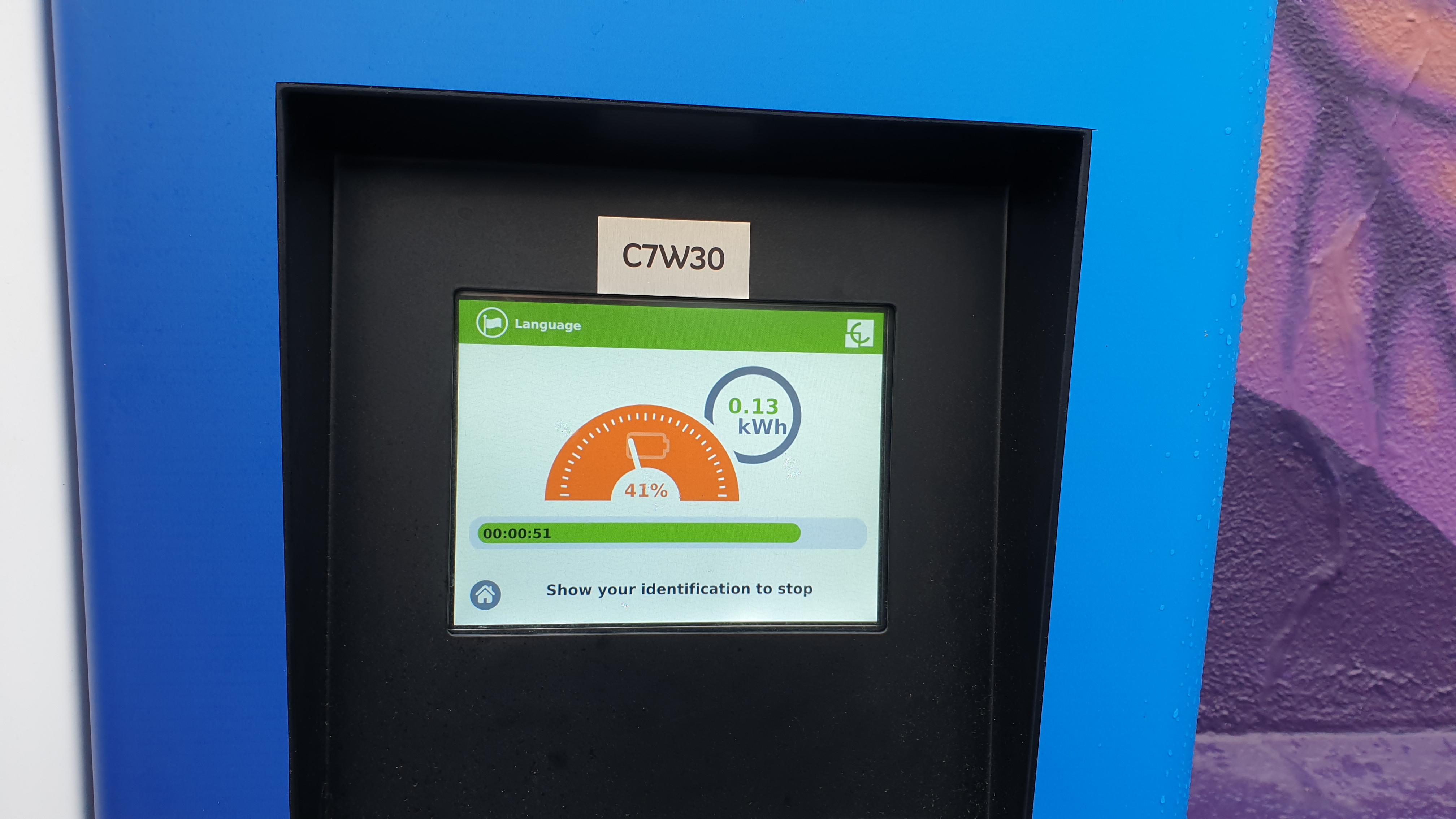

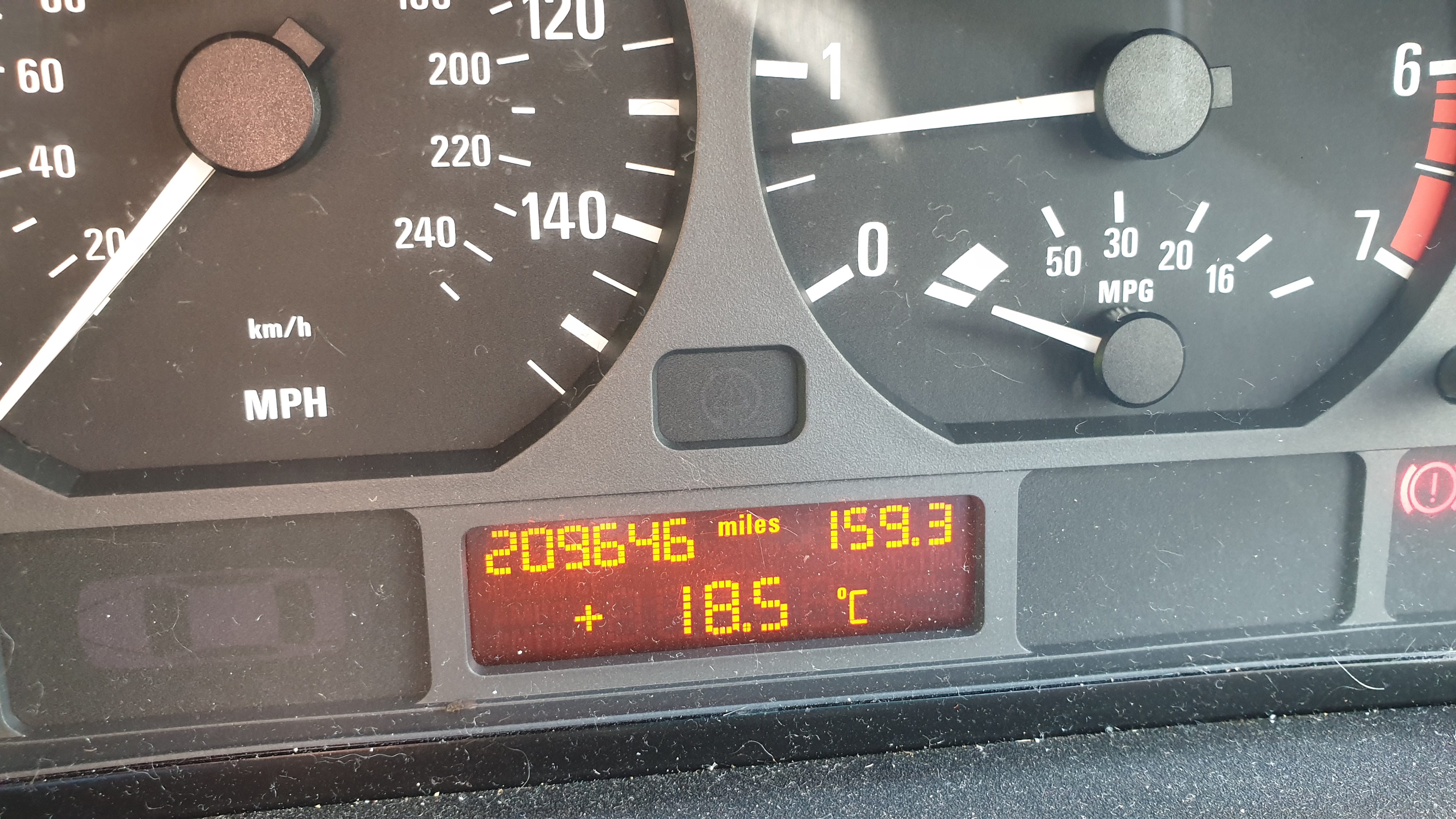

Road trip! Went on a 160 mile jaunt today to collect some parts. 3 CCS stops.
1)Circontrol. No problems got full 125A available.
2)Efacec. No charge constantly failing around state 1/2. Modded the state machine so state 0 is "standby" for 2 seconds. Problem solved. Full power.
3)Efacec. As above. Worked fine with mod to state 0.
Not bad for a 22kwh Zoe pack in an E46 touring...

Jack Bauer wrote: Sat Aug 21, 2021 2:33 pm 2)Efacec. No charge constantly failing around state 1/2. Modded the state machine so state 0 is "standby" for 2 seconds. Problem solved.
Would love to get some SPI/PCAP captures here, just to see what the efacec is unhappy about. Is state 0 normally SLAC? There are a few stations that are borderline out of spec in terms of SLAC setup speed. I'd like to see the captures to make sure your fix doesn't break compatibility with another station or something.
Interesting that you were charging on Efacec fine before. Hm. Hey did you know that there are basically two different versions of software out there running on Efacec stations? Wonder if those stations got recently updated. Normally the fix is for cars that are trying to set up TLS (security) during the handshake, but who knows maybe they tweaked something else too.
Isn't this standard just wonderful? :x

Station was a Eafacec QC45. Current control is working as if I set a request in excess of the available current it limits to this value. Also I see some stations that roll back the available current as the session progresses and the car respects this limit. In another area I'm 90% sure I'm not starting the handshaking correctly. Given that all ABB stations and a high power (150kw) Delta now tell me "charging will commence once power is available" and then time out. Most seem not to care but these two are obviously using a different standard:)
