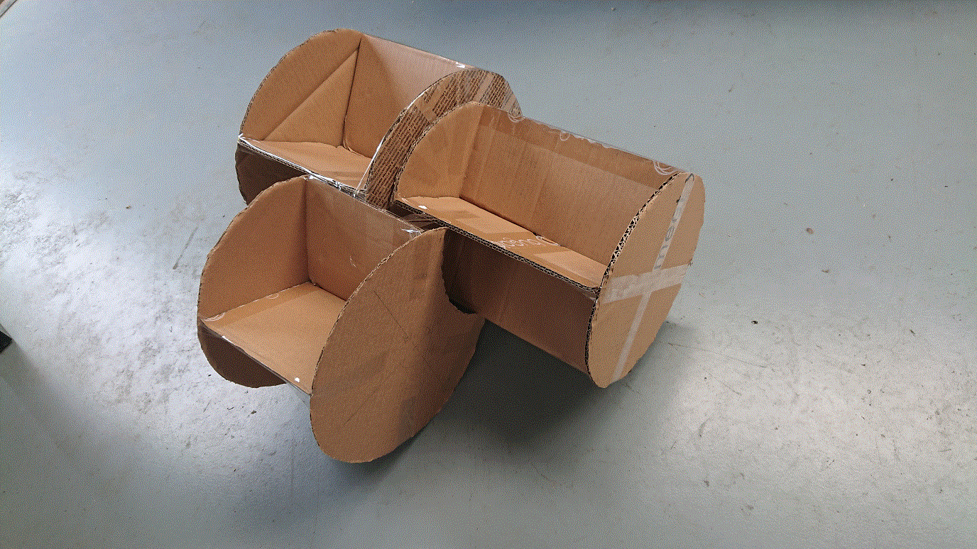

Does anyone know if there are detailed/accurate 3D models or scans of the Tesla Model 3 front and rear drive units that would work in Solidworks? It's been discussed on the forum a while back and there are some basic scans on Grabcad, but checking if there is anything more detailed available since.

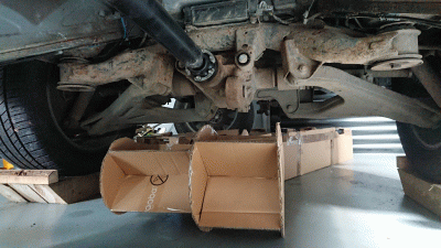

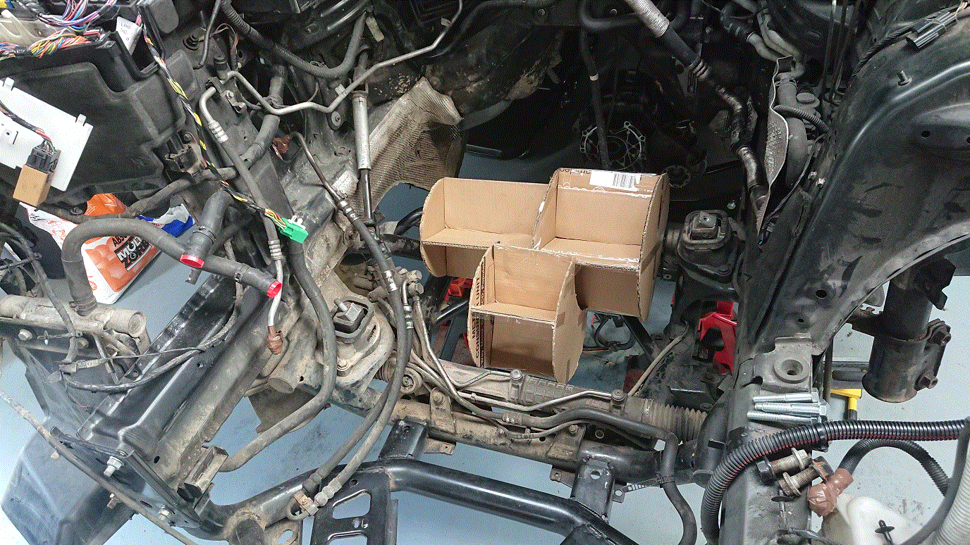

Got rough dims from the grabcad model and mocked up in 'real' CAD! So no need to try get a scan if not already available. Was just checking, cheers. Interestingly, the TM3 rear drive motor size looks to fit up front ok, but not so straightforward at the rear without changing the angle of the axle shafts.
