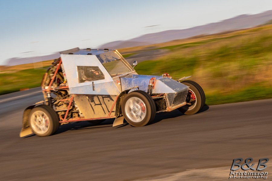

I'm competing in rally cross open class in a buggy that me and my dad built. It has a 1600 vti engine in it and it works great! I'm keeping up with 4wd cars with much bigger engines. But my little Honda engine is not enough to win races consistently. So instead of building a 4wd ICE buggy we wanted to go electric.

I've also posted a picture of my current race buggy :)

a Prius transaxle is a very experimental choice.
Your plan is extremely ambitious...
I recommend taking more time reading and study the projects folks in the industry are working on.
a leaf transaxle with the 160kw inverter would be a good budget option.
And a small hybrid battery pack - volt or pacific pack.
That would render good power to weight.
