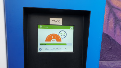

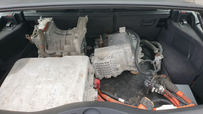

Road trip! Went on a 160 mile jaunt today to collect some parts. 3 CCS stops.
1)Circontrol. No problems got full 125A available.
2)Efacec. No charge constantly failing around state 1/2. Modded the state machine so state 0 is "standby" for 2 seconds. Problem solved. Full power.
3)Efacec. As above. Worked fine with mod to state 0.
Not bad for a 22kwh Zoe pack in an E46 touring...
