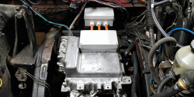

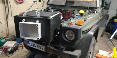

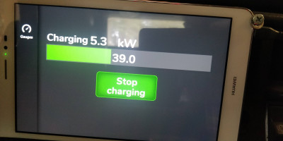

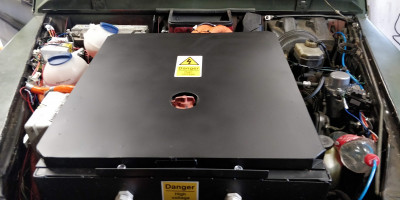

Here is some information of my conversion project it now driveable and waiting for mot inspection.
Arduino due as main computer.
Motor Nissan leaf with can bus control.
Battery renault fluence 2011 (nissan bms)
Charger Tesla 11kw (two working modules)
Vacuum pump Audi Q5
Power steering Opel Zafira
Heating Tesla battery heater

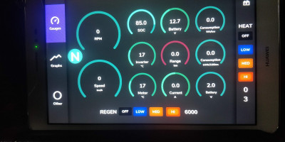

Dashboard and some controls (heating, regen, mayby more in future) https://realdash.net/index.php and old tablet.
Below is some teaser pictures and more can be found here:
https://photos.app.goo.gl/JJ9DbfApSFacZgot5
And some videos:
https://www.youtube.com/user/JUSAKAPE/
I'am not very good of writing long stories, but if you want to know more of something specific i'm happy to answer questions!

So I have a question: are you using the power limits from Leaf BMS, or calculate your own?
JSJFIN
Posts: 11
Joined: Thu Mar 21, 2019 3:30 pm
Re: Electric G wagen
Post by JSJFIN »
johu wrote: Fri Nov 08, 2019 8:26 am Ylipää - good to see some Finnish roads :)
In regen i just have manual control and some constants like if below zero C no regen at all. And output power is just linear tps -> can bus torque command to leaf inverter and it seem that leaf inverter is limiting power to about 80kW.
Edit:
It could be that inverter is getting power limit directly from BMS i have to put discharge limit to screen so i can watch what it shows.. i never even looked the value but one old log shows:
Soc 66%
DischargekW: 93
leman2112
