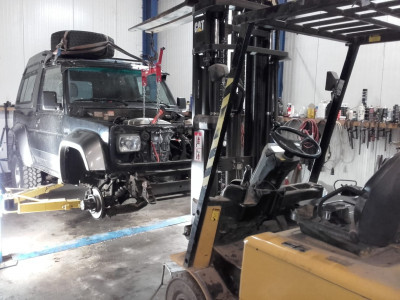

Tractor was not completely ideal, but the engine, bell housing and gearbox are out

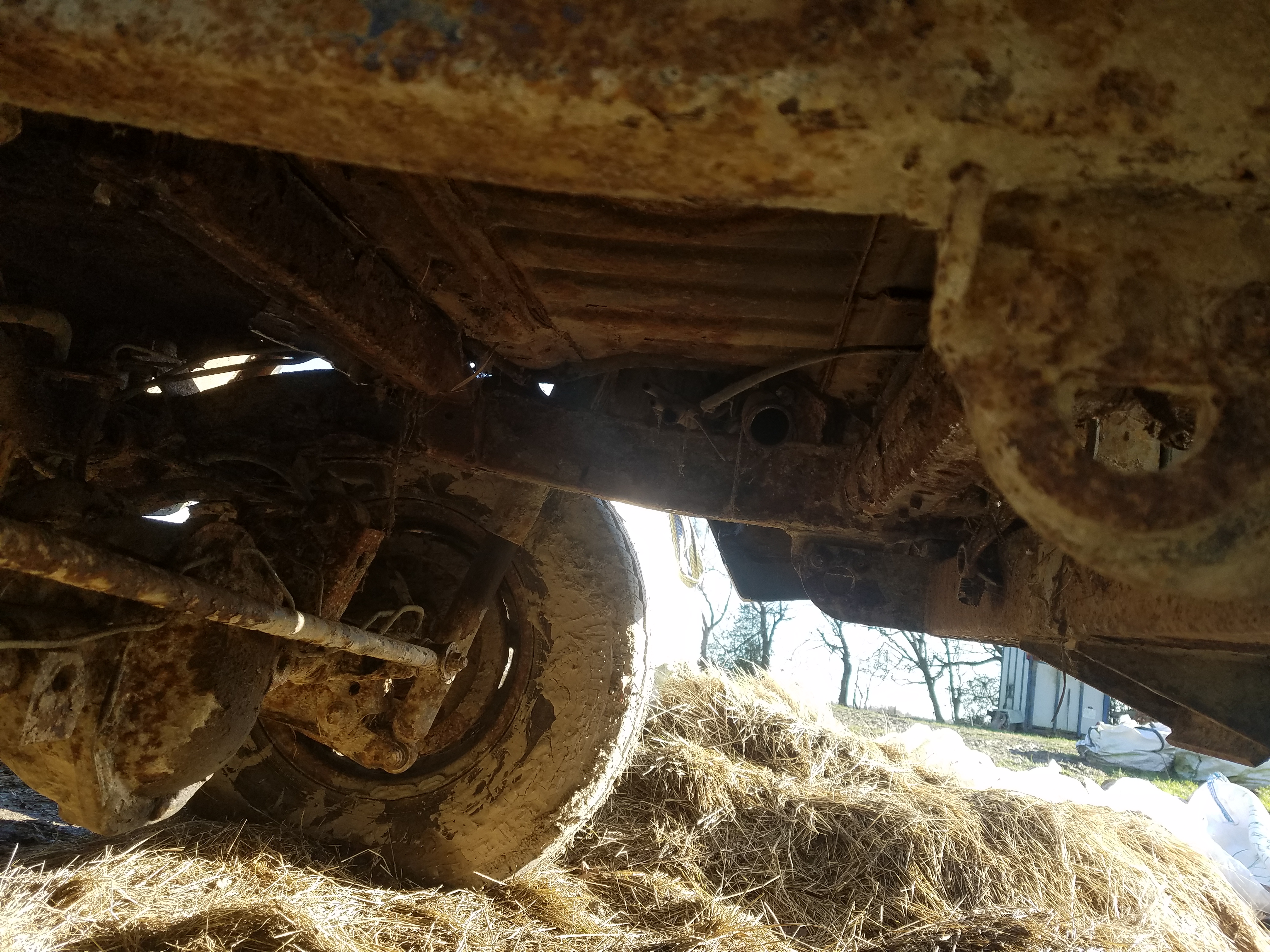

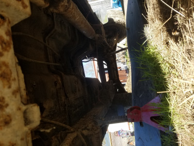

The fuel tank is out and this is the space available,
roughly 750x500x270mm
Here is the exhaust space, seem to have not make a note of the space here
How do people deal with underbody battery boxes, access wise, my options are
A) no access once in place, just have cables exiting box that I terminate up front
B) a rear facing access panel (or whole side of the box comes off)
C) I cut the boot floor in, although that's less of an option for the exhaust space box because of seats

I mounted the battery using Nissans structural elements only: viewtopic.php?f=11&t=32&start=125#p3033Greenbeast wrote: ↑Sun Jan 17, 2021 11:51 am How do people deal with underbody battery boxes, access wise, my options are
That way the surrounding plastic has no structural task but only weather protection and can be removed for service: viewtopic.php?f=11&t=32&start=200#p6259
All TÜV approved.

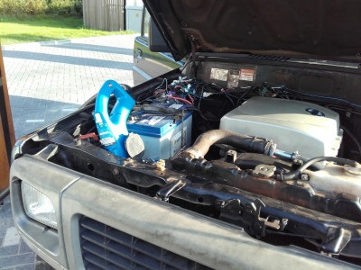

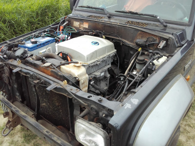

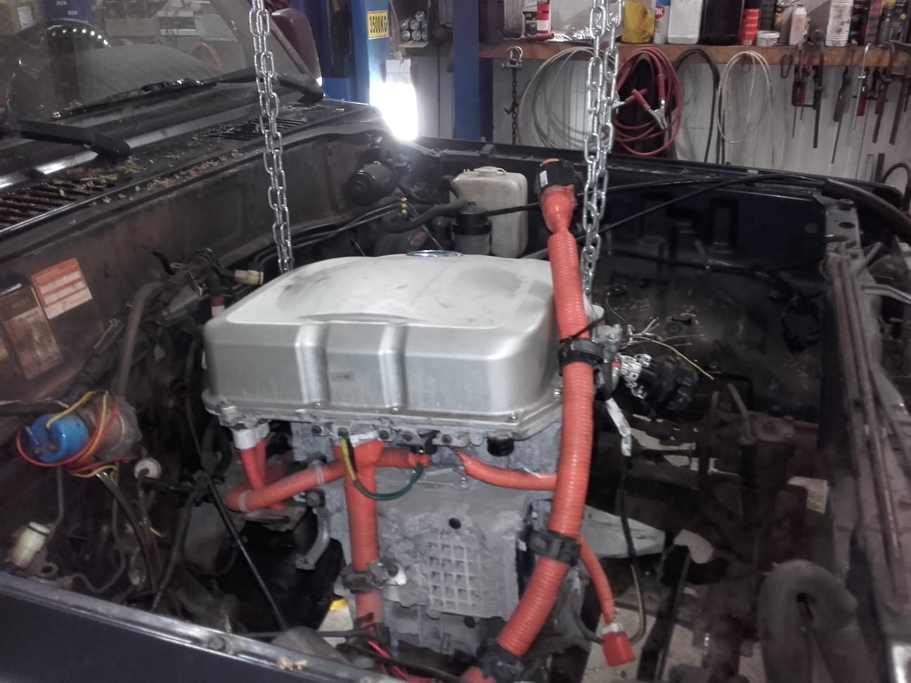

Just wanted to let you know that I am also working on a EV conversion for the Fourtrack/Rocky. My aproach is using the Nissan Leaf motor and inverter.
From what I could see on the Mercedes G conversion (also on this forum) it looks like the setup directly onto the transferbox should work, either in high or low (or both). We need to do tests to see how much the current drain would be in both cases.
Note: I will use the motor assembly from a 2015 Leaf. Not sure if I can use the EM61 instead of the EM57 with the 2015 inverter/charger setup.
But it is easy to make the EM57 also fit to the transfercase.
(update)
I decided to go for the EM57 stack directly mounted to the main gearbox. We test fitted the stack and all seems to locate well. Regards,
Paul
Regards,
Paul

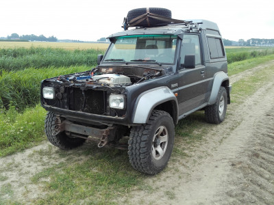

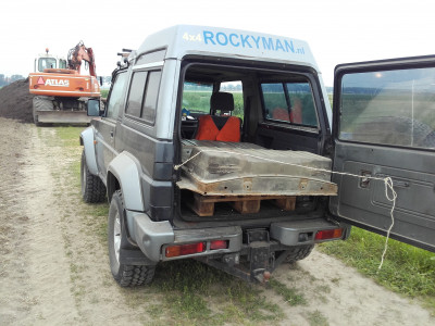

Hi Nick,
Thanks for your reaction.
We started a couple of months ago and so far we have a running vehicle, next step is to tidy everything up and do proper road testing.
After that we will convert 5 of them for a local forestry company. I am working together with a company that does Rocky rebuilds and has the biggest used parts warehouse in Europe.
I will also post some pics:

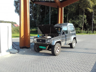

Re: Daihatsu Fourtrak
I managed to get a max top speed of 140 km/h, which is impressive for a 'brick'
It used a lot of power, from my rough calculations it used 260 w/km at 90 km/h and approx 850 w/km at 140 km/h. Not much range with a 24 kWh battery at 81%.

We did an off-road day at an 4DW event here in NL. It was great, and in a way boring The Rocky performed outstanding and driving was super easy, just one gear and off we drove. Lost of torque and power, really amazing.
https://youtube.com/shorts/TTlhEbgFgH0?feature=share
here is a short video.
