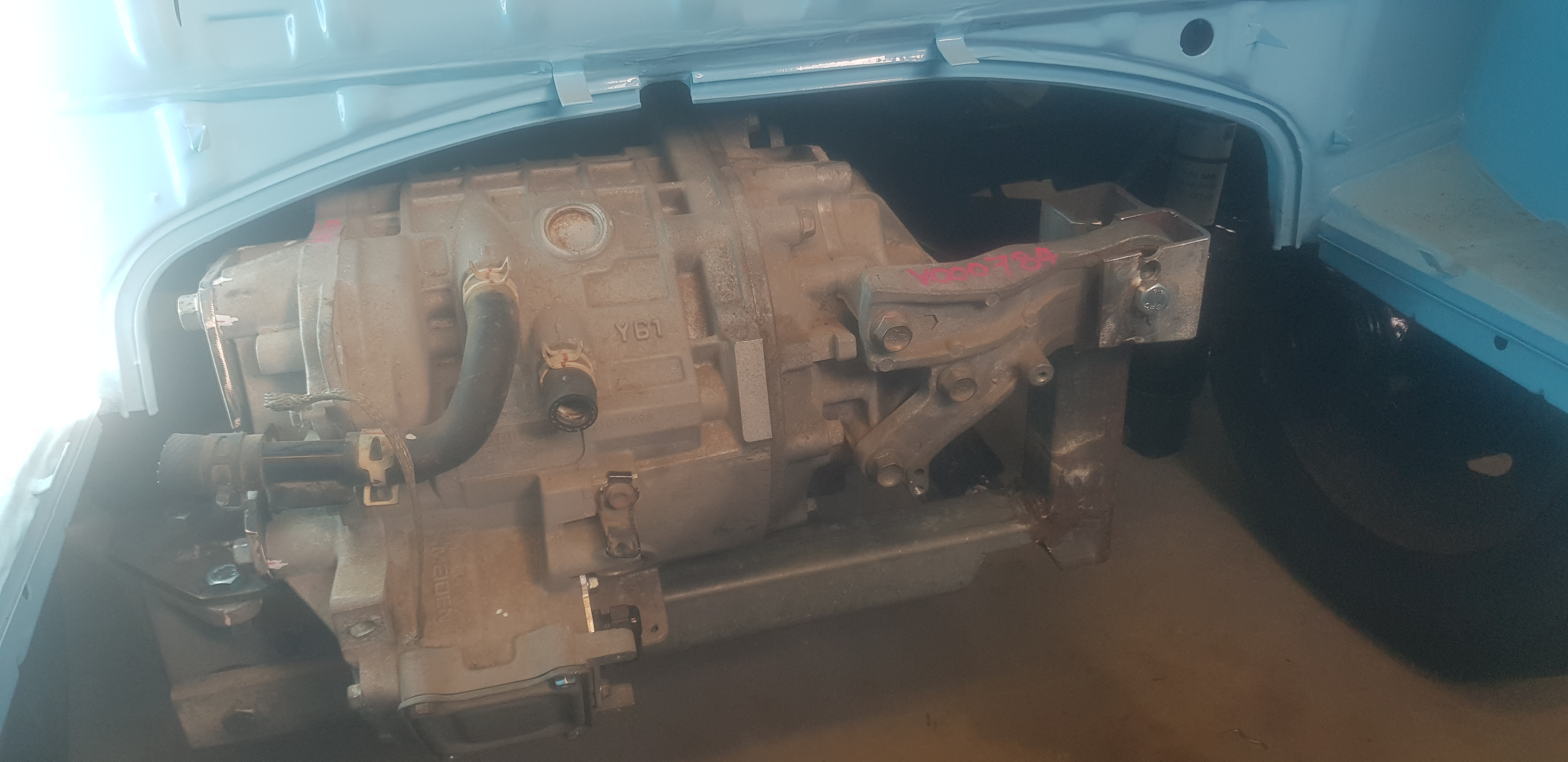

Sorry about the reflection!
No electrical progress but confirmation that the motor fits neatly in the back of a 72 Super Beetle. Fixed to original VW mounts with no structural changes. Should be plenty of room for an inverter etc.
For anyone else using a Mitsubishi rear motor - make sure you get the drive shafts with it. I only want to use the inner cv joint to graft onto the VW shafts but there seems to be no stock of none oem parts and Mitsubishi quote $960 each for them ex Japan!
LRBen
Posts: 608
Location: Somerset, UK
Has thanked: 121 times
Been thanked: 290 times
Re: Mitsubishi Outlander rear axle
Post by LRBen »
I did look into the inner CV joint for the rear Outlander motor when I was going to go down the same route. From memory the inner CV joints have the same part number going back to previous models of Outlander, including non-hybrid models. So you might be able to pick up a pair of second hand joints for an older model for a bit cheaper, or maybe find some pattern parts.
I'm afraid I never wrote the part number down.

Good to see another motor getting mounted up.
The part number at least for 2018my on is 3717A029
I've not had much luck sourcing aftermarket ones.
If you are in the UK I can give you number of the specialist breaker I use, he will likely have some at a good price.
