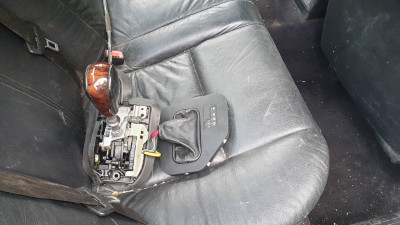

Long time no update. As some of you will know I have a bench setup with a GS450h and GS300h now for software testing with the VCU. A few folks on Patreon had suggested fitting the 300h to the yacht and I started parts gathering for an "auto swap" :) Anyway, plans change and I'm now going to pop the 450h in the E39 as it will give me a nice testbed to get things like gearshifts etc ironed out. The 300h is going in .....a new project:)

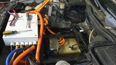

Stripping out the charger, inverter and motor.

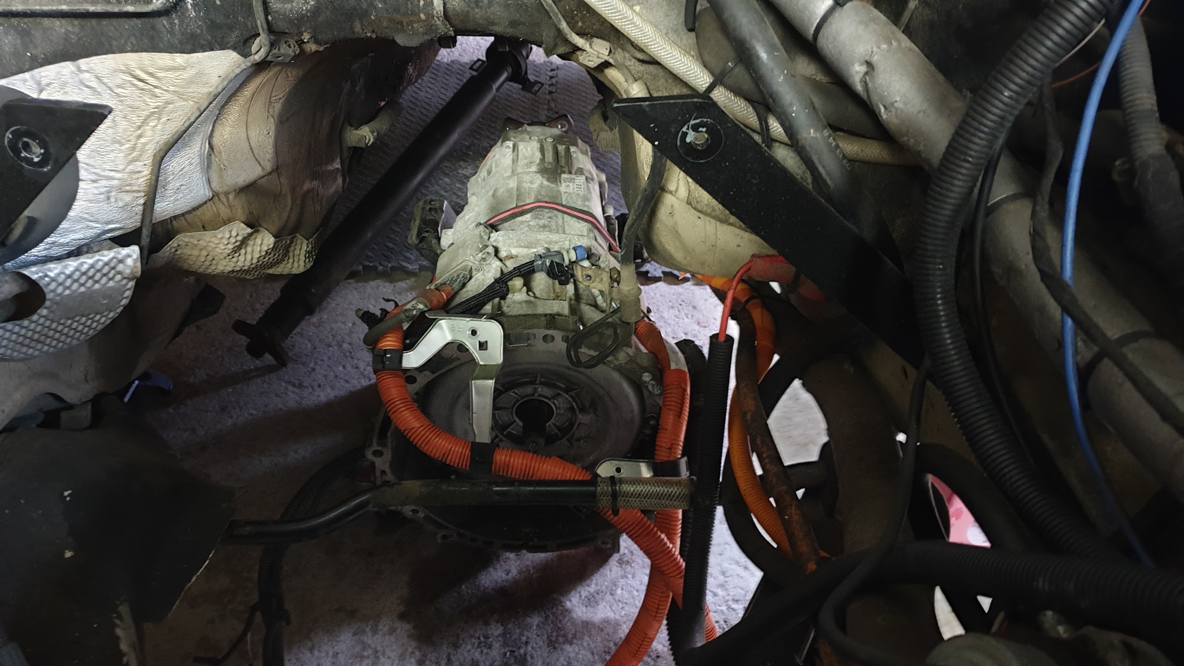

Looking good. This is the project that makes mine easier :) I can see the gearbox mounts line up well aft of the standard chassis holes. good for weight distribution a hway. If I recall you already had added more, not sure if that was on this car.
I would argue with the 2 tonne thing by the way, my touring is 1850kg. How many leaf cells are in the front, presume you are keeping same battery?

It bolts to the same points as the auto crossmember.

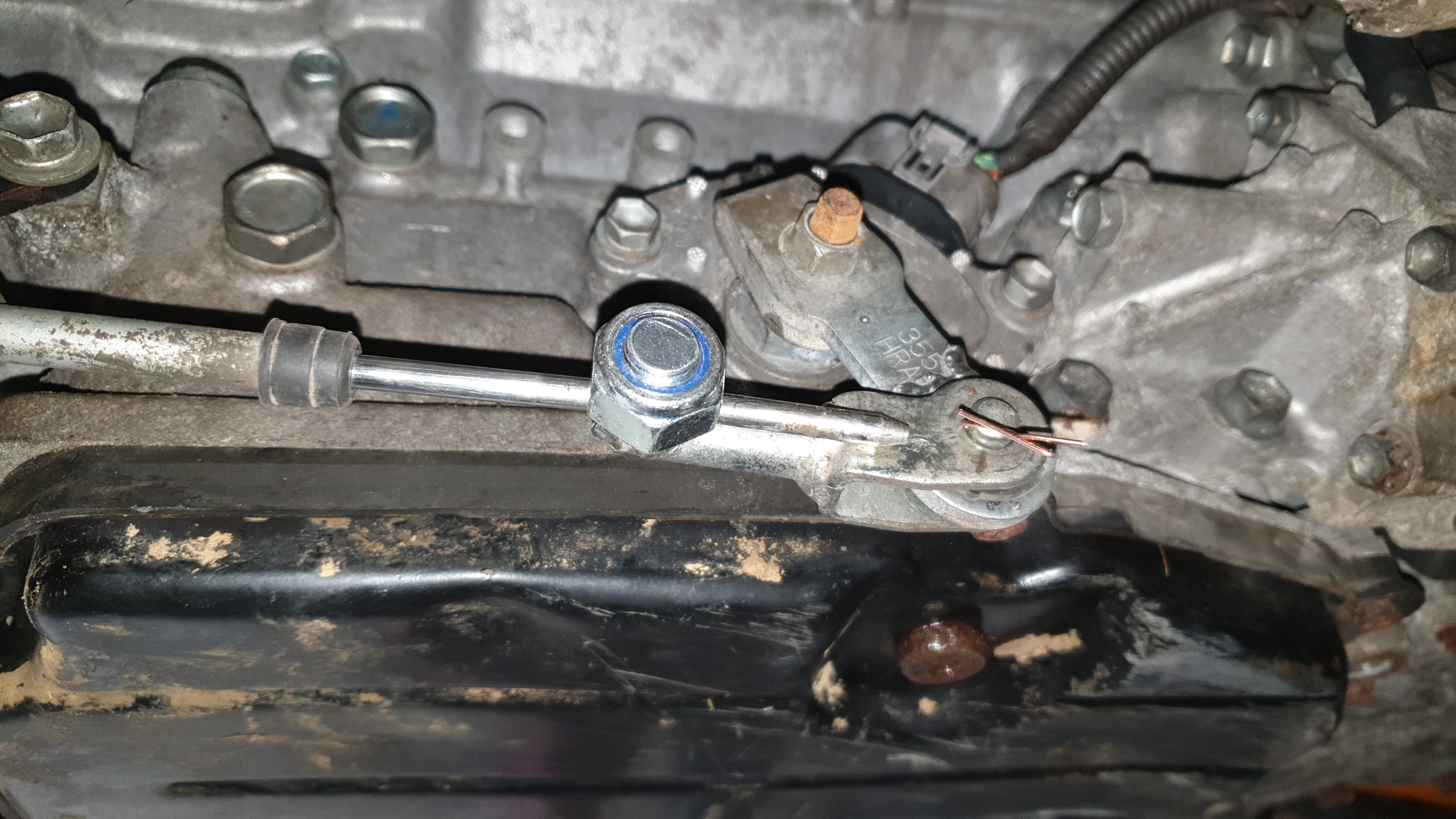

That is great to see :) , are the gear positions on OEM bmw shifter the same as positions on GS450?
How is on IS300 ? (more interesting to me :) )
laverage is ok ?

A point of clarification: are transmission jacks crap in general for getting it in place, or just that particular type? Any recommendations on something that's not crap?
TheSilverBuick
Posts: 187
Re: The LandYacht BMW E39 Saloon
Post by TheSilverBuick »
mark wrote: Thu Oct 13, 2022 2:14 pm A point of clarification: are transmission jacks crap in general for getting it in place, or just that particular type? Any recommendations on something that's not crap?
It looks like a motorcycle or ATV jack. My guess is the GS450h is about 100lbs/50kgs over what the jack is designed for.
