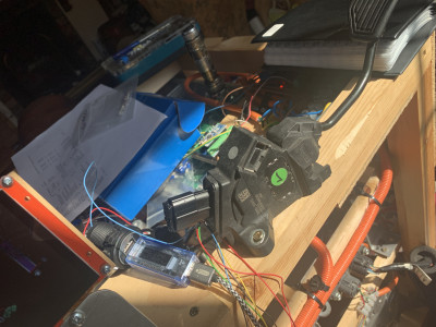

Does anyone happen to know the plug used on the Prius/auris pedal as shown here:
viewtopic.php?f=9&t=335
If not I'll try and work it out just thought I would ask in case anyone knows 😁

Based on the image in that thread I'm going to guess it's Yazaki 7283-1968-30.
I've never used a pedal like that and never bought a connector like this though.

I have the pedal from gen 2 Prius in my Mazda. Pedal P/N is 78120-47050 and it uses bigger connector.
Yazaki 7283-1968-30 or 90980-11858 with pigtail.
In my 406 Coupe i use Auris pedal P/N 78110-02030. This has smaller connector.
I have found it is sold as Toyota 90980-12303 Plug Connector Kit. It seems to also fit to later model Prius.

If it’s any help I just bought this: https://www.ebay.co.uk/itm/6189-1083-90 ... 635-2958-0 and it fits my auris pedal
