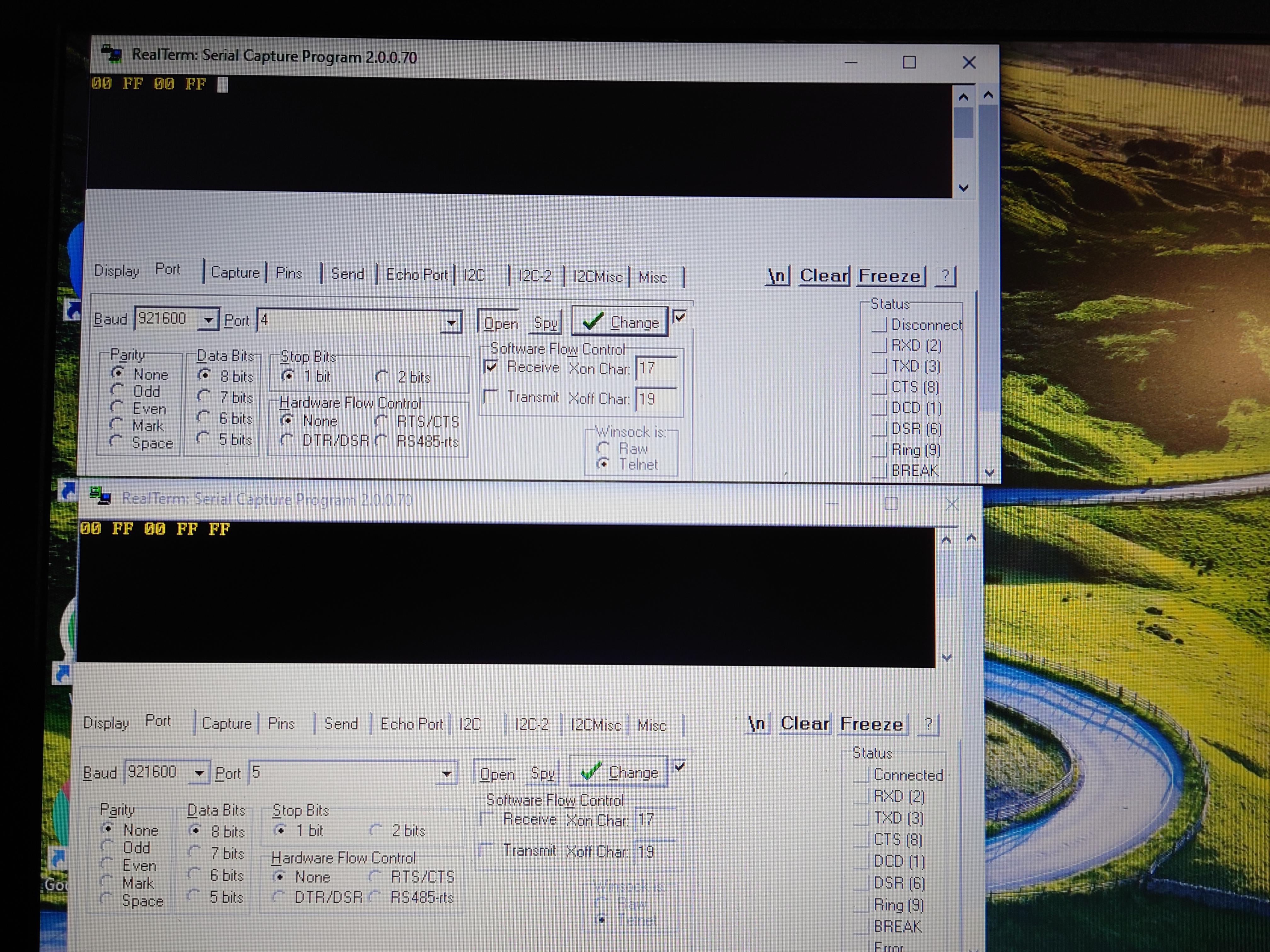

Re: ZombieVerter VCU Support
Ok, my setup is ready to capture the data. Please, give me some advice about settings/method. Baud rate?Dilbert wrote: ↑Fri Jul 02, 2021 1:59 pm The easiest way to capture the frames is with two ftdi cables (or any ttl to USB converter).
Connect the two ftdi rx pins to the rx pin on the VCU CAN transceivers. You'll need to connect the grounds too. You can then log from both interfaces using something like real term to a file on the disk. You will need two copies of real term open.
Now I'm getting only few bytes (random length) only then I turn the inverter (or VCU) on.
Set each of the baud rates for 500000 bps. At this baudrate ReadTerm is not able to keep up and display the data correctly, so you are best to capture it to a file. This capture can be in binary (which is hard to read unless you use my phython scripts) or you can choose the hex option and use excel.
If working in hex you are looking for a repeat in the data, I like to do this in notepad. You should see the data repeats every X bytes, where X will be 100, 120, 140 etc...
Post a capture output here and I can have a look
Ok. Thanks.Dilbert wrote: ↑Wed Jul 07, 2021 2:50 pm Set each of the baud rates for 500000 bps. At this baudrate ReadTerm is not able to keep up and display the data correctly, so you are best to capture it to a file. This capture can be in binary (which is hard to read unless you use my phython scripts) or you can choose the hex option and use excel.
I'm still have no continously "RXD" status. I don't know why.
When I start the inverter I get a few bytes and "break condition received" then.
That is really strange. When you say "continously" "RXD"? which line are you talking about?
I guess that RXD status should be ON.
But when I start the inverter or VCU I get RXD status ON just for a momment, receive a few bytes and go to BREAK status with "break condition received" message.
So I can't see the data stream to capture.

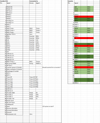

Hi all,
Hoping to get a GS450 working with a Zombie VCU. The transmission unfortunately came without a wiring loom but the info in the wiki has mostly resolved that.
I will contribute a wiring diagram or connection list for this combination once it's working - however I'd like to ask for someone who's worked with the GS450 before to cast their eye over what we've got so far and see what we're missing (are the red highlighted lines important)?
Also, not sure how to go about the first start up and debugging.
- status remains at "off". Throttle values show up properly, but start input does not, and inverter VDC also remains at zero. Oil pump does not run. Does this indicate lack of comms with the inverter?
Thanks for any hints!
We need a bit more info to be able to help. e.g. is your isa shunt wired up? Current parameter file etc.
Thanks Damien, I since found a (really good) schematic with all the pieces buried in the thread, albeit for the old version of VCU. And indeed, we don't have the shunt...
If anyone can access the wiki page for the GS450 and add this pdf to it, it could save newcomers an awful lot of time! I can't log in there, the sign up link is broken.
viewtopic.php?p=12105#p12105
