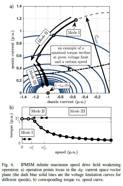

I'm up for some more motor control alchemy. Are you?
There was this "speedy_gonzalez" person who posted some really interesting stuff about "infinite speed drive" class motors in viewtopic.php?f=7&t=1628 and said that the Prius motors are of such type. They since deleted all the content of their posts. No idea why. I saved the graph they posted and will attach it here too. I'm going to completely botch the terminology because I didn't save the posts and can't be bothered to dig up the papers they posted that I didn't bookmark. They said something like: These motors have three operating modes or regions instead of two. Two being (1. non-FW and 2. normal FW), three being (1. non-FW, 2. normal FW and 3. current-limited FW).
Basically it was so that you have a maximum field weakening (-Id) current that you can use, and once you reach the maximum you're in mode 3 and have to start decreasing Iq in order to stay in FW (to advance the current vector further without increasing -Id), I recall you then ramp Iq down in such a way that the motor power stays the same.
I'm going to suppose the MGR is also this type of motor, and also that it's basically the same as the Prius motor and also similar to the graph in the image.
I believe we're still very far in terms of correct Id-Iq distribution. And of course we don't have any of the limits implemented, but we have to start from the lower speed distributions.
In the graph you can see at the mode 1 -> mode 2 transition point the Id-Iq relation is about Id=-0.7*Iq, at mode 2 -> mode 3 it's Id=-2.3*Iq and at the end of mode 3 it's Iqd=-7*Iq.
Now, these modes seem to be only or mostly dependent on motor speed and there's no information on what the speeds would be. Given that moving current from Iq to Id increased performance when starting from about a 1:1 distribution at 2300rpm, I would reason 2300rpm is close below to the mode 2 to mode 3 transition point. Maybe the transition point is somewhere between 2500-3000rpm.
The goal would be now to make the motor accept full power (45kW) at around 2300rpm (153Hz) and when that is achieved there should be a very steep performance loss at some higher RPM if the currents aren't appropriately limited - however we can try to use the idcmax value to implement mode 3. When mixed in with syncadv, it will result in something surprisingly close to ideal control I believe.
To make 45kW at 2300rpm, given that it's where I think it is, looking at the graph, the motor wants about Id=-2*Iq. To make that happen using syncadv, current vector needs to be advanced to 153 degrees from the regular 127 degrees, that's 26 degrees and, given a syncadv of +10 at this speed will give 7.5 degrees, we want a syncadv addition of 35, that's a value of 10+35=45.
Then to limit power to 45kW as a mode 3 implementation, set idcmax to... uh, bexander: what's your battery voltage again? If it's 350V, set idcmax to 128. Well anyway, it should be 45000/udc (I=P/U).
bexander: Brave enough to try this? Make sure to disable regen completely, it won't work correctly. Anything using syncadv like this will completely break regen.

I'm up for testing but lets first do some reasoning in the matter.
Changing current distribution based on static speeds might work, I have no idea, but the motor base speed is dependent on what current you try to push through the motor so not a static thing, at least not according to what I have linked to previously.
Then, for FW one needs both voltage and current limited maximum torque (VCLMT). This will then determine the current distribution, for any case of requested torque.
So what I'm trying to say is that a motor is not a static device and so trying to control it as such might be difficult.
Regarding Mode2 and Mode3 of FW seem to be basically the same as VCLMT.
My suggestion is to start with VCLMT and go from there. Using a dynamic base speed to determine when to shift from MTPA to VCLMT. If this does not work, then try to implement more forced current distributions.

I just thought it would be nice and easy to just start playing with existing parameters as they might get us quite far, at least to prove we're heading to the right direction. The syncadv + idcmax hack basically goes right along that rather complex graph line as far as I can see. The reason to start writing code would be to get the inverter simultaneously output the required Id-Iq ratio (or current vector angle, as I like to think about it) and know what the motor position actually is in order to get regen working.
I think the "ramp" should be continuous from a minimum (configurable) fstat value, and it should basically increase the -Id/Iq ratio along with fstat indefinitely, i.e. no transition, but simply a (configurable) factor.
Additionally the maximum -Id value should be configurable. After the maximum -Id is reached, the inverter should start limiting Iq in such a way that the -Id/Iq ratio is maintained.
So, I'll name the parameters with some values that might work here:
fwrampstart = 100 (fstat @ 1500rpm)
fwrampfactor = 50 (Basically if motor spins at 3000rpm, add (3000-1500)/1500 * 50 = 50A of -Id)
fwmax = 100 (maximum -Id current after which Iq is limited to maintain ratio)
And the algorithm would be, on top of what the current software does:
if(fstat > fwrampstart){
// Mode 2 of an infinite speed drive
Id -= (fstat - fwrampstart) / fwrampstart * fwrampfactor;
if(-Id > fwmax){
// Mode 3 of an infinite speed drive:
// -Id is too much. Divide Iq by how much too much -Id there is and then clamp -Id to where it has to be. This maintains the -Id/Iq ratio and limits -Id.
Iq = Iq / (-Id / fwmax);
Id = -fwmax;

To my understanding the MTPA calculation works fine below base speed. I find it reasonable to have a close to 50:50 distribution of currents at this stage. When above base speed the VCLMT should be used and that should provide a different current distribution that varies a lot more with different motor parameters.
I've had a lot to a work lately so not had any time to look into this VCLMT part yet. Hopefully will have more time as soon.
- Been thanked: 1913 times
Re: Halved current during field weakening
Played with the formular a bit, it only works for certain values of omega because otherwise the term in the square root becomes negative.
mtpa-fw.ods- (22.98 KiB) Downloaded 303 times
- bexander
- Posts: 897
- Has thanked: 78 times
- Been thanked: 102 times
To my understanding "omega e" is the stator speed, hence same as "frq" in SW.
Id_fw is to be used above base speed and Id_mtpa below where the base speed is calculated by Note, this is the rotor base speed. Remove the 1/p for stator base speed.
- bexander
- Posts: 897
Also, there are a lot of different currents used in different equations and I don't understand what is what. In Id_fw Imax is used and I don't think that is the same current as Is in SW. I think this is maximum current the motor can handle, i.e. a constant, but I really don't know.
Yes i_max is confusing but it would be really strange if it were constant. Then there would be no throttle dependent variable in there.
- bexander
- Posts: 897
Indeed, very good point!
I also realized frq is not the same as omega e. There is a 2pi factor between them as frq is in Hz and omega e is in rad/s.
At Is = 100 with current distribution as per MTPA I reach base speed at 17km/h according to equations.
