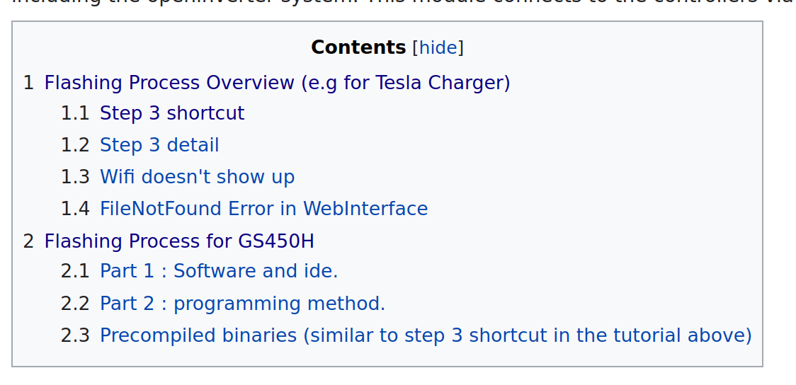

I took posts from arber, johu and others in this thread and put them in a wiki page. I hope it helps someone.
I also added a pre-compiled binary for the web-interface, so people should even be able to flash their Olimex without installing the arduino IDE.
Feel free to update the page and add to it.
https://openinverter.org/wiki/Olimex_MOD-WIFI-ESP8266

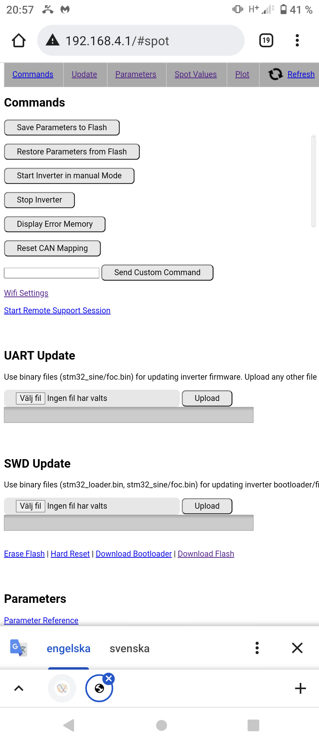

Hello all!
Update: I managed to get my ESP work.
It wasn't a problem with the ESP but with my cellphone...
After hours of different flashing trials and without any connection to my cellphone, I finally tried to connect with my laptop.
Result: Tadah! Site was loaded and after connecting to my inverter board also the gauges and the logging worked.
I havent't tried the update function yet, but I'm very confident, that also these will work.
Conclusion: In the end, it wasn't so difficult to get the ESP programmed.
And I can confirm, that ESP-01 or ESP-01S have enough memory for the code (was doubted before).
What is still open: I do not know, why the site isn't loaded with my cellphone.
Has someone an idea? What IP-address should the connection have and what the gateway? (192.168.4.10 and 192.168.4.1 didn't work)
And second: How can I dump the complete memory of the ESP module with Arduino IDE?
CU, Fabian.
