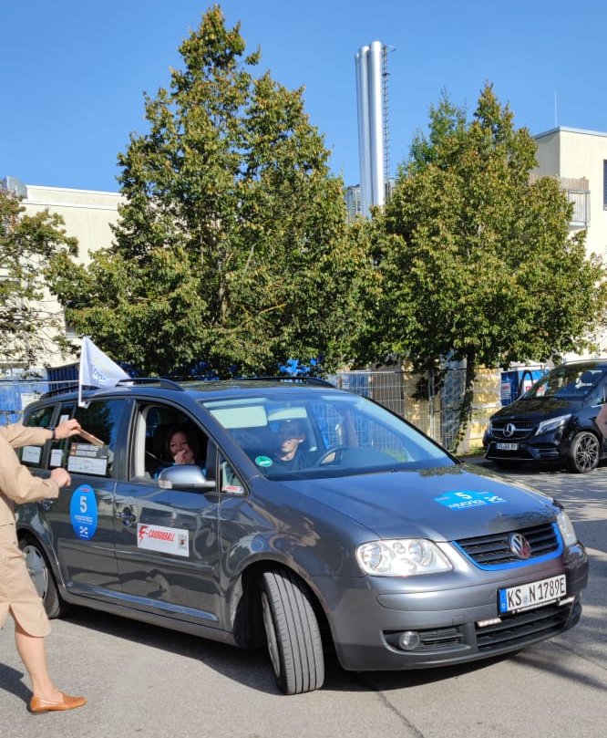

I'm back home from e-cannonball and it was a great experience!
We (Kerstin and Marc who I met only 2 weeks before) drove 360 km from Kassel to Berlin with 2 charge stops. First one was a bit cringy because only days before I had changed the CHAdeMO detection logic. Basically the VCU measures the proximity signal that is should be shorted to GND. But it turns out on some chargers it's not. Alright, so compiled a software with the old detection (detect that inverter is off) and off we charged.
We figured that we shouldn't drain the battery below like 30% because the low voltage results in higher currents both when driving and charging - resulting in higher temperature - resulting in derating. Plus there is more margin for error if a charger is not working.
On Friday the car spawned quite some interest at the exhibition. On Saturday we had to get up at 5:30 because we had to drive to the start first and then start at 7. I was super tired and was glad I didn't have to drive the first stint. The trip to Munich was absolutely perfect except driving against head wind all of the time. So consumption was a bit high (169 Wh/km). We charged 5 times but 4 times would have been sufficient. All chargers worked and we always arrived at a free charger and then minutes later cars queued up behind us :)
Kerstin in Marc were really delighted with the "battery cooling" (aka being lax about battery packaging). Apparently in the actual Leaf once you have heated up the battery it takes almost a day to cool down. We lost a good 15-20°C in rather warm weather between the charge stops and never bumped into temp derating. The battery bricks are located in the air stream of the former exhaust tunnel and are only sealed off to the outside world with thin sheets of foamed plastic.
After 7 hours of driving and 2 hours of charging we reached Munich after 570 km. I was delighted to see that "muehlpower" had made his way from Fürstenfeldbrück (20 km away) and we had a good chat (and thanks for the burger :) ).
We didn't win any sort of price, not sure why.

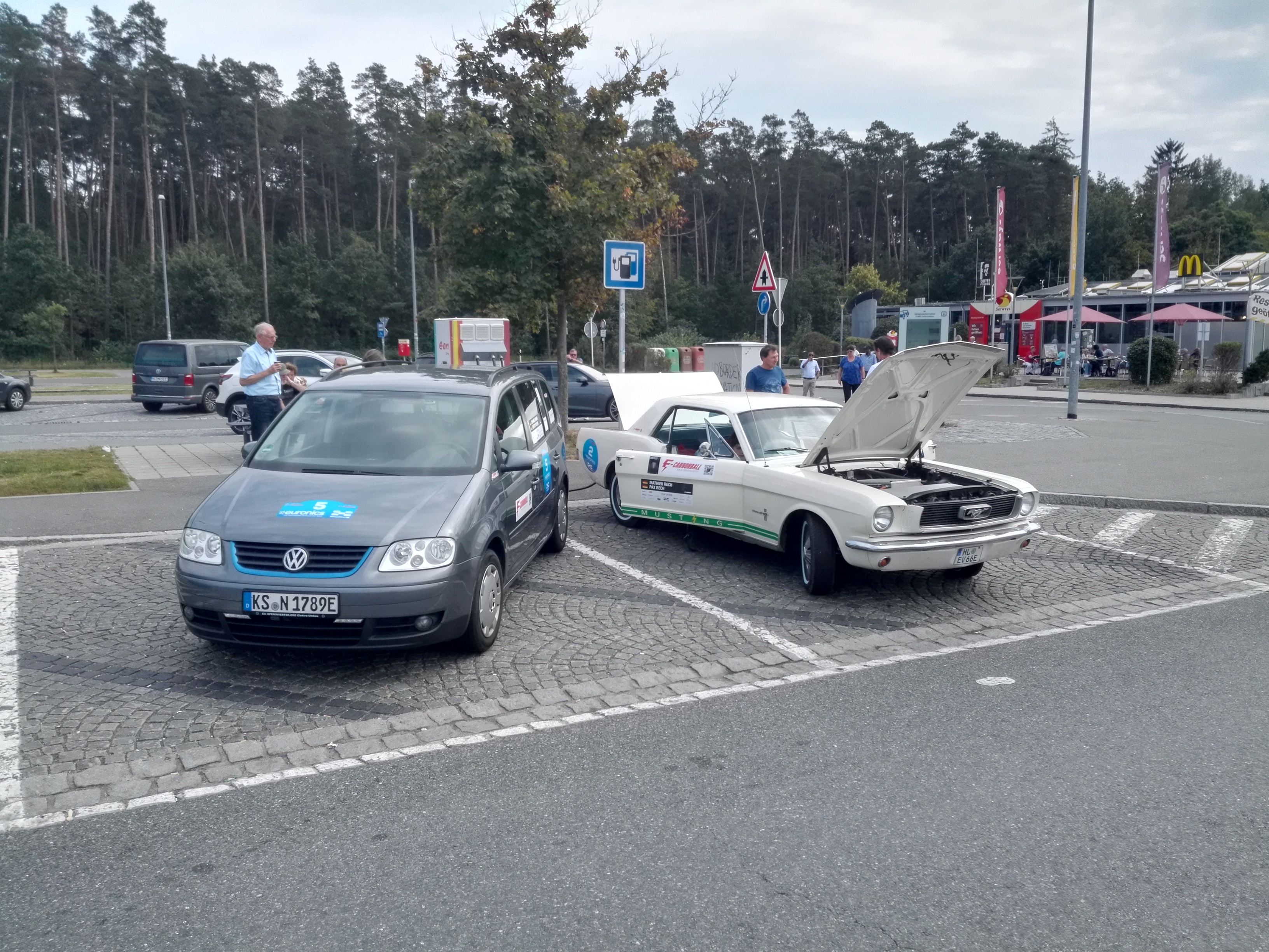

Finally yesterday we drove back home to Kassel which was another 500 km. That time it went semi-good. We actually met Mathieu with his Mustang at the first charge stop. He was using the full 43 kW AC power of a triple charger and the charger didn't allow us to start a CHAdeMO session in parallel.
So we tried to continue to the next one but the road was closed to reach it. So we continued to another one which stopped charging at 60% and didn't want to restart. The CHAdeMO inlet was quite warm so I suspect some chargers don't like that. From then on everything went smooth, except Kerstin forgetting her phone at the last charge stop, adding another 20 km to the trip ;).
Up to the last charge stop we had achieved 145 Wh/km. From there to home (80 km) I really beat it up the Kassel hills with 140 kph which only raised consumption slightly to 155 Wh/km.
Over all we had a fun time being surrounded by EV enthusiasts for 3 days. Kerstin and Marc were both entertaining and skilled, so great team members.
I was also delighted with Touran performance because it didn't cause headaches and compared rather well to production EVs.
EDIT: we encountered another 100 kW CHAdeMO charger. I could have let it charge at 70 kW but since Nissans relays are rated 150A for 2 minutes I limited to 150A and later to 130A. Still we saw a 56 kW peak :)
