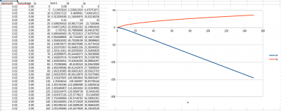

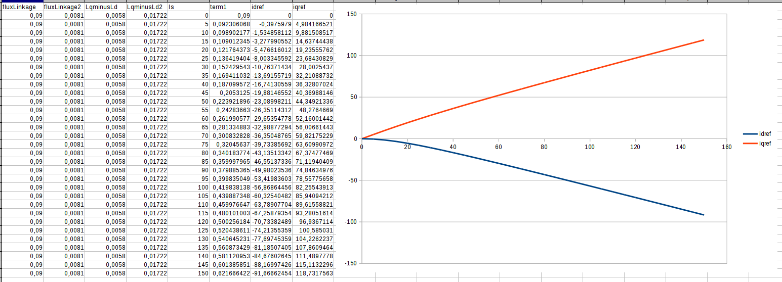

I'm playing with the MTPA calculation in LibreOffice and it looks like you can make a 10x adjustment and it only makes a 2x difference in output. So going really wild with these will make sense. Something along the lines of 10x IqminusId or 0.1x fluxLinkage will definitely cause more Id than Iq. But 2x or 0.5x respectively might have no discernable effect.
mtpa1.ods- (25.72 KiB) Downloaded 288 times

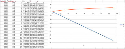

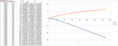

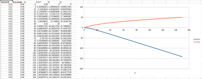

So testing something like this might be a good idea.
1) Start with setting lqminusldSquaredBs10 = 0.03445.
2) Test with FluxLinkage = 0.01.
3) FluxLinkade back to stock (0.09) and set lqminusld = 0.02 and lqminusldSquaredBs10 = 0.4096.
Any other ideas?
Any other ideas?

I get different result when I tested in LibreOffice. I get increased Id and decreased Iq, which is what one would want, right?celeron55 wrote: ↑Sun Jun 13, 2021 9:08 am Why isn't lqminusldSquaredBs10 = lqminusld^2? It seems to be the value of lqminusld^2 / 2, i.e. half the correct value. My calculator is telling me lqminusldSquaredBs10 should be 0.03445, not 0.01722. 10-bit left shift equals multiplying by 1024, right?
Making that change will cause slightly less Id and slightly more Iq, so it obviously isn't a solution to this problem though.

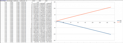

I think I agree with johu, Id should not be larger than Iq. That makes no sens.
Found this
https://se.mathworks.com/help/mcb/ref/m ... rence.html
When looking under Interior PMSM the equation is close but does the openinverter not use any of the FW stuff? Might perhaps explain why it is hard to get torque under FW.
Found this

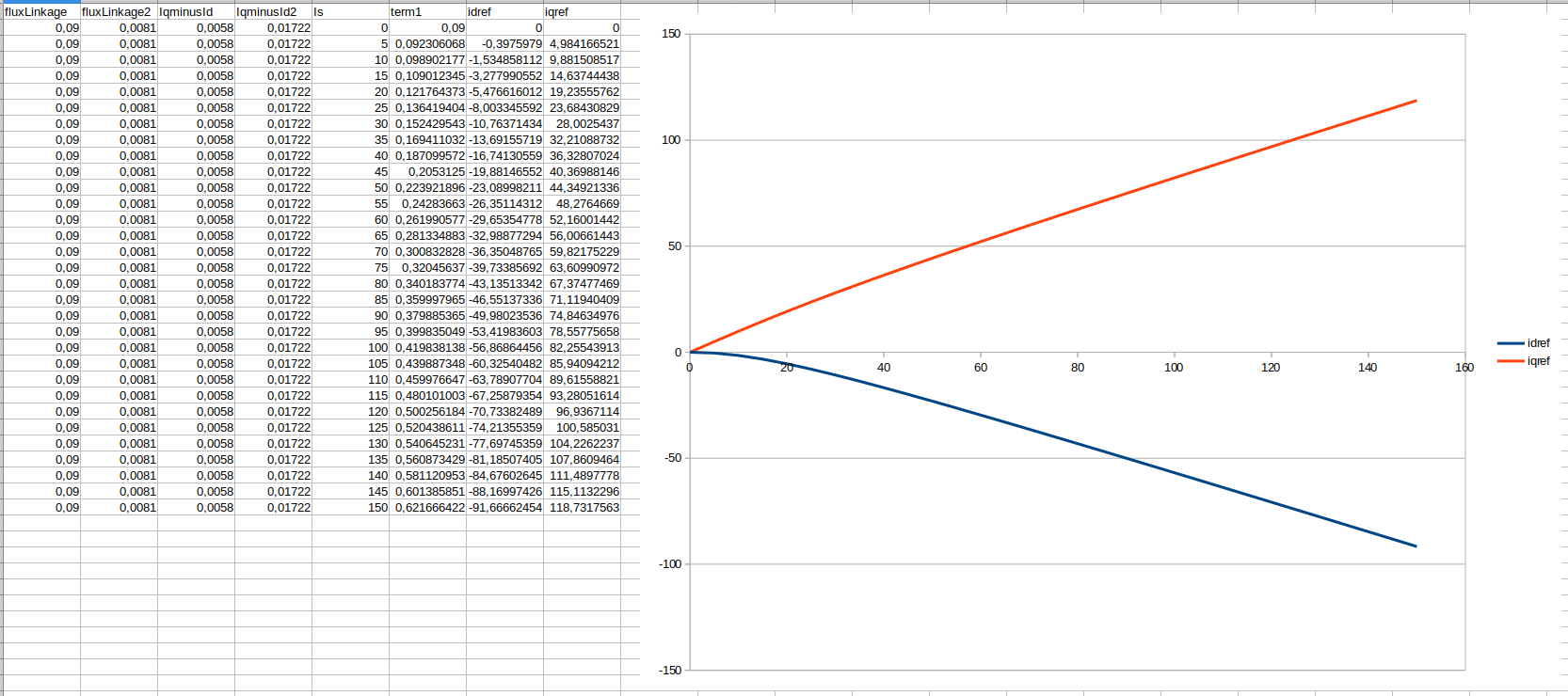

The equation presented by johu is equal to the one I found and linked to in my above post.
Anyway, results There are differences so I guess the SW can be adjusted.
Looking at the plot according to the equation, Id is always lower than Iq but compared to SW Id is increased.
EDIT: attached the spredsheet

I found these in a paper about the Prius motor. Since the outcome of MTPA only varies slightly with changing inductance and fluxLinkage I decided to hard-code them.
I will fix the equation now and post software here.
To me it looks like it is running out of voltage. The 5.05.R and upwards have a spot value "ifw" that outputs the request of the FW controller.celeron55 wrote: ↑Fri Jun 18, 2021 7:31 am Can it be explained in this case why the FW controller isn't increasing Id when the motor isn't accepting enough current? Is it hitting a configurable limit? If so, what does one need to change to allow it to go much higher than it currently does? Is the only limit the "50% of throtcur" and is the limit actually working as intended? Can the internal status of the controller be graphed?
- Been thanked: 1914 times
Re: Halved current during field weakening
This software has the correct formula.
//factor of 8 has been incorporated into the right shift (7 instead of 10)
s32fp term1 = fpsqrt(fluxLinkage2 + ((lqminusldSquaredBs10 * isSquared) >> 7));
idref = FP_TOINT(FP_DIV(fluxLinkage - term1, 4 * lqminusld));
- stm32_foc.bin
