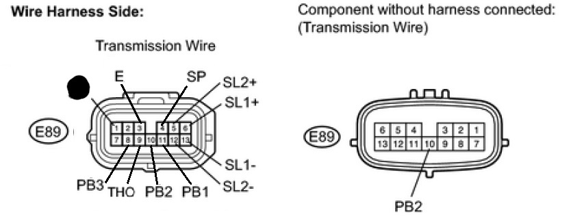

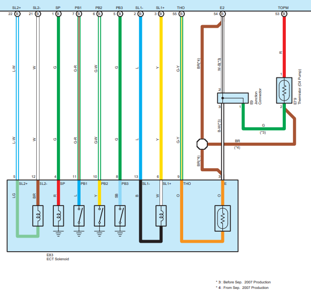

Perhaps I can help there. Do we have documentation for the solenoids and how to actuate them for each gear? The torque mapping shouldn’t be too difficult, just need to kill mg2 torque during the shifting window.
- Posts: 436
- Location: UK
- Been thanked: 13 times
It should be covered in this document: https://www.osti.gov/servlets/purl/947393
This is the same transmission as the GD450h, except this has a transfer case attached, and uses a different inverter.
Check out page 47.
I believe the SP solenoid is controlled via PWM to adjust line pressure. SL1 and SL2 control the clutches within the ravigneaux gearset. PB1,2,3 are feedbacks from various places, likely feedback to show clutch position, etc.
The system will likely need oil pressure to function, but once this is set up, it should be simple to run through the four SL combinations to see which ratios are available. The default is 1 : 1.9 (high), a low gear at 1 : 3.9 is available.
Check out page 47.

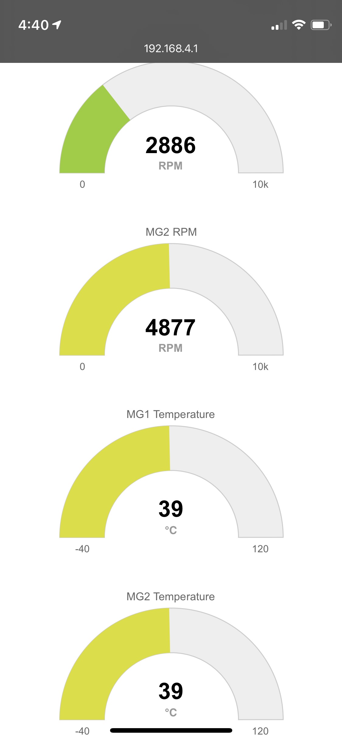

Can you make video to help illustrate what is occurring when this "surging" as you called it happens.
Btw, What inverter model number are you using?

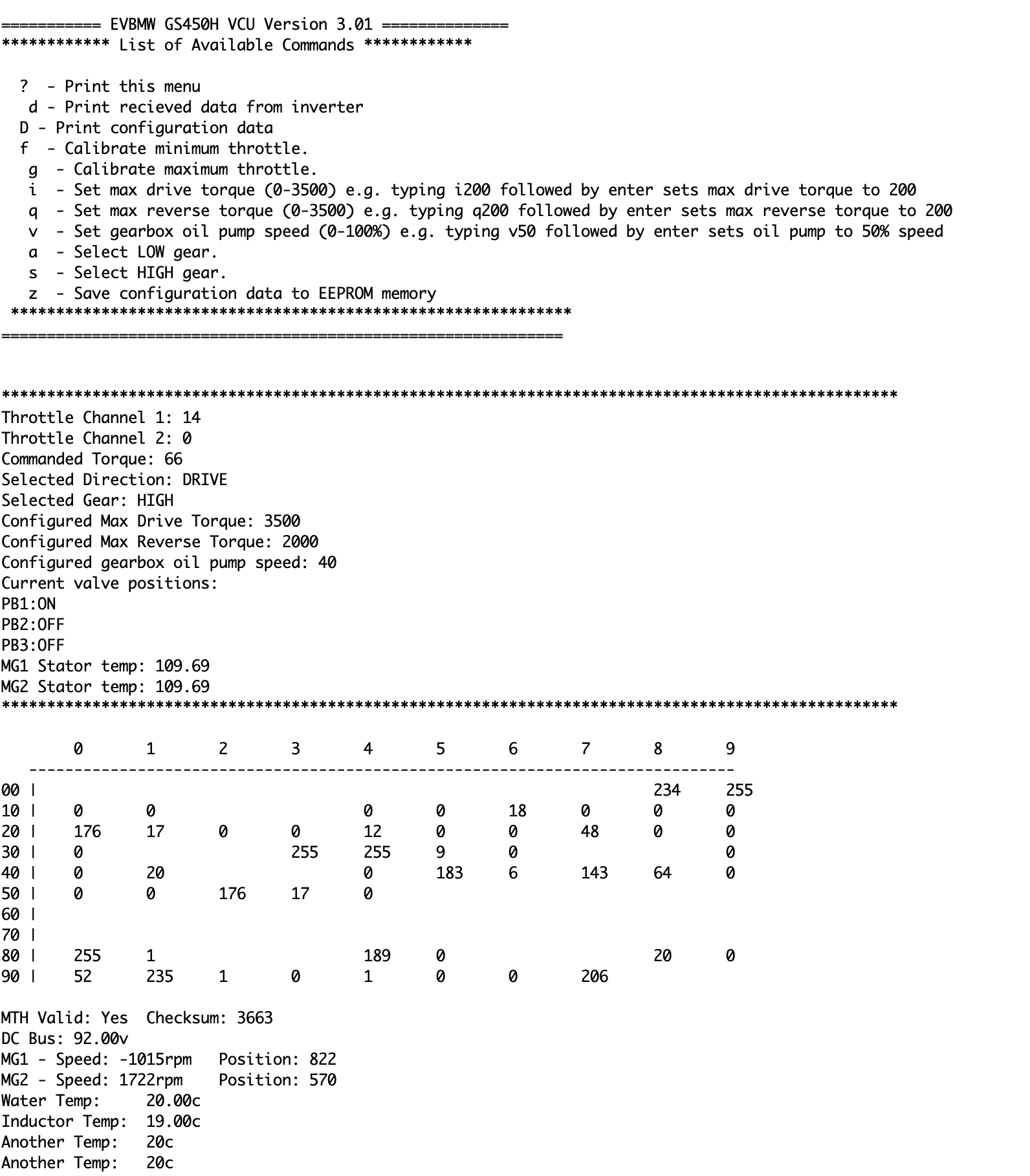

By the numbers, it looks like I'm in low gear. Damien's videos show similar MG1 and MG2 speeds, slightly lower for MG2 than MG1. Perhaps that is related? It definitely caught me by surprise when the car laid down rubber from a stop!
Now how the hell do I get it into high gear is the question..

High gear is default mode without any solenoids energized.

Hm, maybe I'll just temporarily disconnect the pins, as I'm started up in the default LOW state for each solenoid. Is this what yours looks like when it's powered up?

I have my own custom version so we cannot directly compare results.
However, at some point I did play with switching gears. I was able to switch between Low and High without any problems by energizing appropriate solenoids at stand still. I did some test switching gears while driving and while it was possible I learned it is very tricky to do it in smooth fashion while driving. I have abandoned this for now because High is really way to go unless you really need to make some tire smoke.
So, as I mentioned, without any solenoids engaged, my transmission is always in High.
I looked at the code I think you are running and it looks like that shifting is not implemented and all solenoids are off in both Low and High. Therefore you should be in High mode. I am little puzzled why not.
One interesting thing I see in your screenshot is PB1:ON, I do not remember what it indicates and unfortunately I cannot check at the moment what it is in my setup.
As far as RPM goes, in my setup I would be reaching 10000 RPMs around 60 MPH in Low and in High I can get up to around 130 MPH. Your results will differ but probably not by much.

Yep, same here. 60mph max speed in low and it’s a little noisy. Would you mind sending me your code so I can see which solenoid combinations you’re energizing to shift gears? That might shed some light for me.
Edit: looks like in Damien’s videos all PB1,2,3 are ON. Odd

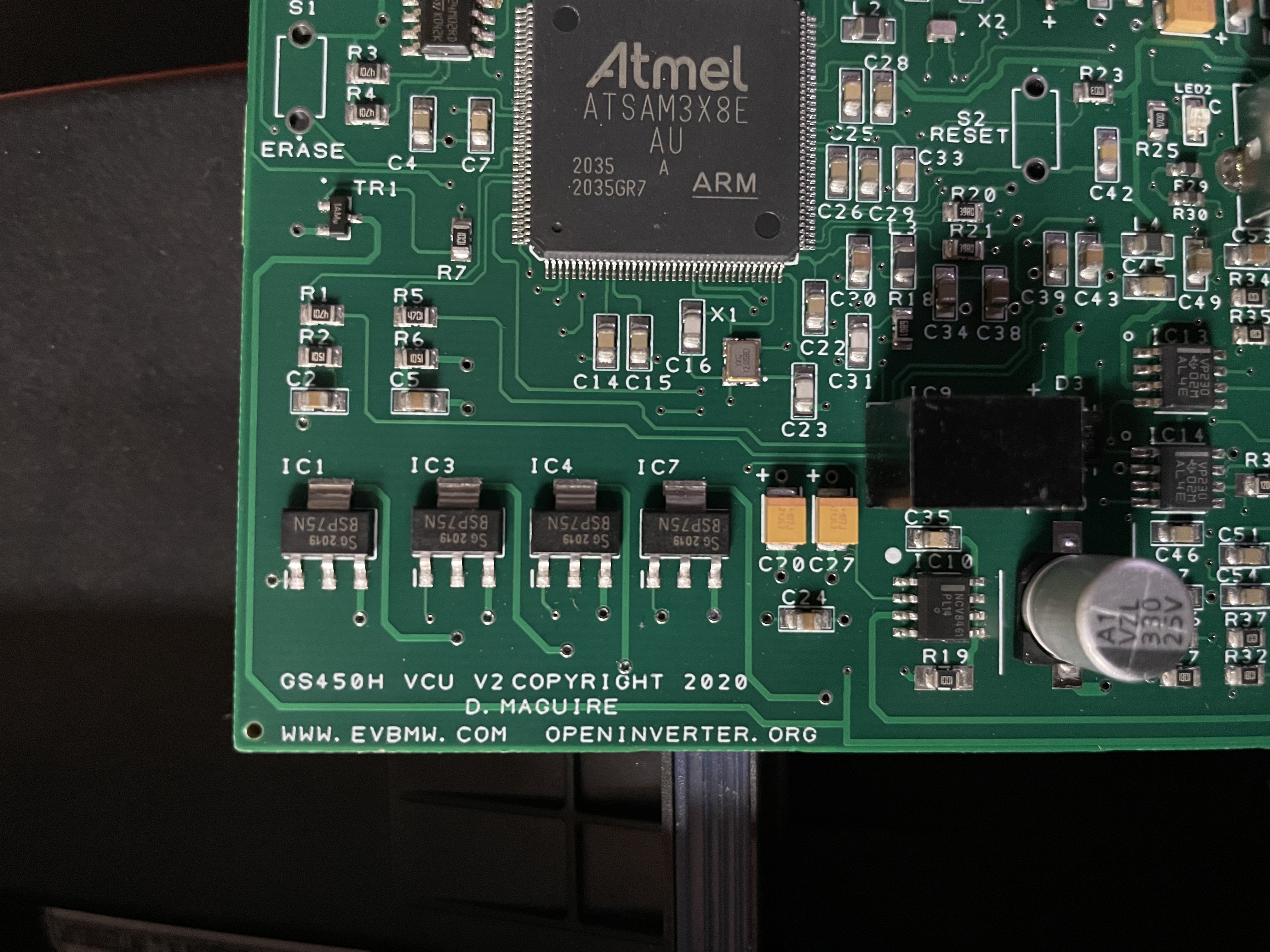

Well it looks like I may have a hardware or software bug - both pins were being held to ground regardless of the state in software. I pulled the pins from the VCU and we’re now running in high gear B).
Would either of you mind sending your pin assignments for SL1 and SL2? I’m trying to rule out software and hardware simultaneously. Hope you’re well.
edit: Looks like hardware failure, which seems odd. Both gate voltages were at ground level and the mosfets were still on. I've ordered these as replacements: https://www.mouser.com/ProductDetail/ON ... BRjw%3D%3D

Here is pinout:
Here is pinout:

Hey Damien, others,
You might want to check the whole batch of VCUs as it appears the wrong part was installed in locations IC1,3,4,7 on my board. The BSP75N installed components are internally shorted across the ground/source pin and tab by design instead of the drain pin. This led my controller to command the gearbox to always be in low gear, and for out1 and oil pump power to be always on. I’ll be replacing those on the board with the correct part numbers this weekend.
Is: BSP75N https://www.mouser.com/datasheet/2/196/ ... 225579.pdf Should be: NCV8402ASTT1G (per V2 excel BOM) https://www.mouser.com/ProductDetail/ON ... BRjw%3D%3D
