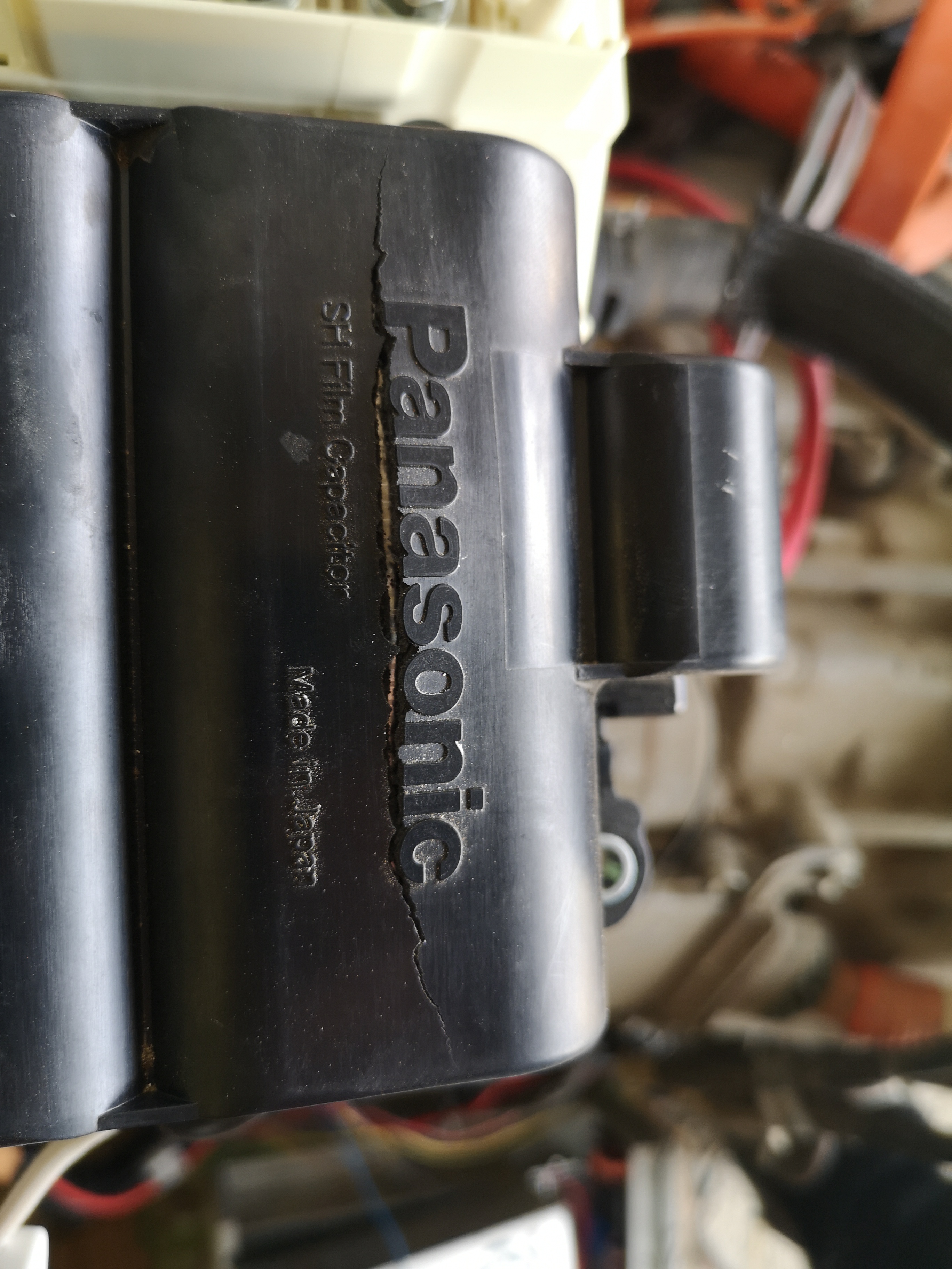

After only half an hour I wanted to measure again the temperature of the main capacitor and I observed that this had a crack which was not there before starting the test.
Now the temp of the cap was well above 90 degrees Celsius.
After this I immediately stopped the Inverter and waited for the capacitor to cool down.

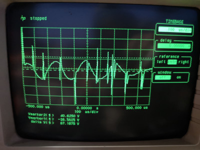

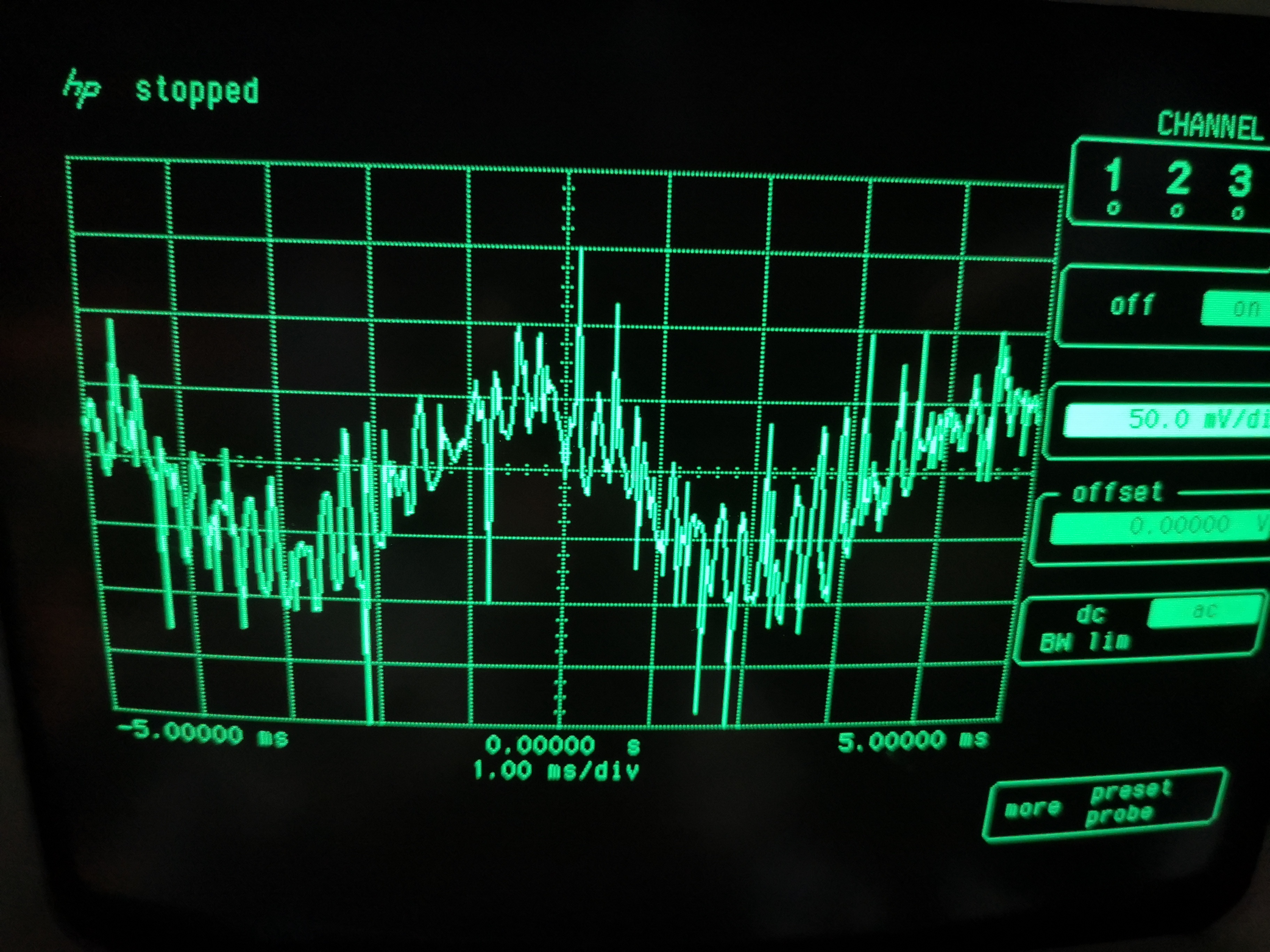

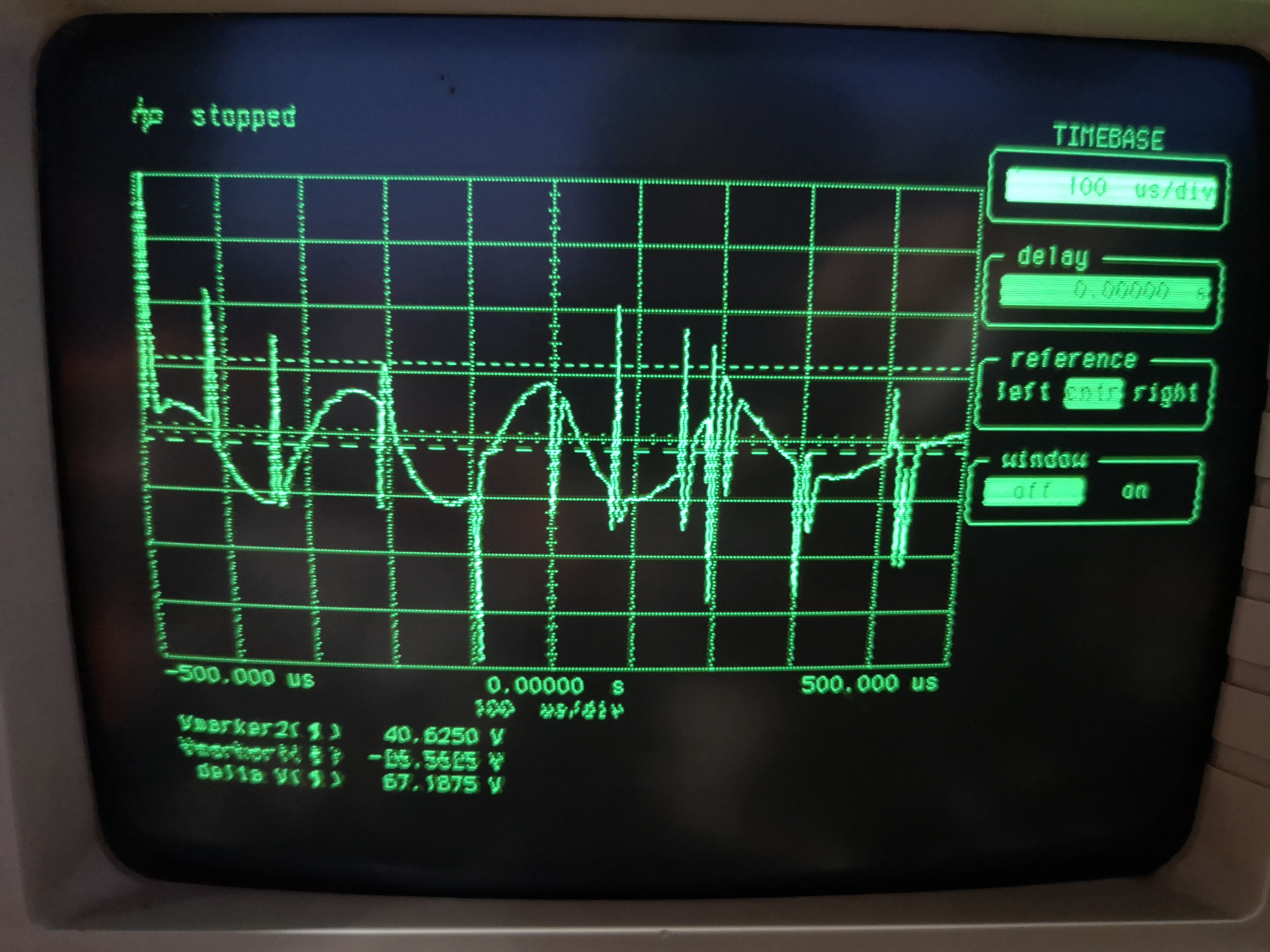

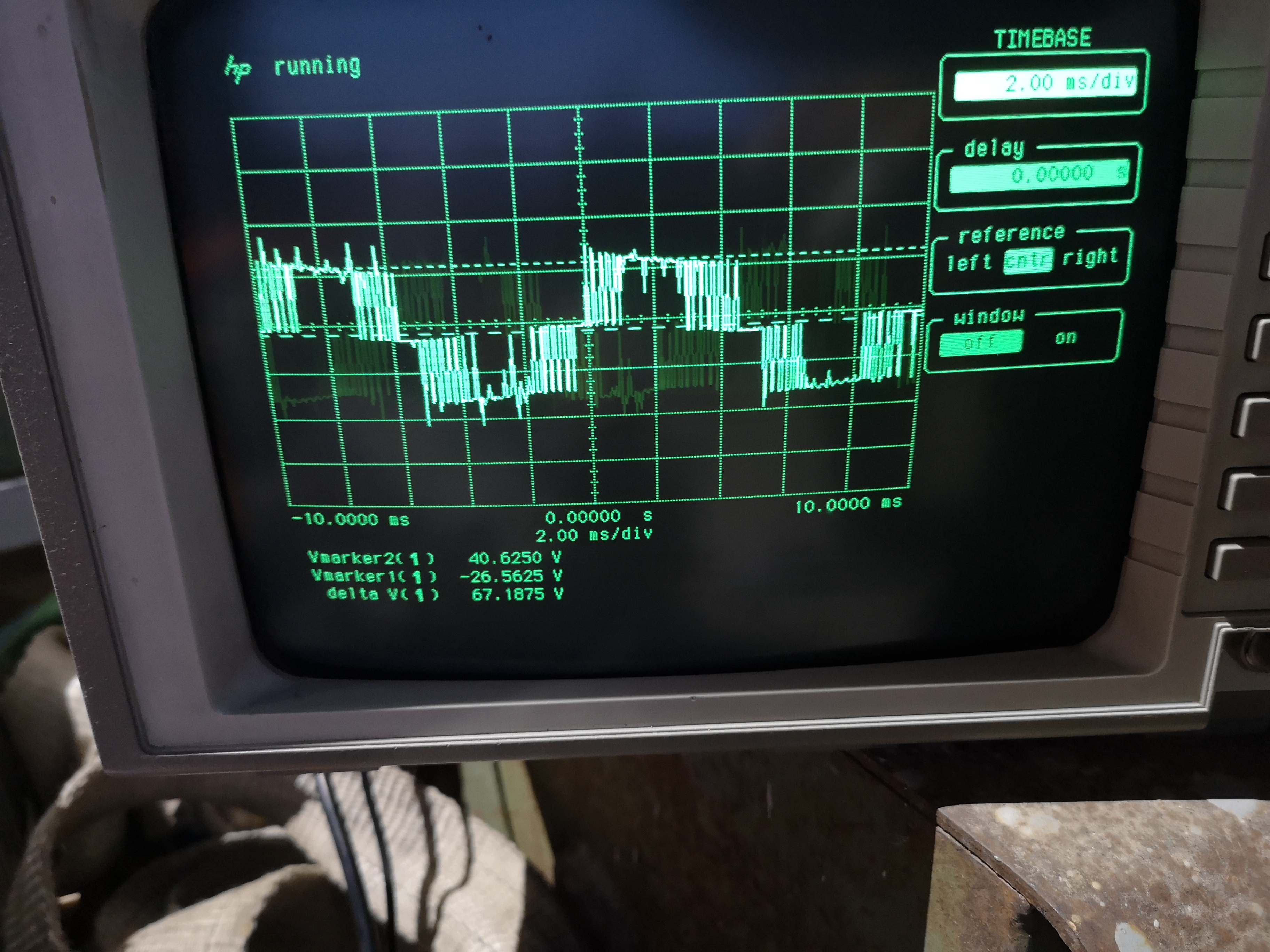

Meanwhile I managed to make some measurements of the DC current, motor phase current and motor line voltage with my oscilloscope.
The waveform of the DC current absorbed by the inverter
The waveform of the motor phase current which resembles a Sine wave (somehow)
The waveform of the motor line voltage Now I have some personal observations regarding the Prius Gen.3 inverter:

- I am not sure why the main Cap is behaving like that when I run the inverter continuously at a not so great 72V and at a very negligible 45A on the DC buss bar directly connected to the main DC CAP.
Maybe someone with more knowledge can provide me some answers.

I think most EV components are not rated for continuous load. For example the main DC rail in a solar inverter is like 100x20 mm and it will happily conduct 1000A all day. The DC rail of a Tesla inverter is like 20x3 mm and it will only conduct 1000A for limited time.Drw91 wrote: ↑Wed May 12, 2021 4:32 pm Now I have some personal observations regarding the Prius Gen.3 inverter:
- The buss bars for the MG1 and MG2 are way to thin to support the maximum rated current (especially for the MG2).
In my video at 0:58 it is very clear that the buss bar temp is almost 100 degrees C at a 172A RMS phase current. I really don't want to thing about pulling 600A RMS from the MG2...
Now running the motor at 3000 rpm and 70V will need quite some field weakening current which puts additional load on the inverter and a unfavourable power factor, i.e. energy swings back and forth between motor and bus cap.

I am not sure if my Cap can be used as it is. The value is the same as it was before. Now I also need to check the little cap that in your case popped.

Regarding the capacitor problem, now I know what I did wrong, thanks to Damien.
